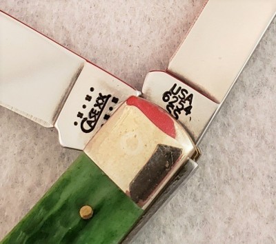

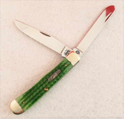

On the green one I just cannot figure out the exact name of the bone. it is the same handles and color as the 2002 greenbone John Deere trapper but is has the casexx shield. Also want to figure out the exact year this was made. The handles are the same exact as these https://www.allaboutpocketknives.com/ca ... pper-knife

Two very nice 54 Trappers.
Green Corncob Jigged Bone 6254 shows a date of 2000.
