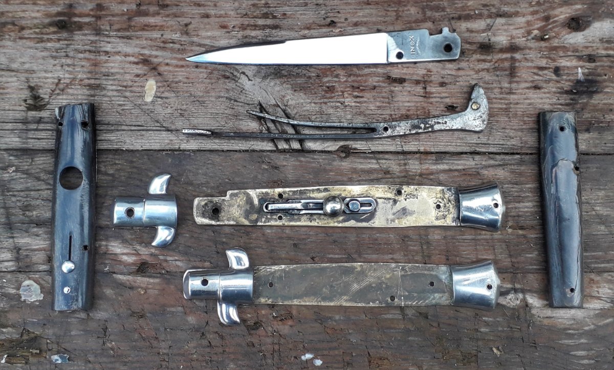

Well thats it broken down , im going to put Stag scsles on it ::tu:: will need a good clean and possibly ill need to make a new button side liner as the pin hole has worn so the blade doesnt close all the way in ::tu::

zed6309 wrote: Mon May 17, 2021 1:35 pm Well thats it broken down , im going to put Stag scsles on it ::tu:: will need a good clean and possibly ill need to make a new button side liner as the pin hole has worn so the blade doesnt close all the way in ::tu:: 20210517_092514-01.jpeg
This will be a great project Paul. If the blade is peeking you definitely should build a new liner, cuz the peeking will bother you to no end if you don't correct it. This is just a suggestion and haven't tried it myself, but, I'm wondering if you could put a drop of solder in the existing catch-hole and then drill a new hole into the solder. I know this has been done for pivot holes, but don't know if it would work for the catch hole. As I said, just a suggestion. Your knife will look teriffic with stag covers too! 8)

Cheers Marco ::tu:: i was thinking about doing something with the hole but might be easier making a new liner ? Although ive never done that before , this is my first switchblade restoration, so fingers crossed ::tu::

I'm sure you'll do fine Paul. I can't honestly say if building a new liner would be easier, I guess it's something you'll need to decide. I would suggest you do whichever method you're most comfortable with. If I can offer any assistance along the way, please just let me know, and I'll try to help if I can. 8)

Big thanks to JJ for the message anout sorting out the hole on the liner ::tu:: i did a bit more today , outer cover was fun lol , im happy with how they look ::tu::

zed6309 wrote: Tue May 18, 2021 2:42 pm Big thanks to JJ for the message anout sorting out the hole on the liner ::tu:: i did a bit more today , outer cover was fun lol , im happy with how they look ::tu:: 20210518_150314-01.jpeg
It's coming along nicely Paul. Your choice of covers is spectacular, that's some gnarly lookin' stag. Would you mind sharing JJ's method for repairing the catch-hole for future reference? Thx! 8)

Cheers Marco and this is what JJ said to do ::tu::
i typically repair "blade peek" on Italian knives fairly easily by simply "moving " the worn liner metal back into place

I think basically buy tapping the bit thats pushed upen back into place to make the hole it's original size ::tu::
