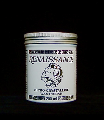

Vikingfisher, welcome to AAPK and that's a nice collection of Schrades you have there. I use Renaissance Wax on all of my knives and have never had a problem with rust. There are other products you can use, but I've had good luck with Ren Wax.

Whats best? Well I like Rolls and every 3 months wipe them down, oil and play with them.
Things that are bad for knives
Heat
Sun
Humidity
and cel knives stored to close to other knives. celuioid <---man my spelling is bad
Leather and all materials have some acid in them but I feel as long as their in a comfortable inviorment (a place you would never break a sweat in) and place in or on a soft material your good.
Fixed blade store them not in their sheaths.
ow I use Ren Wax also but IMO have seen it effect some ink etchings on blades just a warning.

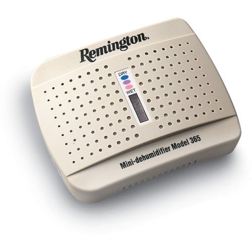

vikingfisher WELCOME to AAPK.
I to wish that in one of the tabs above we could place a list of ways to preserve a knife. There are many ways.
This is what I do to my Schrades.
First I tape up (with Scotch tape) any lettering that is not stamped. Like EVER SHARP on a blade.
2nd I spray them with WD-40 mainly in where the blades rest.
Then blow that out with air from my air compressor. Whip with clean rag.
3rd I clean up handles, bolsters and back springs with FLITZ polish. Using a clean old T-shirt.
4th I take off tape from blade and with Ren-Wax and a CLEAN rag rub all parts of your Schrade and let the Ren-Wax dry. Yes even where the blades rest I use some times a Q-tip on the brass liners.
5th I use a clean rag to rub off the dried Ren-Wax.
6th I use a drop of TUF-GLIDE OIL on the JOINT ONLY.
I place them back in the wrapper and box they came in. I do not let the sheath touch the knife if one comes with it.
Place then in your safe with a Remington® Model 365 Mini-Dehumidifier
I hope this helps you. Sorry the here of the LB8.

I do almost what you do but I love to look at my knive too much. Rolls give me good access to them. the boxes are stored with some dehumidfiers also
