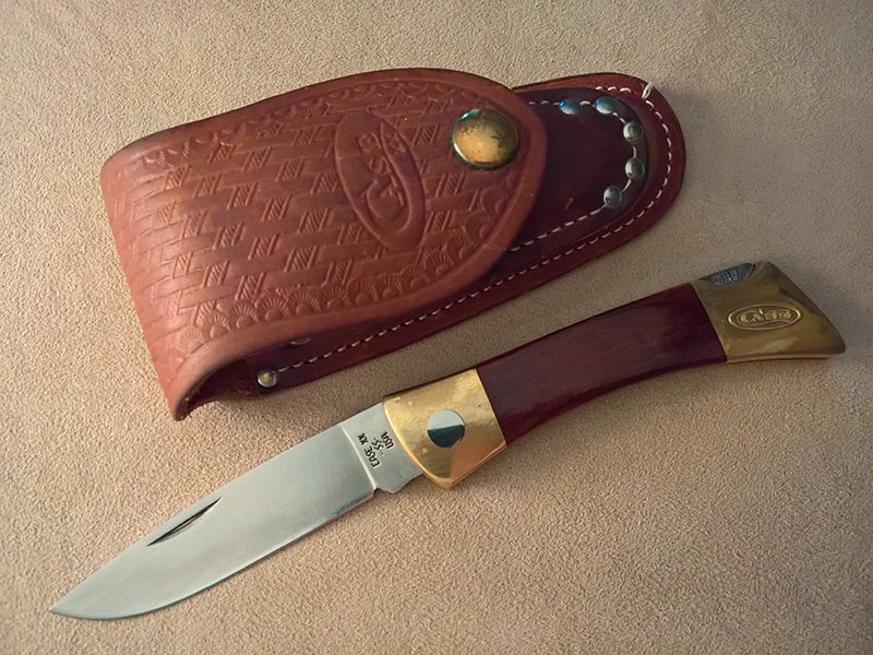

I recently acquired this Case Changer. It's from 1987 and only came with the one blade and sheath. I was never familiar with this model but really like the design and balance of the knife. I wanted to add a set of other blades but was told that Case retooled after 1990 and the modern Changer blades will not work with mine. Is this correct? Does anyone have an older and newer Changer they can test blades with? Am I stuck with trying to find vintage blades? Any help is appreciated, thanks.

Thanks guys. I called Case customer support and spoke with a woman there who confirmed that the newer Case Changer blades are not sized for the vintage ones. She mentioned that they did retool and had mine been made after 1989, they would fit. Also I was searching online and looking at pictures of newer Changer blades to compare to mine. It looks like that area where the blade pivot and lock notch are now have a slightly different shape. I guess I'm just going to have to keep it as is... or maybe by chance I'll come across someone selling parts.

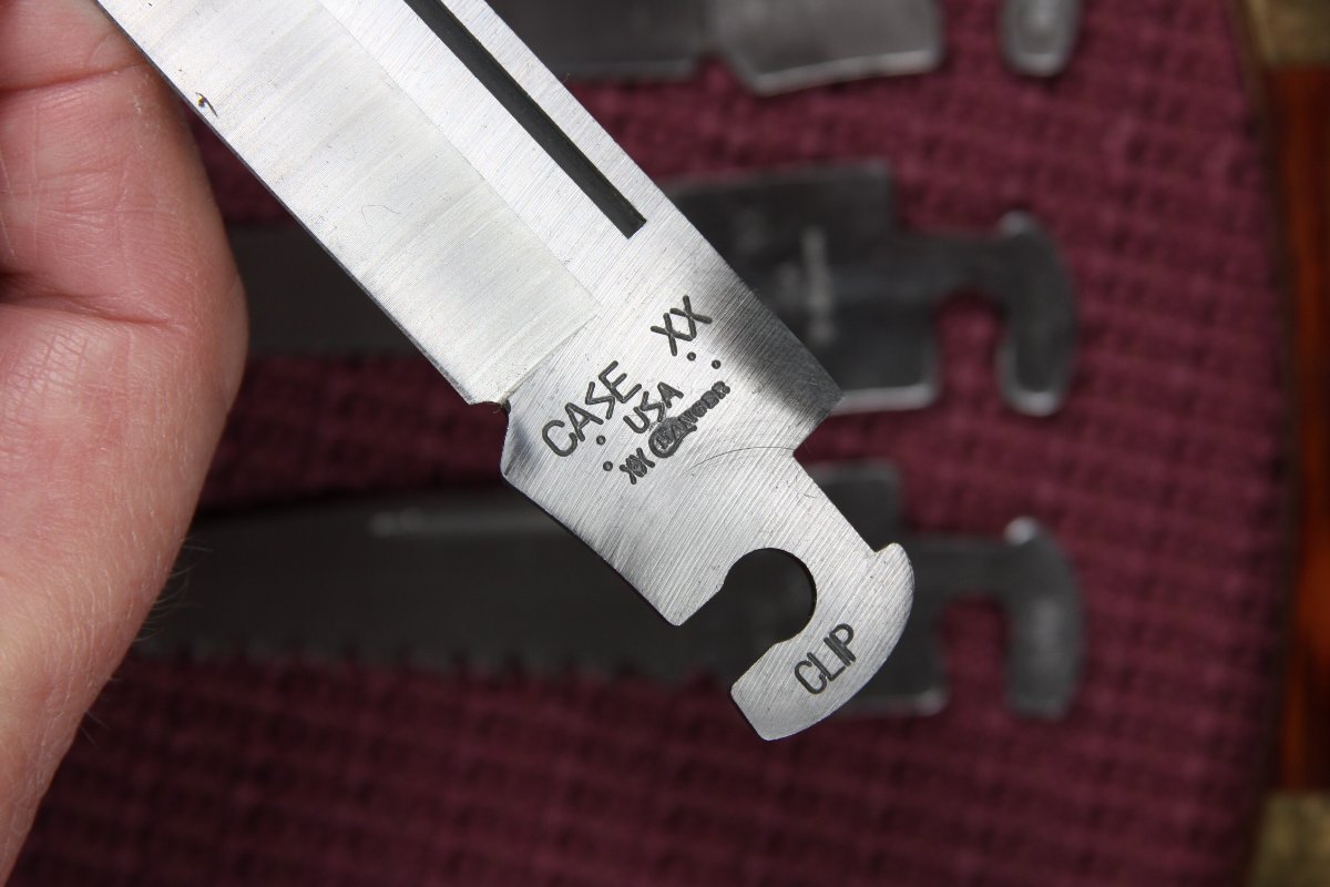

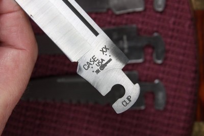

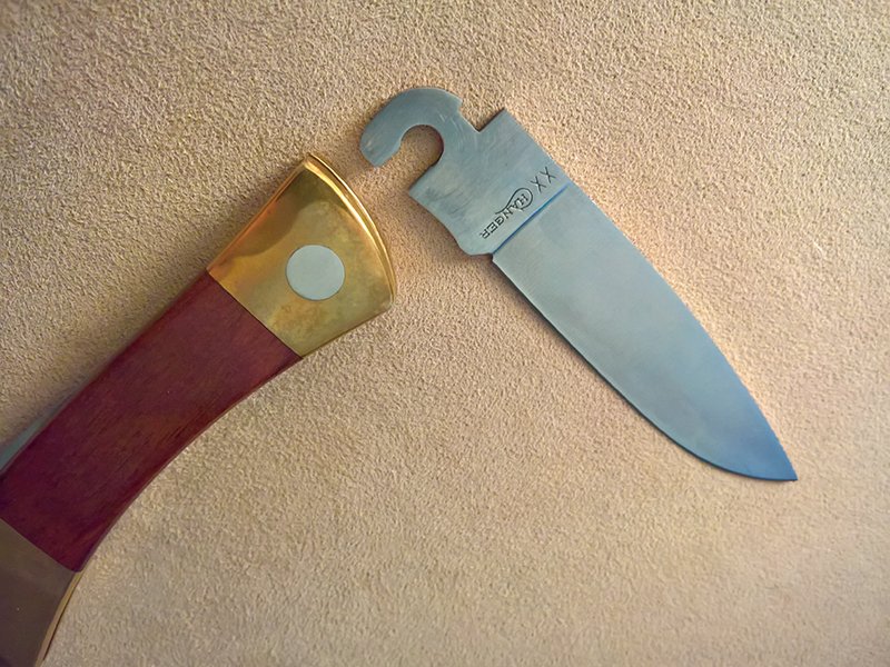

Some pics of my Case XXChanger. It appears that the area around the locking notch is shaped somewhat different than the one you pictured. Blade thickness on mine is .110". My 4 blades have date codes from 1995-96.
