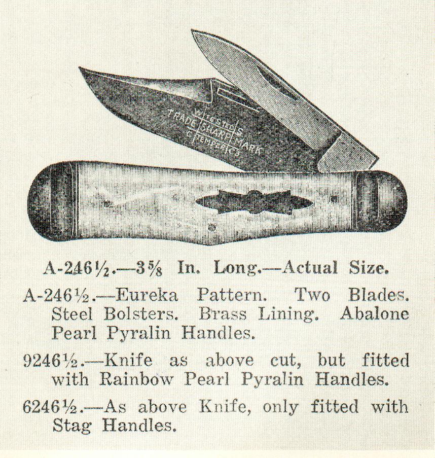

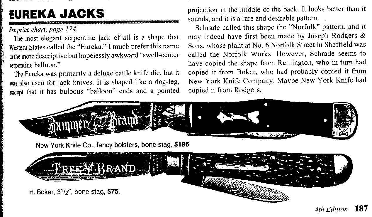

I am trying to find the earliest reference to the "Eureka" pattern name. There are so many of you collectors out there who have old catalogs, I was hoping you wouldn't mind seeing if you have the actual name in print, referring to a knife of that style!
Here's an extract from LG4, and a 1921 Catalog cut of a Western States, the earliest reference I can find for the name.

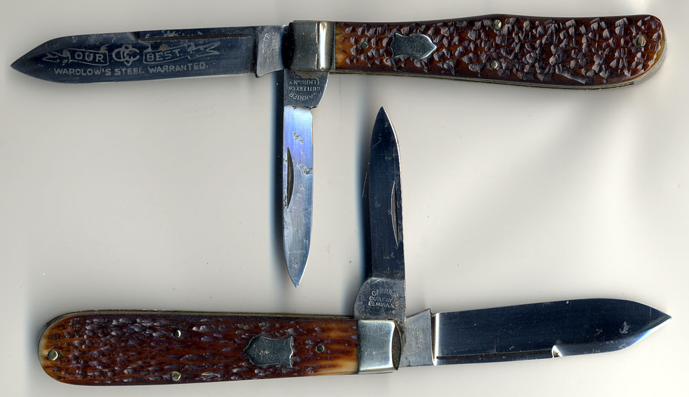

- galvanic1882
- Posts: 3532
- Joined: Tue Jun 28, 2005 10:39 am
- Location: Payson AZ
Re: Eureka Pattern Name
I checked all the old catalogs that I have copies of or the originals that I have and none call the knife a Eureka Pattern although there is one in an old Biddle hardware catalog dated 1908. I have attached a picture of the only one I own an etched Carrier Cutlery Eureka. It is not in the catalog that I have from Cronk & Carrier. I think it might be in and named in an old English Cutlery co like Rodgers?? Not sure but would like to know also.
Dayum Mike. You topped Charlie !
Gorgeous.

- galvanic1882
- Posts: 3532
Thanks Fran. What does Charlie have ????

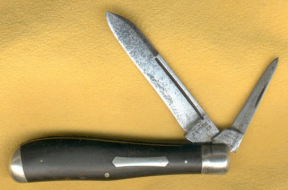

- upnorth
- Posts: 2959
- Joined: Sun Oct 15, 2006 8:43 pm
- Location: Vancouver, Canada
That was fast!! My friend in Winsted, CT sent me this old Eureka Jack! It was obviously in transit when I posted my pathetic complaint of Eurekalessness
It has seen a life (a long one) of usefulness, but retains its pattern. I have seen so many knives from the turn of the century era with Ebony handles, I want to date this knife back then, but it is hard to pin down, like most. Certainly it's a rare and old pattern. The complexity of the handle shape makes it labor-intensive to finish, so fewer were made than straighter-sided jacks.
What a pleasant surprise!

- jonet143
- Posts: 6922
- Joined: Fri Jun 23, 2006 3:33 am
- Location: w'ford-tejas
and.....it's an empire!
great knife. i read on bf that even mr. levine did not know the answer. well, more research is needed. that pattern certainly gave way to more easily made patterns. too bad.
johnnie f 1949
