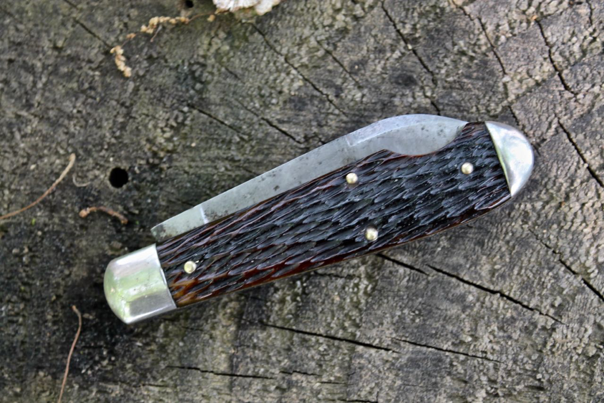

What Jerry stated, all I ever have had to do is rub some mineral oil in and polish with a micro fiber cloth, that will take care of most of them. For the real bad ones I put them in a pan of mineral oil and brush them with a soft toothbrush to get the dirt out and then wipe all the oil off and hand polish. I'm another one that avoids all mechanical means of cleaning vintage knives, too easy to wipe out the history of the knife that way.
This Schrade was one of the real dirty dull ones, mineral oil bath with toothbrush and hand polish with towel, Bone looks good now. I will also use Balistol which is mainly mineral oil with some solvents, seems to leave a shine.
