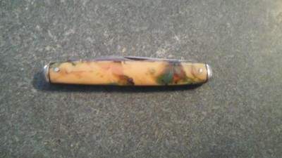

Is this a sign of gassing out
Post by Delmar Morgan »
I have a old Challenge pen knife , with celluloid handle. The back spring pin which is nickle silver is turning brown. When I got it last year it was that same color but worse , I cleaned but it is back. So is it starting to gas out.
LongBlade
Posts: 3417
Location: Woods of CT
Re: Is this a sign of gassing out
Post by LongBlade »
Sorry to say but looks to be outgassing to me... I would pull the handle covers ASAP as I think you gave no choice if you want to save the knife and then have it rehandled... Right now I would not leave it near any other knives as the sulfuric acid from outgassing will damage others nearby...

Delmar Morgan wrote:I have a old Challenge pen knife , with celluloid handle. The back spring pin which is nickle silver is turning brown. When I got it last year it was that same color but worse , I cleaned but it is back. So is it starting to gas out.20190308_094916.jpg
With the knife you have posted, I would immediately remove the handles. Hopefully the liners aren't so far gone that they have started to crack, but you won't know until you get the handles off. The crack is usually right at the pivot pin in the center of the knife. That is where the stress from the springs are transferred to the liners and that's usually where the stress cracks the weakened liner.
Once you have removed the handles, throw them away (do not burn them). Then put the entire knife in a solution of baking soda and water. Be generous with the baking soda, it is not expensive. Essentially you are creating a heavily alkaline solution and that is needed to neutralize the acid that is causing the destruction of the knife. I usually take an old toothbrush or something and brush the baking soda into the knife really well. Sometimes I even let them soak in the solution for a half an hour or more. The last step would be to remove the knife dry it, compressed air is what I use to dry them. If you don't have compressed air, I would probably use WD-40. It is made for water displacement, and not for lubrication. After the WD-40 has cut the water out of the joints and cracks in the knife, then I wiped the knife down to remove the WD-40 and then I wipe a lubricating oil onto the carbon steel surfaces. Then set the knife aside until you can replace the handles, or have them replaced.
NOTE: If you have a knife that has stainless steel blades, the blades should not be affected, but if the springs are carbon steel they can be weakened substantially and of course the brass and nickel silver is affected. I have a German knife with a stainless steel blade that was probably made in the 1970s, and the blade is fine as is the stainless steel spring. However, I will have to make new liners and probably knew bolsters because of the destructive power of the acid released by the celluloid.

Note in edit - just saw 2 posts after Dave - all good info and again like Dale notes I would pull the handles. Like Dave said you’ll find a lot of opinions on celluloid - personally I don’t take chances and though I only have a few they are open to the air without direct light (ie stable environment)... I’ve seen a few knives 100 years old that were fine and out of the blue started outgassing.. for lots of info there are multiple threads on AAPK discussing celluloid and a pretty good article that was published discussing the phenomenon of outgassing and celluloid handles - if you do a search you’ll find more than a few...

Delmar Morgan
Posts: 143
Joined: Sat Nov 26, 2016 12:32 am
Thanks guy's and gals for info . I thought it was , but wasn't for sure. Now l got to see what I can re handle it with.

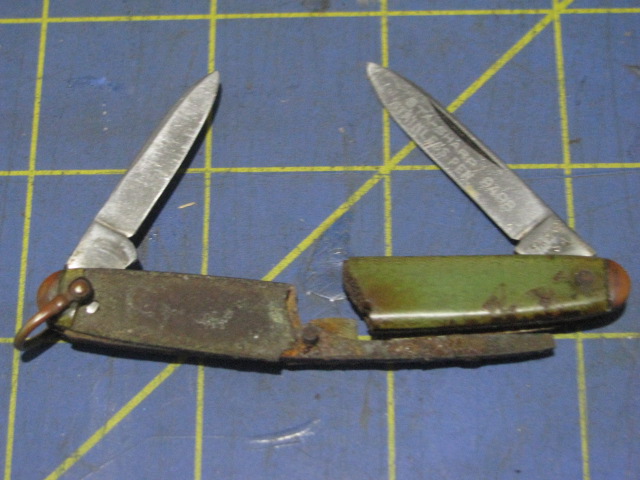

Post by knife7knut »
Dale mentioned that celluloid out-gassing will not affect stainless steel blades. Here is a perfect example of the:a Sta-Sharp9498 Stainless Pen knife that I keep in front of my computer to remind me every day about out-gassing celluloid knives.
