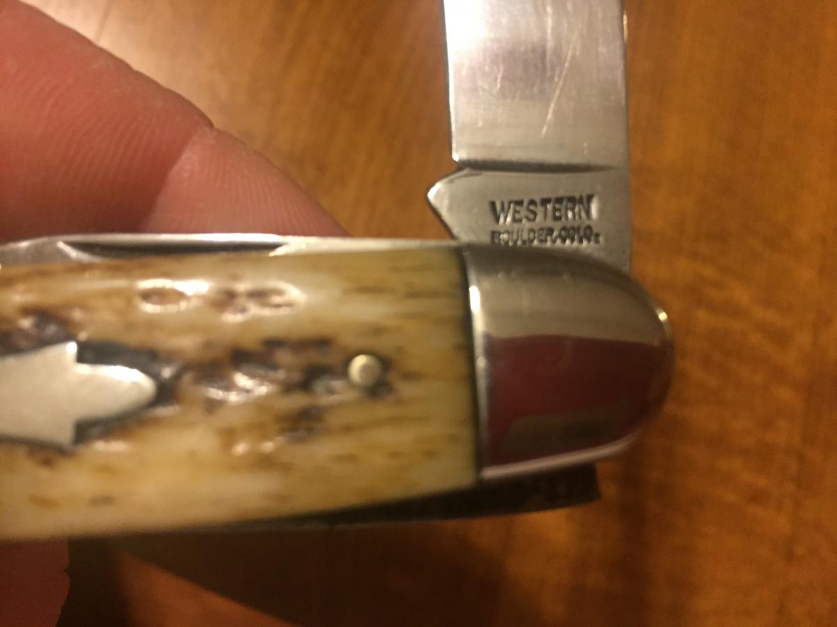

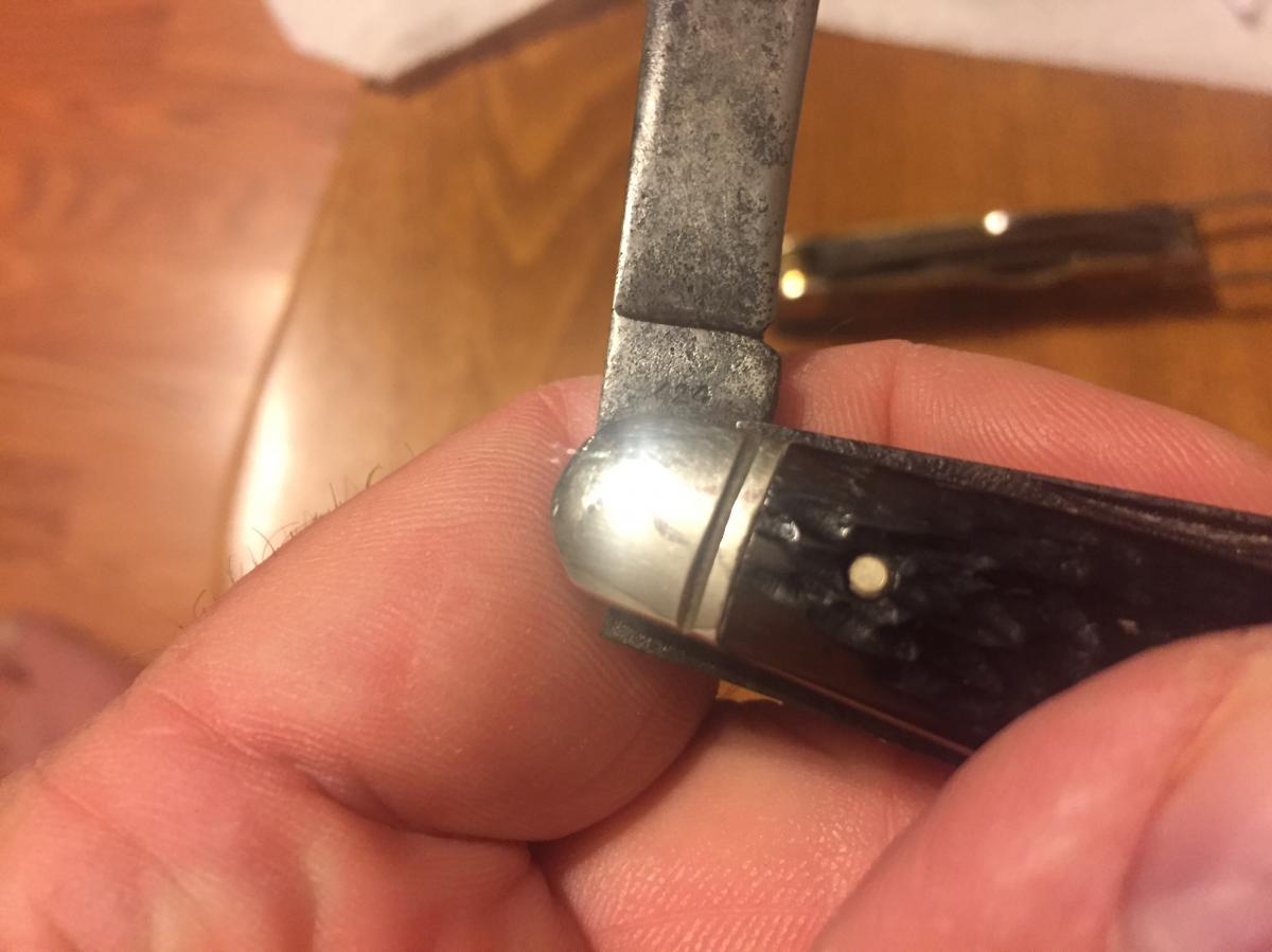

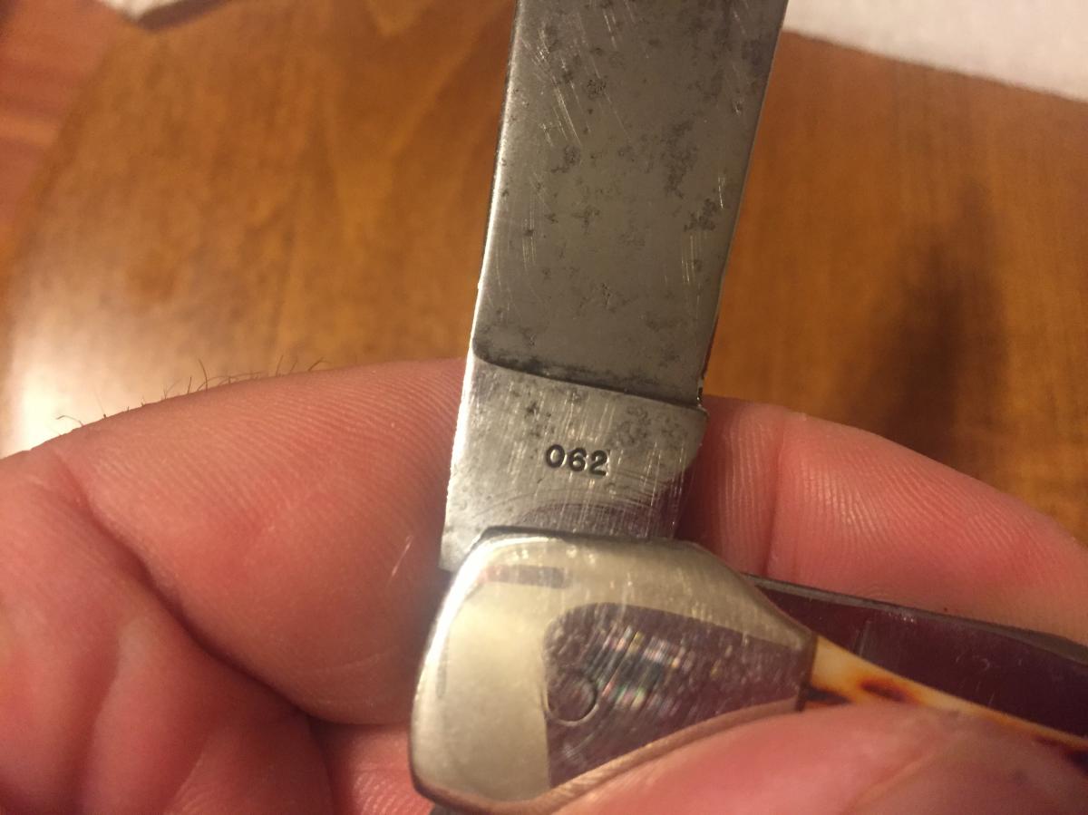

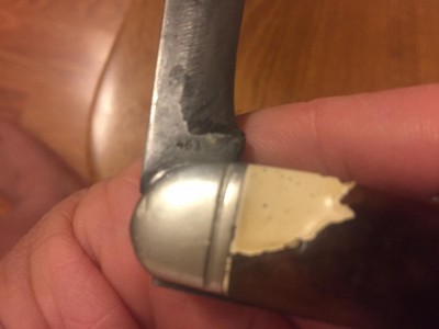

Here is a bone handled Western Boulder folding hunter. Notice the tang stamp and the pattern number. Also a bone scaled 461 whittler with a pattern number, a bone handled 424 stockman, and a bone handled Western Boulder 901 with an extremely light pattern number etched on the tang. I have another 4 inch bone whittler that does not have a pattern number on the tang. Then I have several western boulder Delrin 742 stockman knives and all have a pattern number.
With western it seems that stamping or not stamping a pattern number was no set rule.
