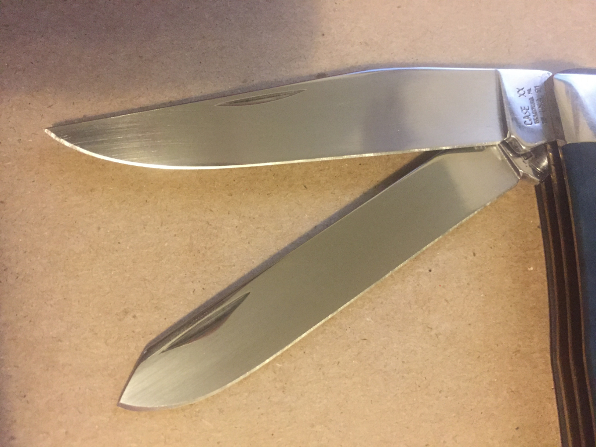

I've never been a fan of the full size trapper ... not sure if its the butter knife looking spey or the rounded trapper style clip that is instantly recognizable as its own. Anyways, I finally figured I ought to have at least 1 trapper in my collection, so when I got it, I liked the pronounced radius on the spey even less than I thought I would and the clip seemed to just have way too much belly in it near the tip. So the wheels start turning & I figured it wouldn't be too much trouble to put my take on it. After a few hours of careful fiddling, I reshaped the spey and the clip - kind of looks more Queen or GEC-ish now. The differences are subtle, but if you look closely you can see the mods ... I kinda like it now
Here's the "before" picture for comparison ... most time consuming part was removing the etching (I thought it was going to be a silk screen etch that is easy to remove with lacquer thinner - unfortunately it was laser engraved, so I had to run the grits from 150-1500 & then buffed it to get it to like new shine ... just takes time). Man, this one was a PIA to work in ... bet I opened and closed each blade a few hundred times (good aerobic exercise) - the bolster got so hot I could barely touch it ... it was extremely tight & had no snap when I got it - snaps better than average now. Anyways, nice project for a cold saturday afternoon when there's no fishing or golf to be had ...

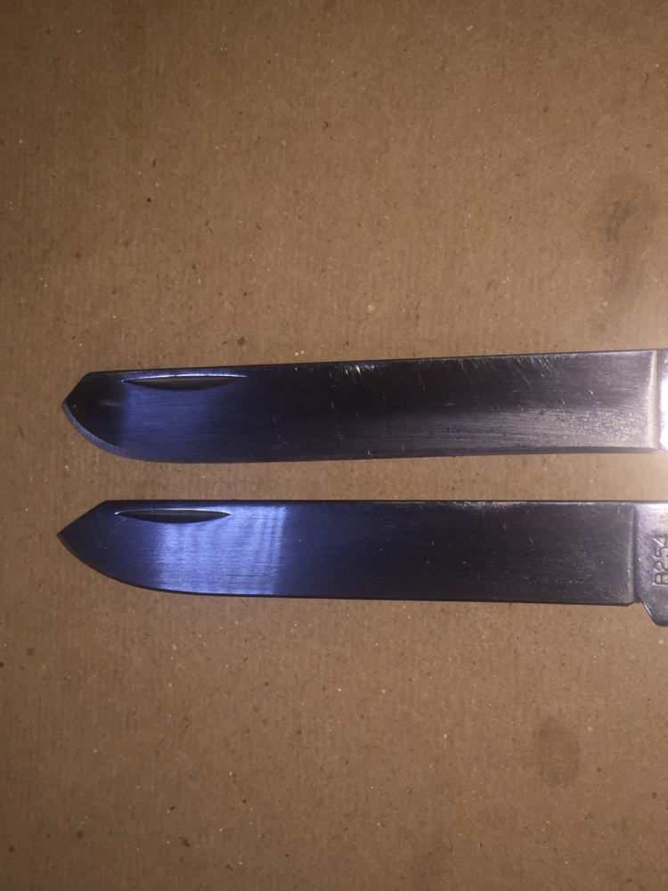

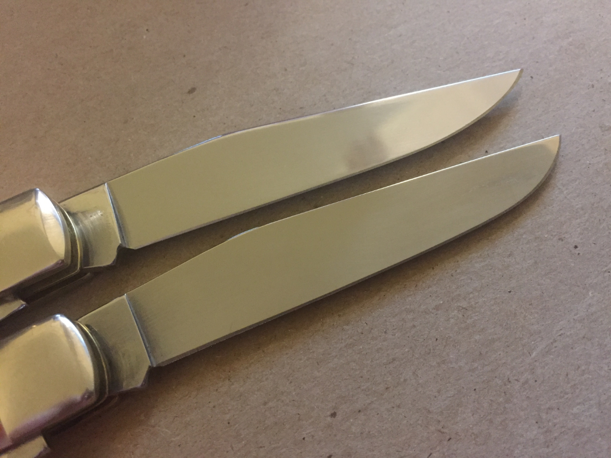

Colonel26 - I used files for reshaping the blades, a dremel tool to round over the top edges, and a stationary disc sander to flatten out the little angled tip of the spey. Sand paper for removing the etching. Buffing wheel to bring out the shine after 1500 grit paper. Here's a side by side with a newer Case trapper I forgot I had - can see the clip blade mod better ...

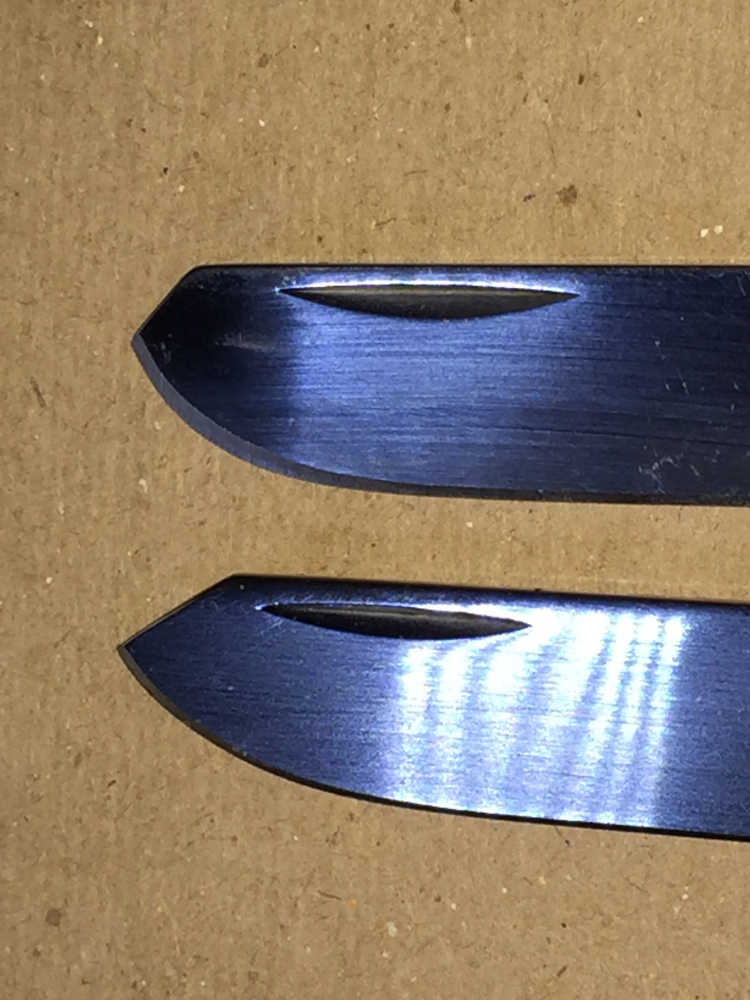

forgot to include pics of spey compared to a non-modified version ...
