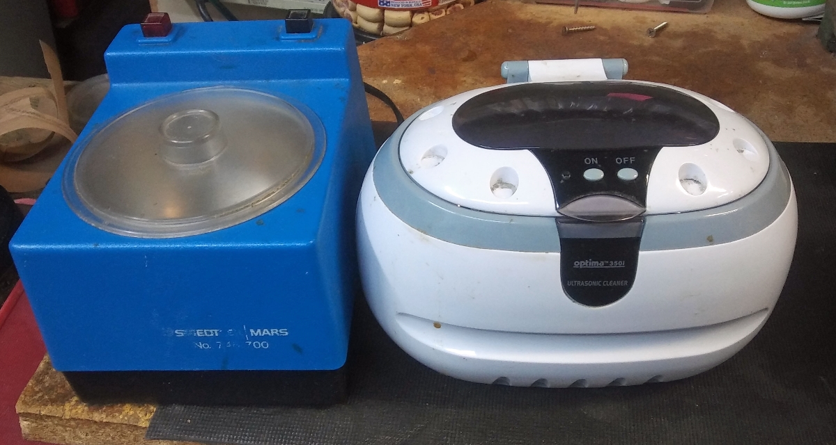

Ken, I probably use my sonic cleaner’s for knife cleaning and restoration similar to the way you would be using a sonic cleaner for knives.
First of all I do not use large industrial grade sonic cleaners. I would imagine they would generate too much heat. The only tools I ever clean in them is an occasional rusty tool from an estate sale, such as a small pair of rusty Vise Grips I picked up this week.
I have two sonic cleaners; one was a gift from a friend and the other something I picked up at a yard or estate sale.
One has a round tank in it about 4”in diameter, the other one has an oval tank will take a knife about 6” long. The little square one will run until a sensor and it tells that it is too hot and then it shuts down, approx somewhere between 5 to 10 minutes. The oval unit has approx a 30 second time cycle on it. If you want to run it for more than 30 seconds you have to stay close by and hit the button every time the cycle ends.
The good news is five minutes is the maximum I need to clean knife parts with a sonic cleaner, assembled knives I don’t usually cycle more than about two minutes. You must always be mindful of heat when using the sonic cleaner. After about five minutes a knife can be warm enough that it is uncomfortable to hold in your bare hand. It’s about as warm as the hot water in your faucet.
I don’t let a knife get hot in the sonic cleaner if handles and everything are intact, unless they’re all metal. Obviously getting celluloid, bone, stag and even plastic handles too warm is not a good idea. If I am trying to clean a knife that is intact with handles, it probably has some junk down inside the pockets like oil or grease that I want to clean out, I would generally give that only three or four 30 second cycles to help cut the crud inside the knife. If that doesn’t work I generally add more Dawn and allow it to set in the cleaner and cool down. After it has reached room temperature then I repeat the three or four cycles, never allowing the knife to get too warm.
I’m very cautious of dry bone or stag in the sonic cleaner. If the knife is dirty but the handle appears to be in good shape and needs cleaning that I might use three or four 30 second cycles.
I suppose if you used a heavy-duty sonic cleaner with a much stronger vibration than ones I have you might be able to damage a vintage knife, crack the bone were stag handled, especially if you allowed it to get too hot. The sonic cleaners that I have experience with all generate heat. So anything that you’re going to leave in for any extended time had better be impervious to the heat. Too much heat and moisture on old, and probably dried out stag or bone handles could conceivably cause a crack as the moisture gets in the handle and expands it.
I really don’t find it necessary to use a long cycle on knives. When you put the knife in the water with the soap and turn the machine on you can start seeing dirt or rust vibrating out of the knife, almost instantaneously. After I have allowed the sonic cleaner to run as long as I want, I then removed the knife or parts from the cleaner and wash and rinse them in with hot water and a stiff nylon brush. Longer stiffer bristles will work down inside the pocket the knife is still assembled and help remove any remaining gunk in there.
Without knowing anything about the larger commercial units other than what I have read posted here, I would recommend you avoid them for the purpose of cleaning knives. I get so much crud and junk out of a knife, or off of the parts if it’s a disassembled knife, that I must of necessity change the water before I put in a second knife. In my cleaners I barely cover the knife being cleaned with water and then add a few drops of Simple Green or Dawn dishwashing liquid. Most of the time I have less than ½ cup liquid in one of my cleaners.
Well, that’s about all I can think of at the moment. If you have any questions I will be happy to answer them to the best of my ability.
PS – if I were going to replace one of my units would probably look very hard at this one on eBay. I like the fact that it has a timer you can set.

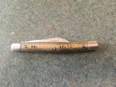

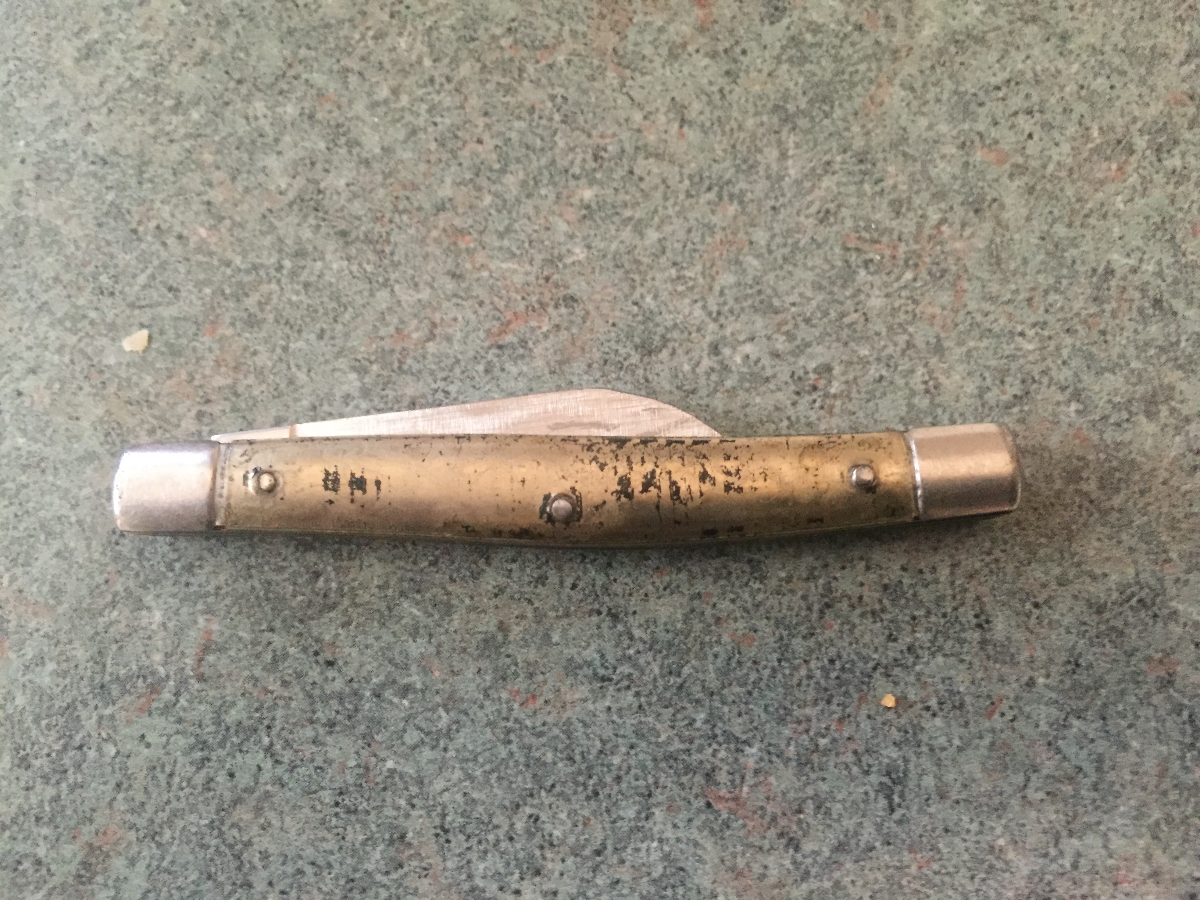

I absolutely love my ultrasonic cleaner...but recently found a no-no.
Although not the same knife...my old Imperial Celluloid started out looking like this...
And came out, looking like this...

Sorry to see that Doc. I guess at least it’s clean now. I assume it was a solvent? Was it heated?
Please elaborate, so others of us don’t repeat it. ::woot::
