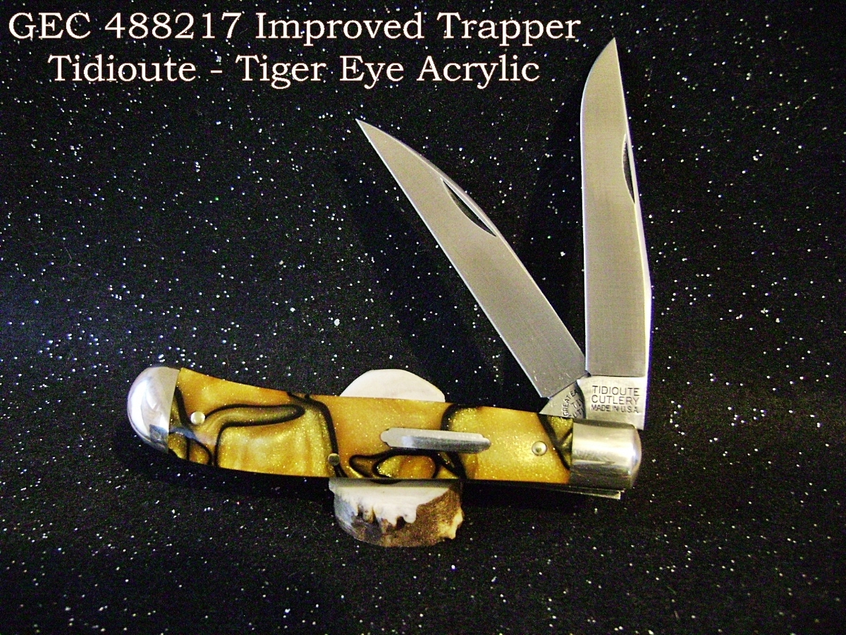

Recently I have become interested in traditional slip joint folders. I just got a Tidioute #66 Calf Roper, 3 blade. This is a magnificent tool.
Now I am contemplating buying a two blade folder. I am curious about two basic variations: both blades hinged at the same end (Jack) or hinged at opposite ends (does this have a pattern name?).

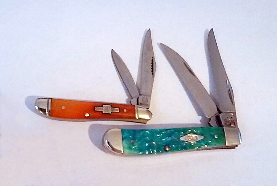

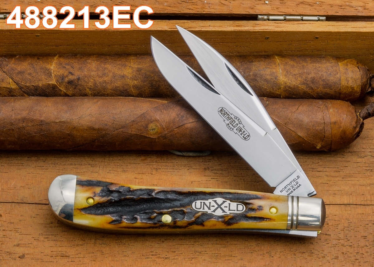

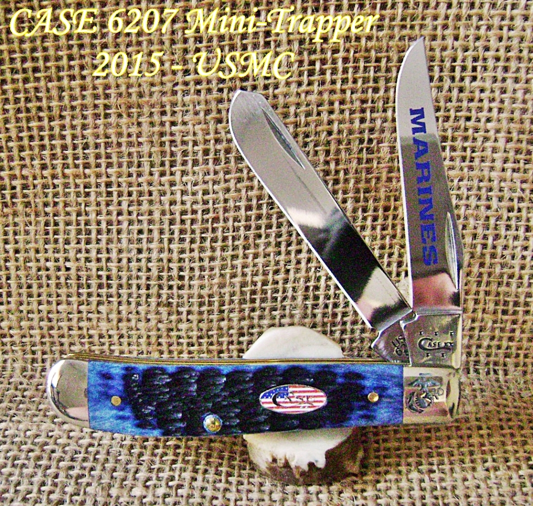

Depending on your taste in blades and knife size, there are many different configurations, as you probably already know. As to your question about pattern names for knives with a blade at each end on the same spring, the ones that right away come to mind are the "Muskrat", the "Moose" (a larger knife) and the "Pen knife" ( typically a small knife). I'm sure there are others that I just don't remember at the moment but there will be others who will come along and fill the gaps.

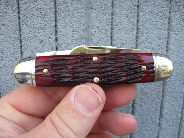

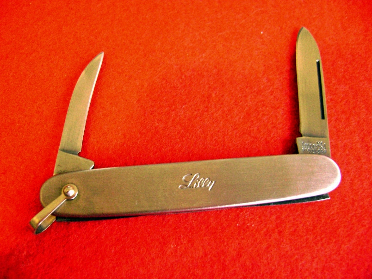

Schrade 77OT Muskrat Great Eastern 541209 Moose Equal End Cigar Imperial Advertising Pen Knife There are a multitude of two blade Jack patterns. Personally, I'm drawn to the two blade Jacks which come in just about any size you want all the way from the LARGE "Folding Hunter" down to the diminutive "Peanut". Personally I'm a huge fan of the 3¼" closed medium jack and the 3½" "Mini-Trapper" or any other 3½" Jacks. JMHO
Case Folding Hunter Camillus 14 Jack 3-3/8" closed
Case Mini-Trapper 3½" closed Rough Rider Peanut compared to a Case Mini-Trapper (for size)

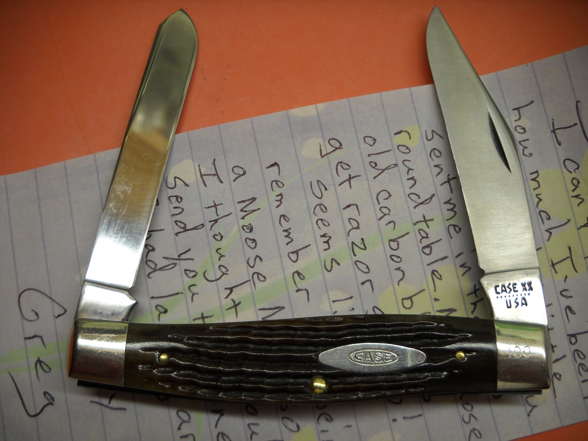

Here's a Muskrat that came from AAPK member gsmith7158, who generously gifted me with it:

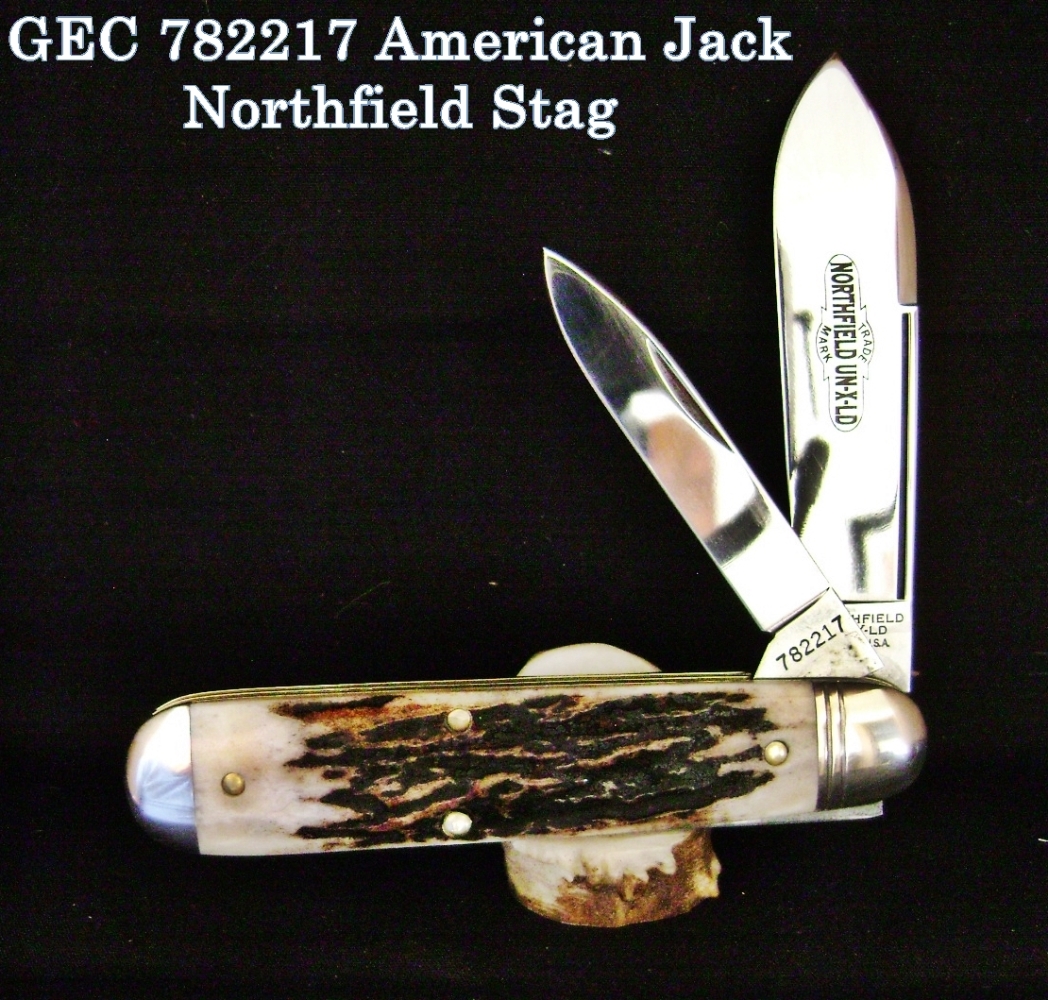

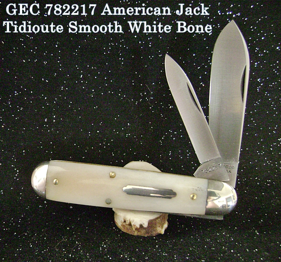

It may be helpful to see the patterns Bruno's talking about. I doubt you'll ever get to coon finger the patterns Bruno recommended outside a knife show and a picture is worth a thousand words, pictures will have to suffice for the time being.
I've already shown you an example of the 54 Moose above, so here's the 78 and 48 (I don't have a 73).

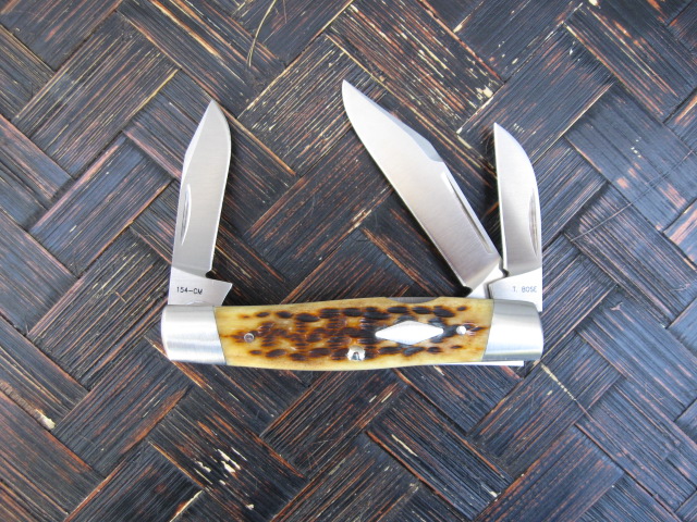

The Case/Bose Cattle knife is unique in this regard. It's a 3 blade, 2 spring knife with all the nail nicks accessible from the mark side. The large Clip and Sheepsoot open right handed and the small Clip opens left handed.
