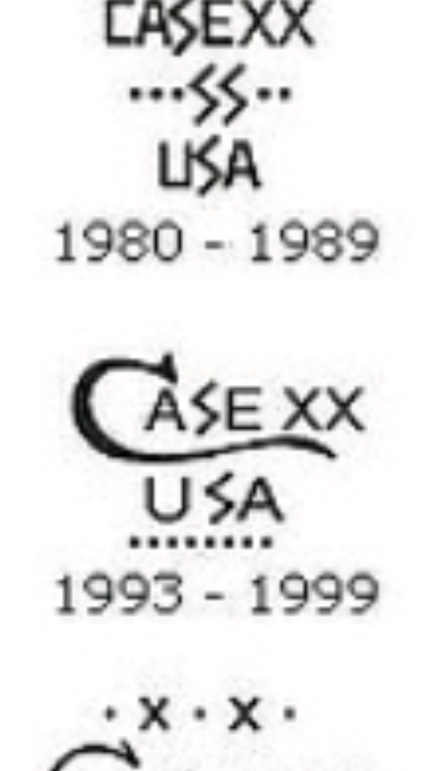

Good morning everyone, me again.
Can you all help me please? I cannot figure out the Case tang stamp between 1993-1999.
It shows 8 dots beneath the Case. No matter how I count the years, I cannot come up with 8 years to equal the dots. I bought a peanut with 5 dots and I know it falls in here somewhere, but for the life of me I cannot figure these years. It is the long tail C, not lightning S stamp. Thank you for your patience with me.

Re: Case tang stamp
90s Case dates like all of the rest, except they actually put dates on them into 93 I think.
A 5 dot is 95 4 dot is 96 and so on. Correct me if I’m wrong.It won't be the first time.
Kerry

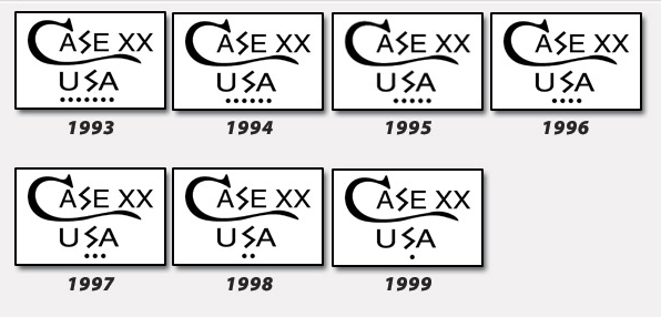

- gsmith7158
- Posts: 8610
Re: Case tang stamp
This OP picture is incorrect it should have only seven dots for 1993. I believe the change back to the dot system occurred in June of 1993 so there were some knives with the date early in the year and some with dots after June. Knives made in 2000 carries the new tang stamp with x's and dots.

- TwoFlowersLuggage
- Posts: 3113
- Joined: Sun Nov 26, 2017 8:18 pm
- Location: Stuck in traffic on a highway in Southern California
Re: Case tang stamp
Ahh - good eye Greg - I even counted them and still got it wrong! Here's the picture that used to be on the Case website:
