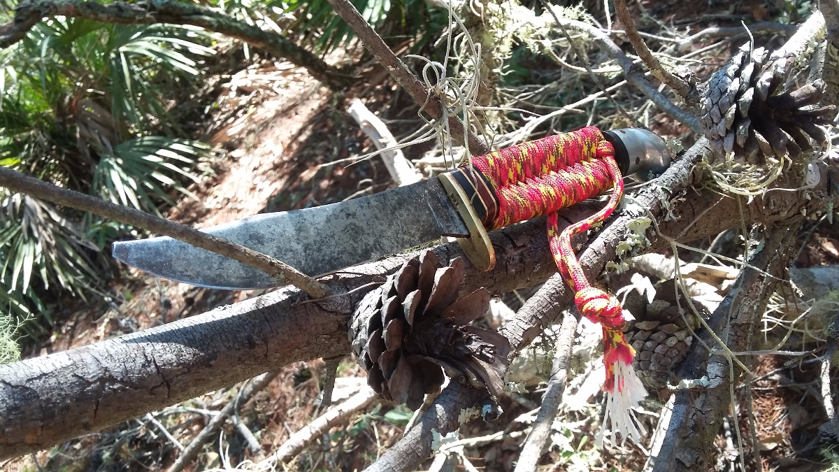

Let me say.......I'm working my way up to the novice level in blade steel performance.
I have a few options when I carry a fixed blade and I always, always carry my broken tip, paracord handled Western because it's
soooooooooo dang sharp. The edge is ahead of the others I have.
