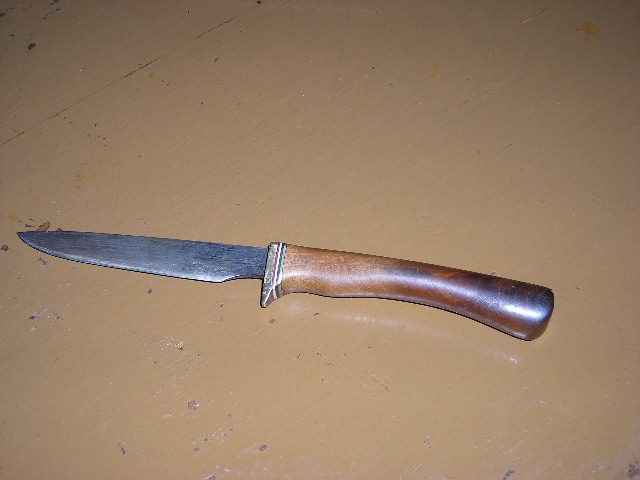

I've been carrying one for 2 yrs now. Everyday. As a matter of fact, I've field dressed 3 deer in the last 2 weeks with it.
It's just dirty damascus made from bandsaw blade, banding material and L6 bandsaw blade. My son-in-law and I made the billet up and I made us each a knife . He carried his on his last tour in Iraq.

Just curious....but what did your son in law use his home made Damascus knife for in Iraq? Am I to understant that it was expected to hold up better than the G.I issued knives?brucegodlesky wrote:I've been carrying one for 2 yrs now. Everyday. As a matter of fact, I've field dressed 3 deer in the last 2 weeks with it.

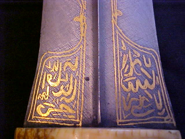

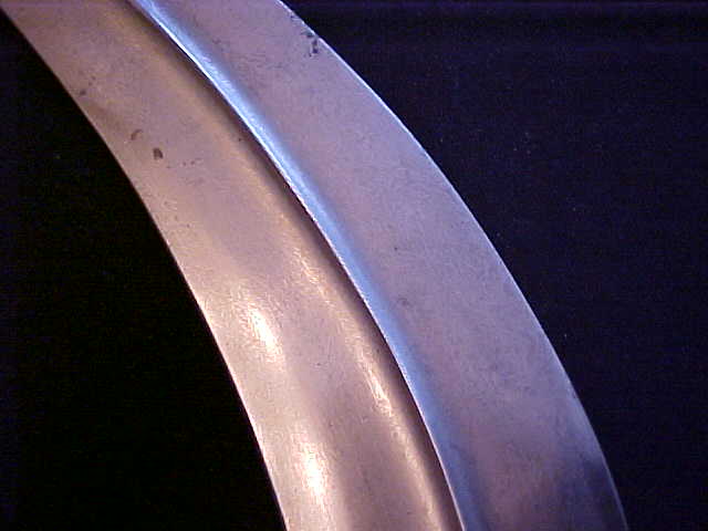

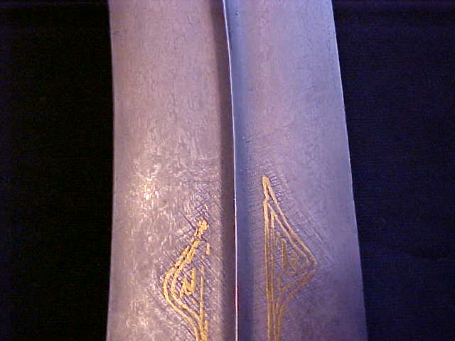

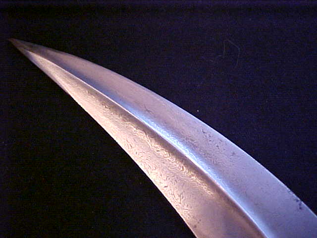

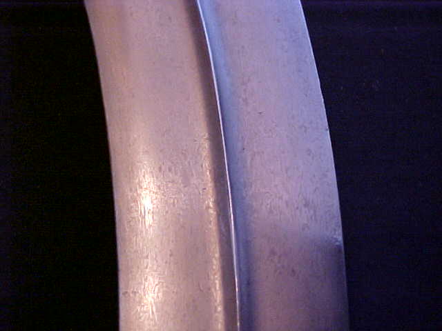

Here are some pictures of a knife blade in my collection dated to the mid 17th century.The pattern is a bit hard to see but it is there.The handle is walrus ivory and the inlay is gold.

My son-in-law carried his as a neck knife, just an auxillary. He already had a workhorse I had made him.
By the way....nice knife you made for your son-in-law. I'm sure he wore it proudly. My profound appreciation for his service.

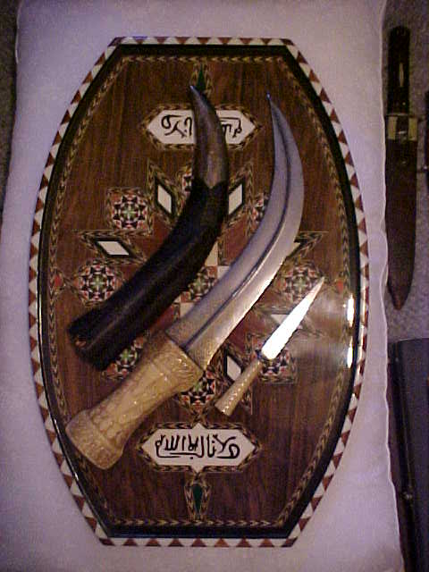

Thanks for the kind words;I'll take that under advisement. Here's a picture of the whole knife with it's sheath and companion dagger(also damascus and ivory).The sheath is constructed of wood with a lizard type skin covering that is embossed and a copper end piece that is silver plated.Sauconian wrote:k7K,
I was thinking how I'd like to visit that knife museum at Smoky Mt. .......but,............Could I just come to your house instead ?![]()
Fran
what threw me off on this was I thought silver plating was a relatively new process(electroplating is)until I had the knife appraised.Turns out plating with silver over copper is probably at least a thousand years old.
