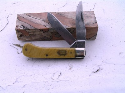

jonet143 wrote:do you think they took the lowest bid on handle material?
No I don't think that was the problem at all. I have a number of celluloid handled knives;some that are fairly new but most that date to the early 20's and the deterioration seems to strike randomly.
I have knives that one side has deteriorated completely and the other side is untouched! All my celluloid knives are stored in a separate container and the precautions I take with them are:
I use NO OIL on them of ANY TYPE. I inspected them frequently(at least once a month).I use Mother's Mag Wheel Polish to clean off any corrosion that forms although once it has started,there is nothing I have found that will stop it.
All my knives are stored in a room that is not in the direct sunlight and is pretty much climate controlled(we have central air/heat).The majority are stored in an old linotype storage case made of oak(very dried out)with velvet liners.Every drawer(there are 24 of them)has several dessicant bags in them and those are changed every 3 months.The bags are recycled by drying them in the oven for about an hour at 200 degrees.
I acquired a knife awhile back that had mint condition stainless steel blades and the celluloid handles had corroded the backspring and the brass liners to the point they had broken in half.I keep it as a reminder of how corrosive celluloid can be.
I wish I had an answer as to why this occurs with such randomness.
