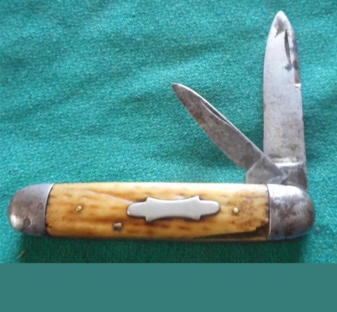

I've a Robeson Big Equal End Jack with a never before seen pattern stamping. A typical bone handled big equal end Jack is a 622013. Mine is stamped 62213 (over) 1 - 4. I know a few knife patterns had a 1/2 to indicate a variation of an earlier pattern but I don't know what this 1 - 4 indications. Anyone else seen this before?

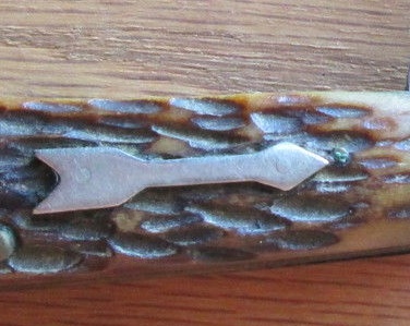

Robert, actually, your 013 knife does not have a sabre-cut spear blade.
It does have a different shield than the one shown in the Robeson section of Bruce Voyles' book and from that pictured in an original early 1900's Robeson catalog.
The 622013 in both those books has an arrow shaped shield, shown below.
Whether a different shield would warrant an added suffix identifier to the pattern number, I do not know, but that is the only difference I see.
Charlie Noyes
Charlie Noyes

I'm having horrible connectivity with my AT&T wifi today. Actually for a few months. And so does our whole neighborhood. So right now it won't let me access anything but the last 8 photos out of over 6,000 on my iPad. I stand corrected on the saber spear but there seem to be variations in a spear blade. Most are ground flat and some are like the one on my 013. Why is there a difference but not a different name. I swear I'm not a knife novice but I seem to be having some loss of brain cells lately. But I do appreciate your help on the Rochester stampings and dates

I was only able to find one other 013 and it had the same badge as mine but his spear blade was ground flat. Thee pattern number was on the reverse side of the sabre but his was 622013. The 1 - 4 has got to be a variation with the spear blade
