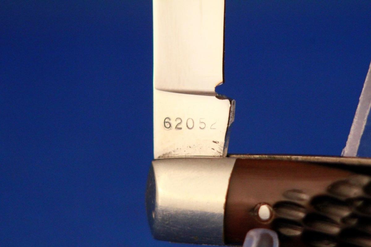

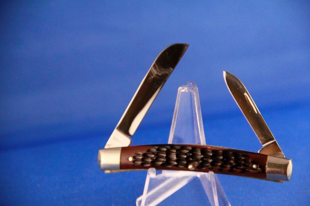

Ok just bought one from eBay and it looks like to me it has had some work done to it. For what I paid for it I can make it an edc but considering I'm new would like for you guys to look at it and tell me if I am seeing something that is nothing OR if it is actually what I think.
Looks to me like there's some epoxy or something around one or more of the pins and looks like the handle has been painted, stained or something and there is still some on the bolster and one of the pins. As most of you know I am new at this so just wondering if I am seeing something that's not right or trying to look and expecting too much.
Either way I think it's a 1973 and like I said I didn't pay much for it so maybe it's a good lesson learned hopefully you guys can tell me. Thanks in advance, James

The knife looks ok to me. Looks like it has Delrin handles which are composite. I woukd say it would make a fine EDC. I like the pattern.

Knife is fine. In those days, Case would use a rivet spinner to spin down all of the handle pins. You are seeing the small circle from the spinning tool, and maybe some of the plastic "flash" around the holes.
