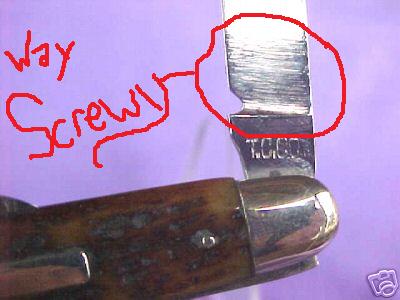

Hey PA I wonder if he has buffed those grinding marks enough? ::barf::

this should clarify my statement
grinding MARKS.jpg (20.93 KiB) Viewed 3831 times

muskrat man wrote:Hey PA I wonder if he has buffed those grinding marks enough? ::barf::
Maybe he was trying to make a nail file. :lol: :lol:

Thanks, muskratman! "Way screwy" That's great!
So he took some kind of grinding wheel to the blades. Why would he do that? To take rust off?
He ground the the heck out of the blade, leaving it looking like a nail file. Then buffed the snot out of the blade to make the grooves look "better".
Am I getting it?
Once again, thanks for putting up with my lack of knowledge.
