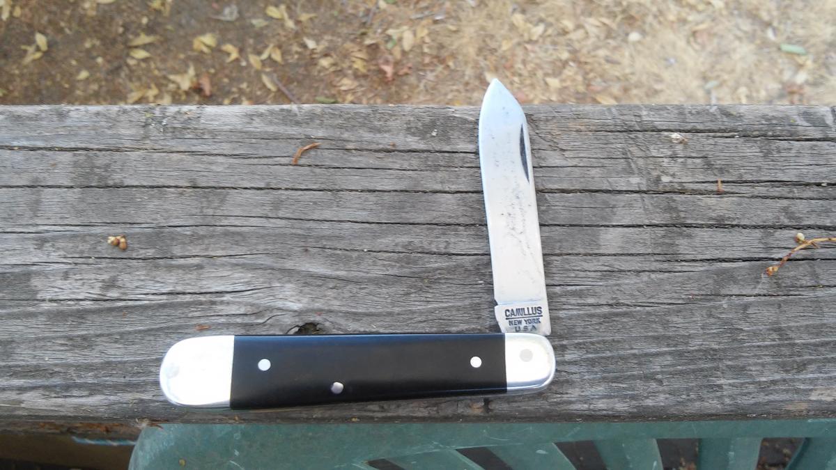

Like most of us around here I have a pile of Electricians knives! :lol: I can't help help it, I keep buying the damn things... ::facepalm:: A couple of years ago I made a TL conversion. Kept the spear blade and trashed the screwdriver blade. I reused the liners and bolsters. It was OK but I just didn't feel the love for the little knife. It had issues but was a usable knife. It has long since found a new home.

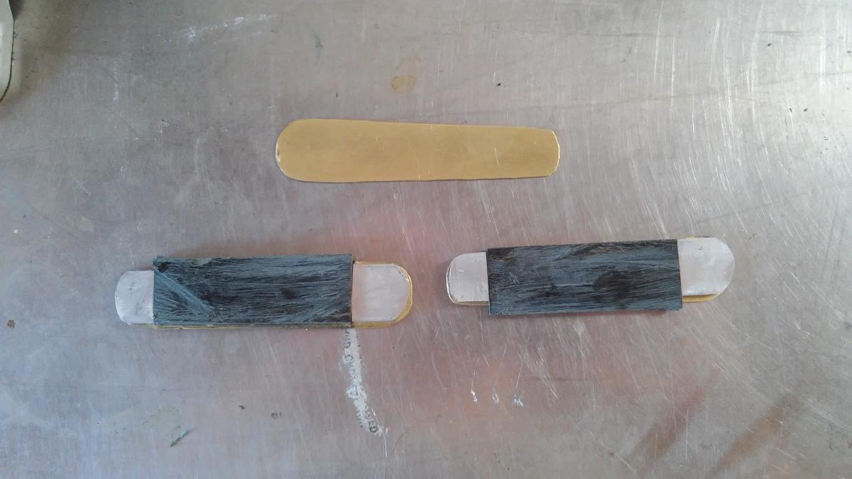

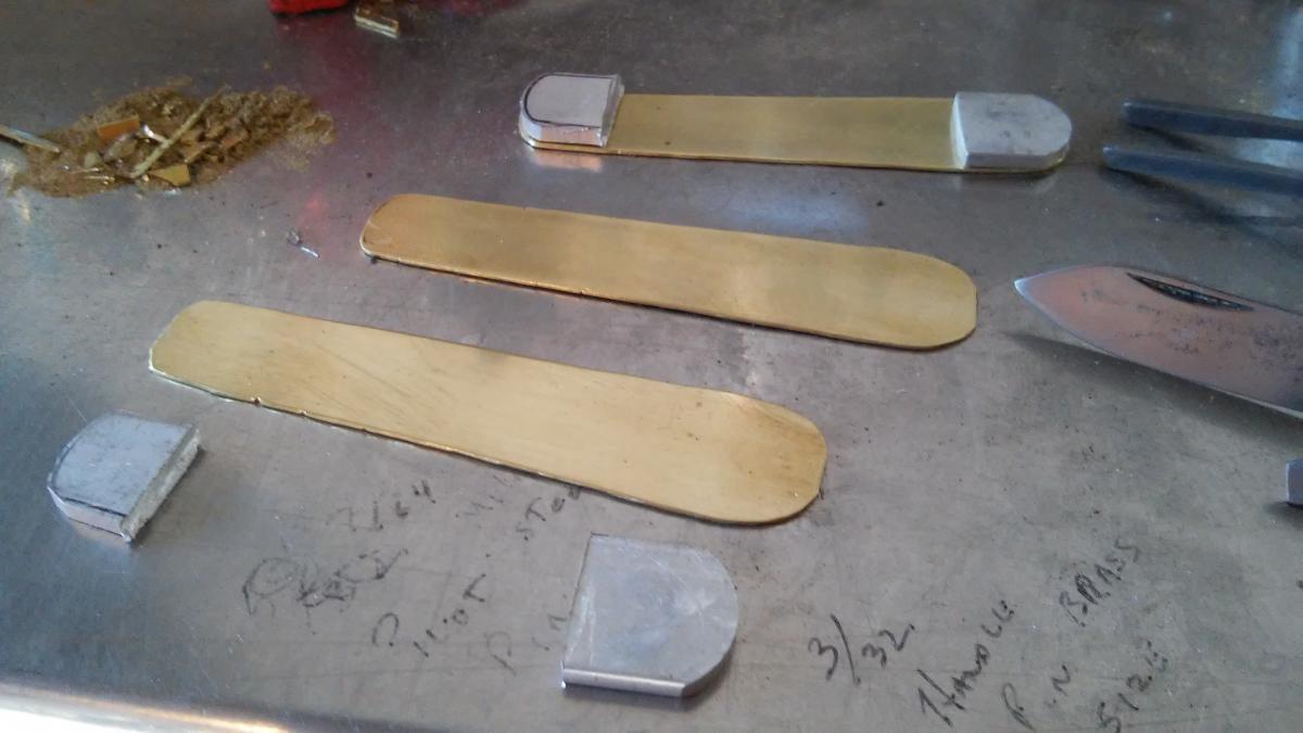

You can see here that I have cut my own brass liners and just to be different. Aluminum bolsters!
For handle material I chose a black phenolic resin material called black paper. You may notice by now the extra liner...

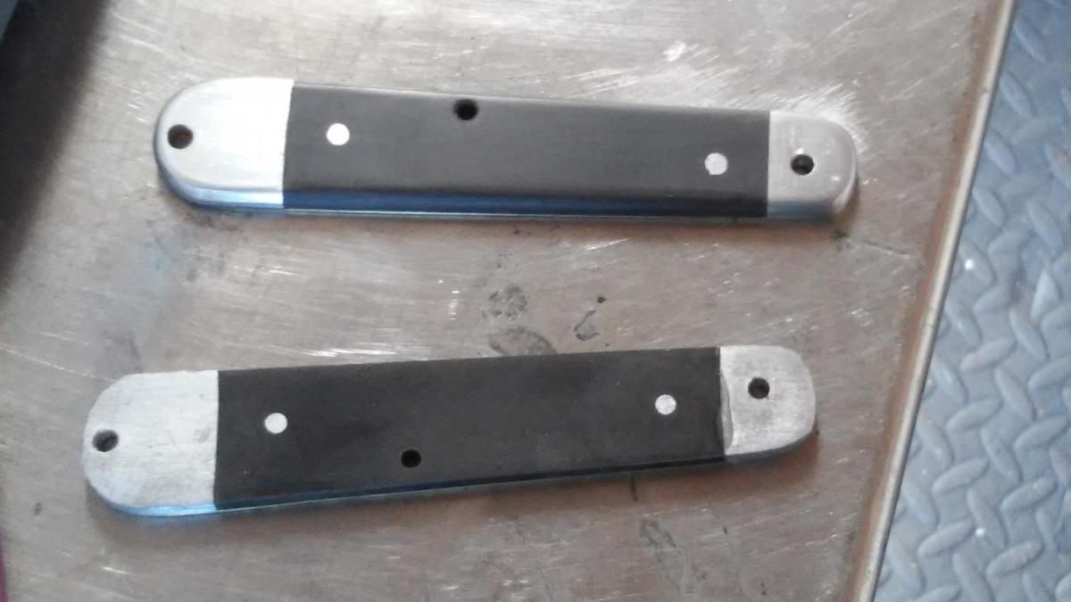

I drilled the holes for the anchor pin, the rocker pin and pivot pin. Then some light finishing before pinning the knife together.

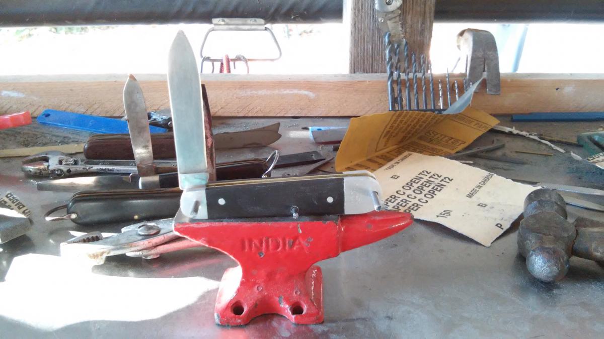

Before trimming and peening the pins I pinned a mock up together to make sure that it functioned smoothly. Then trimmed the pins, peened them. Then I shaped and sanded the bolsters and scales. and hand polished it till I was happy! ::super_happy::

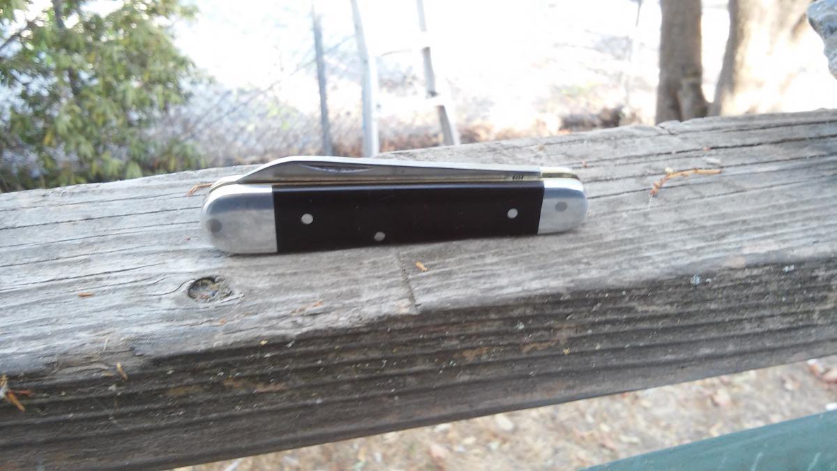

And the finished knife!
I was very happy to give this knife to Brent. I almost kept it for myself ::shrug:: But I did the right thing ::tu:: Brent is happy with his new custom knife. ::handshake:: I am as just a pleased my self. My first custom ::ds:: I think I got it right!
