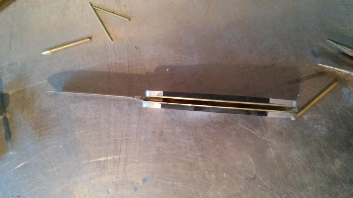

You can see here that I have cut my own brass liners and just to be different. Aluminum bolsters!
For handle material I chose a black phenolic resin material called black paper. You may notice by now the extra liner...
I was going make a dual blade knife but decide that a single blade would look more pleasing.
I drilled the holes for the anchor pin, the rocker pin and pivot pin. Then some light finishing before pinning the knife together.
Before trimming and peening the pins I pinned a mock up together to make sure that it functioned smoothly. Then trimmed the pins, peened them. Then I shaped and sanded the bolsters and scales. and hand polished it till I was happy!
And the finished knife!
