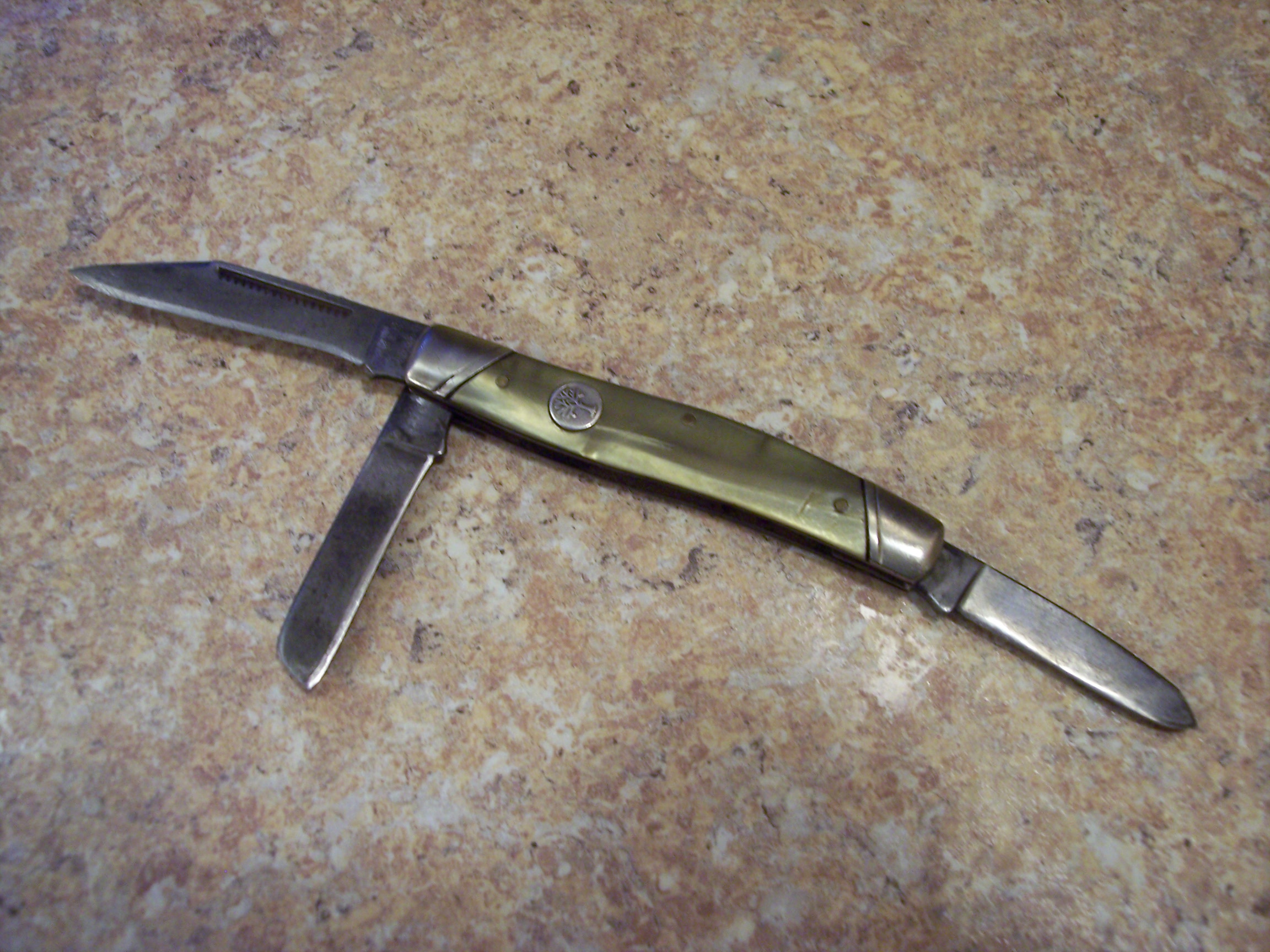

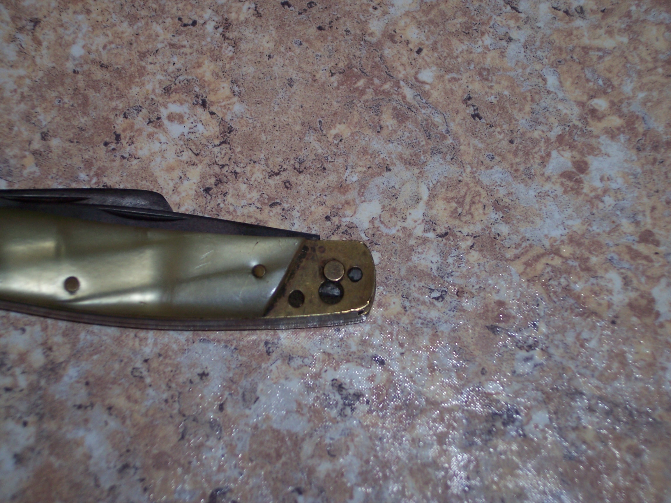

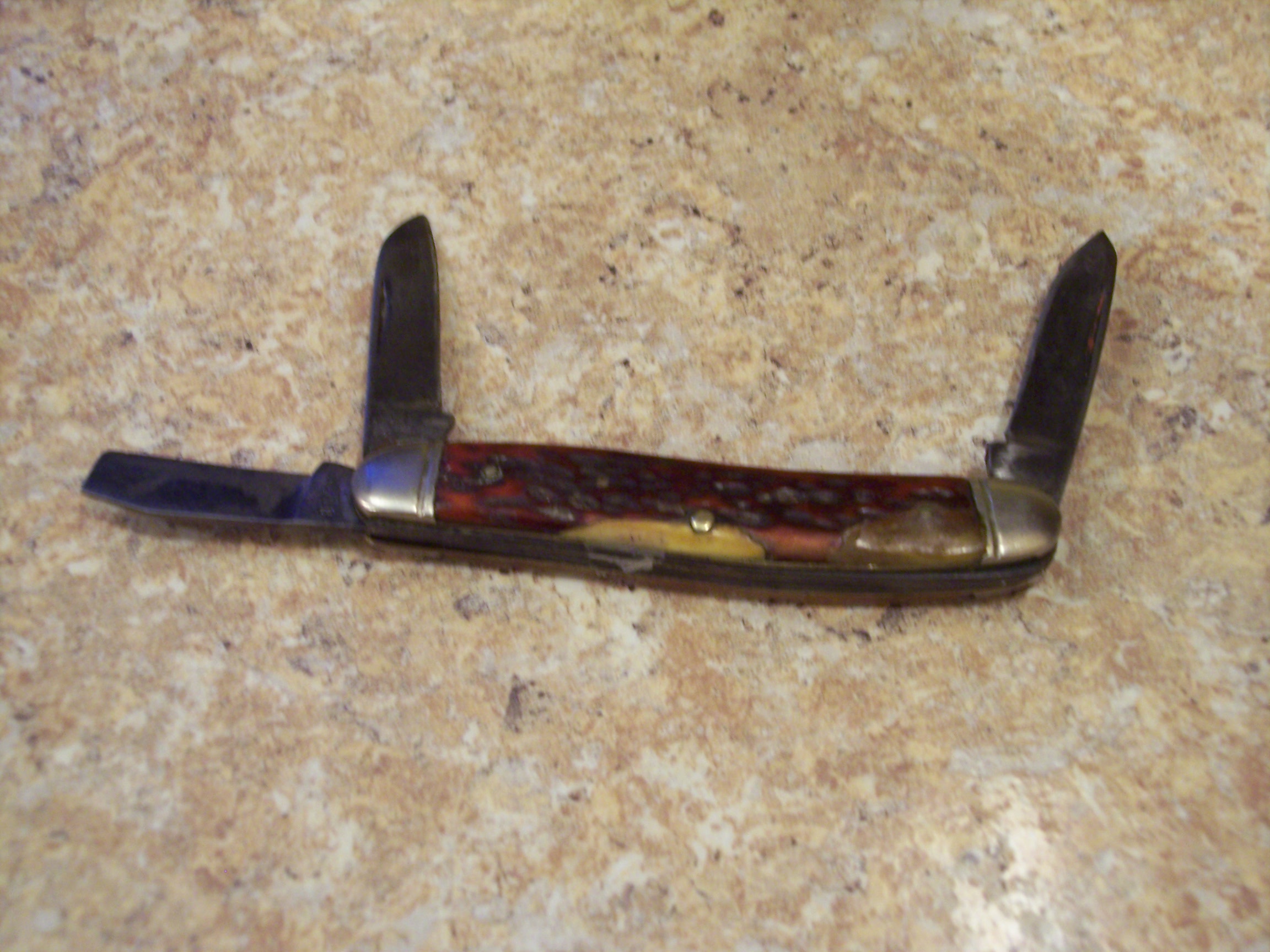

Here are a couple.
This one needs bolster, new handles, and the master blade has been sharpened down, but still has life This one needs master blade, handles. Both are Boker USA Dale Whitesell

Re: how do evaluate a knife for restore job?
That boker might be worth it (IMO, anyway).
Not too much work, and the blades are fairly serviceable.
