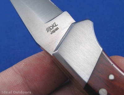

Here is some thing I do not see every day.... :shock:
Looks to me like a Japan made knife with a pattern rights for USA.
I am sure I have this WRONG....

That knife is made with AUS-8, which is a Japanese steel comparable to 440B in makeup. Looks like it was made by Moki in Japan, (quality knives, as stated above, IMO), for Lakota. I'll guess the patent is for the overall handle shape, particularly the bolster.

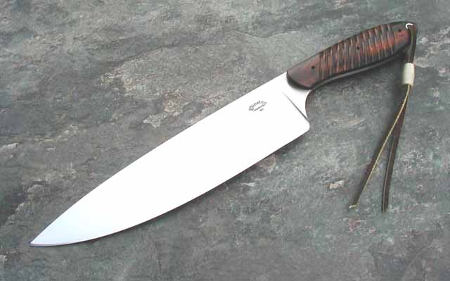

David Winston Chef's Knife.jpg (23.87 KiB) Viewed 2221 times
