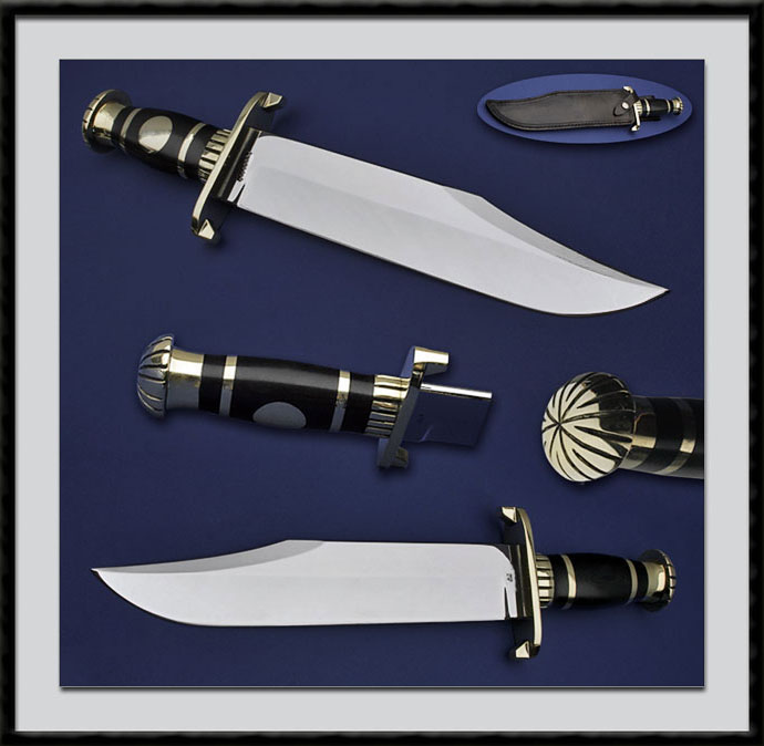

O-1 was good enough for John Nelson Cooper, it oughta be good enough for an Arkansas hillbilly like me... the last count I had, which was before he died, Mr. Cooper had built something over 30,000 knives in his career. His Iron Mistress is, to me, one of the definitive bowies of all time. He sold a grunch of them to movie stars, and the like.
The thing I like about O-1 is the combination of hardness and polishability (is that a word ?). You can get D2 harder, but it just won't polish (for me, neway).

Forgot to add the pic of Mr. Cooper's Iron Mistress.... gettin' old is NOT for sissies !
