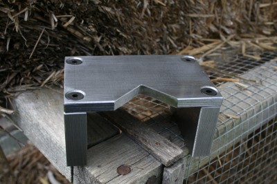

Here is one that I made from scrap steel. Many thanks to MuskratMan for the idea! I made mine kinda small because most people only have a small tabletop drill press. I have a tabletop and a floor model and can use my jig with either drill press. The top on my jig is 3" x 5" (I think). I may make a few more, if there is any interest.

Awesome tool caddy!! .....and really good video by MM.
