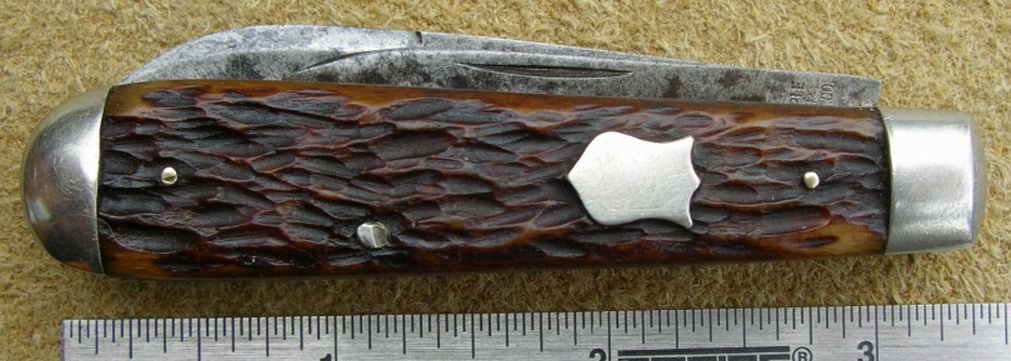

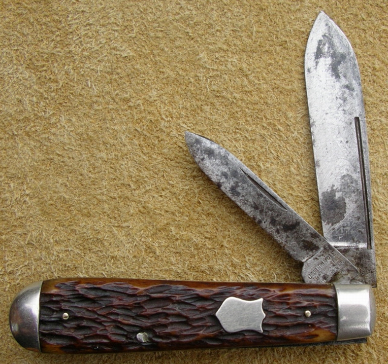

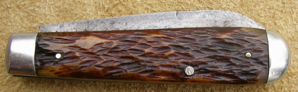

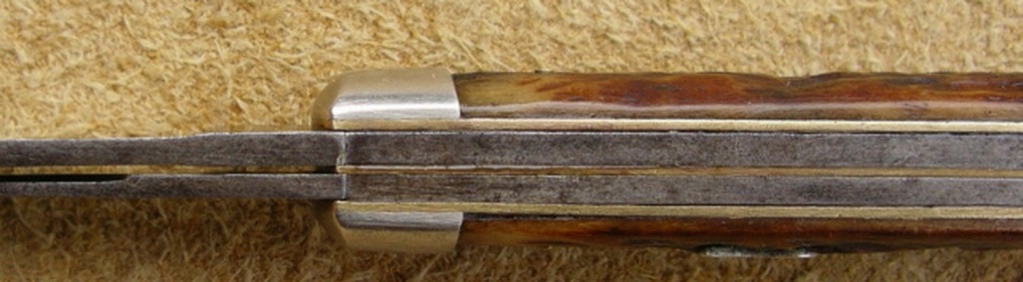

Here is the knife that is being questioned.
These are some of the comments received;
Very pretty knife! But does anyone else think that bone looks a little strange? The jigging is cut way below the edges of the bolsters and the shield. The coloring is kind of mottled; but there's not much much wear apparent. I would suspect that someone replaced it or rejigged and dyed the old bone.
I think that bone looks a lot strange.
There is a lot of this very same bone on eBay.
All of it pristine, unused, even on well used knives.
And on many different brands, from many different places and times.
And it was all colored ON THE KNIFE, so the bald spots are brown too (that's a big reason it looks odd -- how many bald guys dye their scalps to match their hair?).
And although the jigging pattern is very pretty, it is not a jigging pattern ever made by any bone company in the past.
Remember my lesson about blade profiles: they were never random.
Neither were jigging patterns. Not even when done by hand.
Other oddities:
Shield not inletted. Usually isn't, on THIS type of bone. Usually was, on old bone handles.
Handle rivets were spun, but the structural rivet, the spring rivet, was not. Why not?
Alright, Sherlock... what do YOU conclude?
BRL...

WOW. I guess the only way it could be authentic is for someone high up in the ranks to be selling it. The knife looks 100% to me. The reason the jigging is not wore is because the knife has not been used. It appears to have full blades so the handles would not have been wore.

I've seen no mention of the fact that bone darkens as it ages and the oil from being handled or stored near other things will affect the color of bone. I've got one that I had worked on and the difference in bone color before and after being polished is astounding. That knife looks fine and I have some really old English knives where the bald spots are just as nicely dyed as the rest of the knife.

Re: Jigged Bone Handles
This is not a trick question or posting.
The knife shown is original as are the jigged bone handles on said knife.
This is the statement that really surprises me;

I think that knife, bone and all, is absolutely authentic in every way.

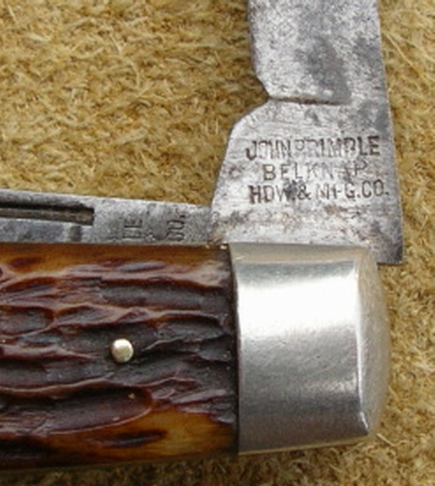

Here is I knife I had repaired by a current Sheffield cutler. The back scale matches the coloring of the front scale even though they came from two different knives. I'm pretty sure the front scale is original ( see the cracks near the bolster)and the back is replaced with the same color of vintage bone from another knife and they were then both sanded re-jigged with a simpler pattern and polished. At any rate what you see of the back scale is the color of both scales when found. Now either they were redyed while on the knife or the polishing really brought out the color. The only reason you can tell the difference is that the back scale has a wider spacing of the jigging marks. I think he was getting tired by the time he got to that side. The color though appears to go all the way through.

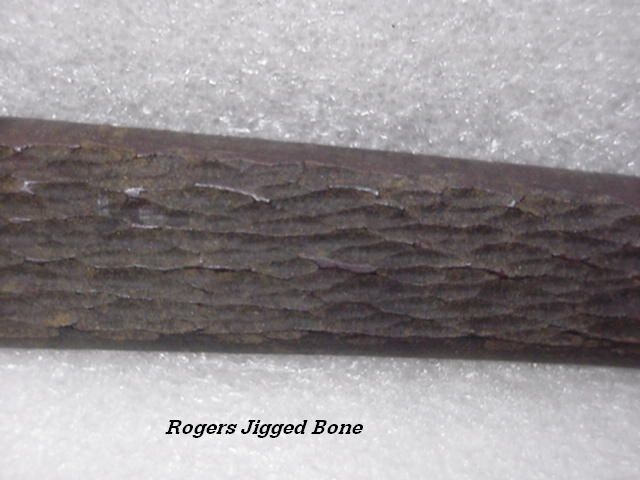

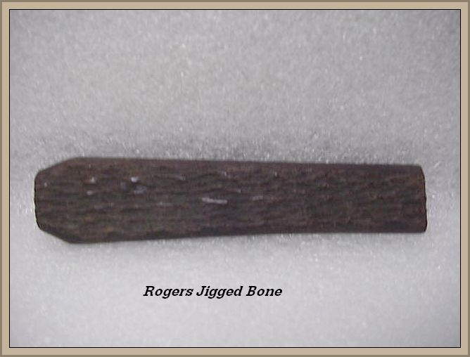

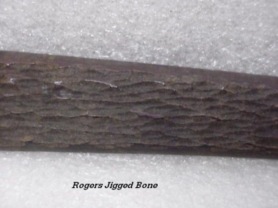

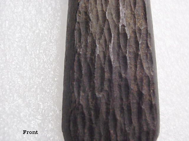

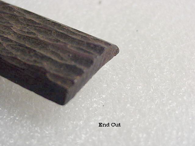

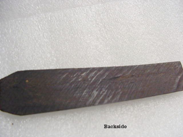

This is the way the Rogers company did it.
1. Boil the bone
2. Cut slabs to proper thickness
3. Cut Length & Width slightly over sized
4. Jig the slabs
5. Dye the jigged slabs
6. Done, Ship to client.
Here is a vintage unused slab of Rogers jigged bone. These were going to be used on Remington knives but were never used due to the war and Remington closing down their knife making division and selling all their equipment to Pal. These handles were found in a warehouse inside a drum several years ago. What an opportunity to see exactly how these handles were delivered to the knife factories that made knives during this period.
Note that the handle is very dark, a chocolate brown color. The front, back and all sides are the same color. When these were fitted to a knife frame the length was adjusted accordingly and then pinned to the liner, then after the knife was assembled the width was sanded down to meet the liners. During this time the edges would become lighter as the dark dye was sanded off. Next the handles were buffed/polished and this would lighten them to the color we are use to seeing on an old unused knife from that period.
