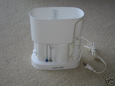

Here is my plan to wash a pocket knife.
Place the knife and pik wand in the tank with some oil. Useing Saran Wrap and a rubber band as a lid to seal it from makeing a BIG mess. 8) Then us a magnet to move the open bladed knife around in the tank when washing it. ::shrug::
Water Pik.jpg (17.65 KiB) Viewed 3756 times
smiling-knife
Posts: 3365
Location: Bedford, UK
Post by smiling-knife »
Interesting plan justold52 ::nod:: . It sounds like mineral oil jacuzzi :lol: If possible, please post before and after pics of the knife. Thanks :) s-k

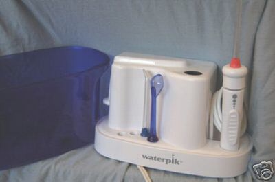

justold52
Posts: 4459
Post by justold52 »
Ok Ok I just won this one for $26.00+ shipping. It looks like the tank is bigger too. Has any one tryed this yet? I got a bottle of Mineral Oil but I think it is to tick for the Water Pik. Got a bottle of Marvel Mystery Oil it's nice red. It says ("Avoid frquent and prolonged contact with skin")??? I tested the Marvel oil with a q-tip on scrimshaw and it will eat ink.
I also have a can of WD 40 now, Just waiting for the Water Pik.
Speaking of scrimshaw does any one know what the Schrade finished theirs with. They look like the last step they had a clear sealler on them.
What would be good to seal and coat the Scrimshaw? :| :?
Water Pik.jpg (11.42 KiB) Viewed 3575 times
