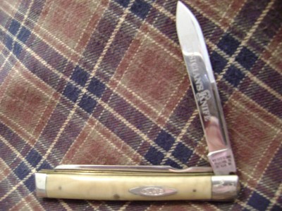

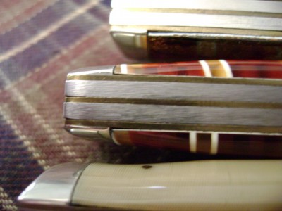

What type of an environment are you storing them?All knives should be stored in an area where there isn't a lot of temperature/humidity variation and NO direct sunlight!Celluloid handled knives should ALWAYS be stored separately from other knives even if they show no evidence of out-gassing.It only takes a very short time for that process to come on and destroy other knives.
Don't know what to do about the curling;don't think it is reversible.I only have about a dozen celluloid knives and they are in a separate box well away from other knives.I have had handles go bad on several and the only cure was to remove them and replace with a more stable material.I had one that the handles didn't deteriorate visibly but actually corroded the brass liners inside and caused them to break apart.I posted pictures of this awhile back in another thread.Here is a shot.

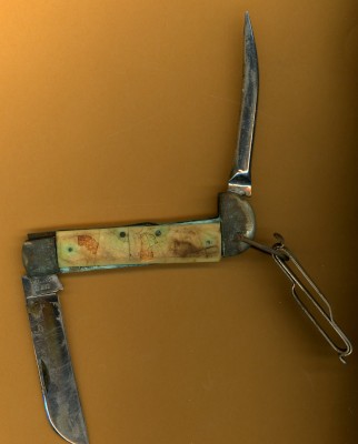

That happened to this Case.
In the process of disassembling it both liners broke in half.
I had to get another frame to put the blades in and put bone handles on it for a customer.

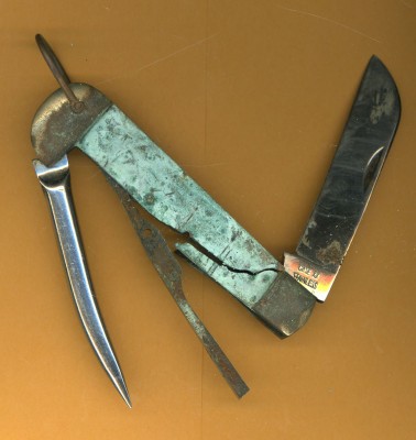

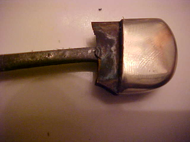

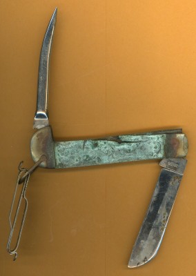

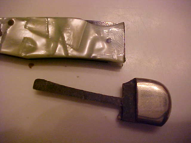

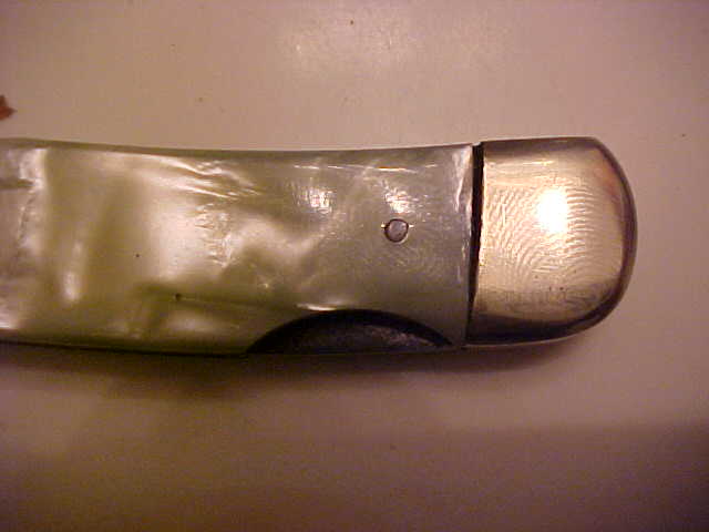

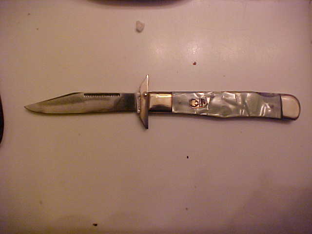

This arrived today in the mail.
I bought it for the blade, it is a good thing I didn’t need anything else!
Here are a couple pics of the knife as I got it out of the package-
Here is the knife with the celluloid removed.
No wonder there is no snap with either blade!
This is not the worse case of off gassing I have seen,
but the frame of this knife is totally destroyed.
A couple little twists and the mark side liner broke completely.
The good news is both blades are salvageable and probably the backspring and lanyard loop as well. Not sure about the bolsters yet.
As attractive as celluloid is and as much as I like nice celluloid, when I see a knife like this I have second thoughts.

You should replace the liners and put new handles on, make it functional again

I bought it for the blade for a repair, otherwise I would have rebuilt it.Miller Bro`s wrote:You should replace the liners and put new handles on, make it functional again
I have made liners before, it is a lot of work, but it is definitely doable.
