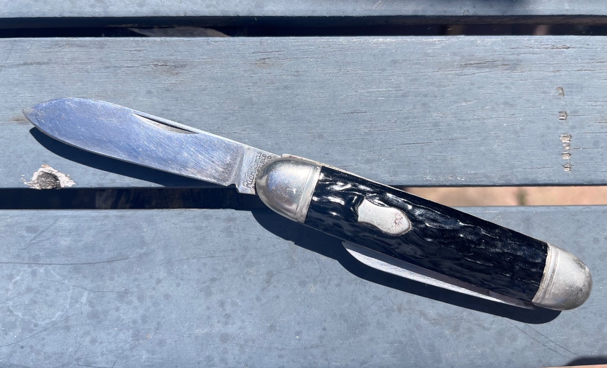

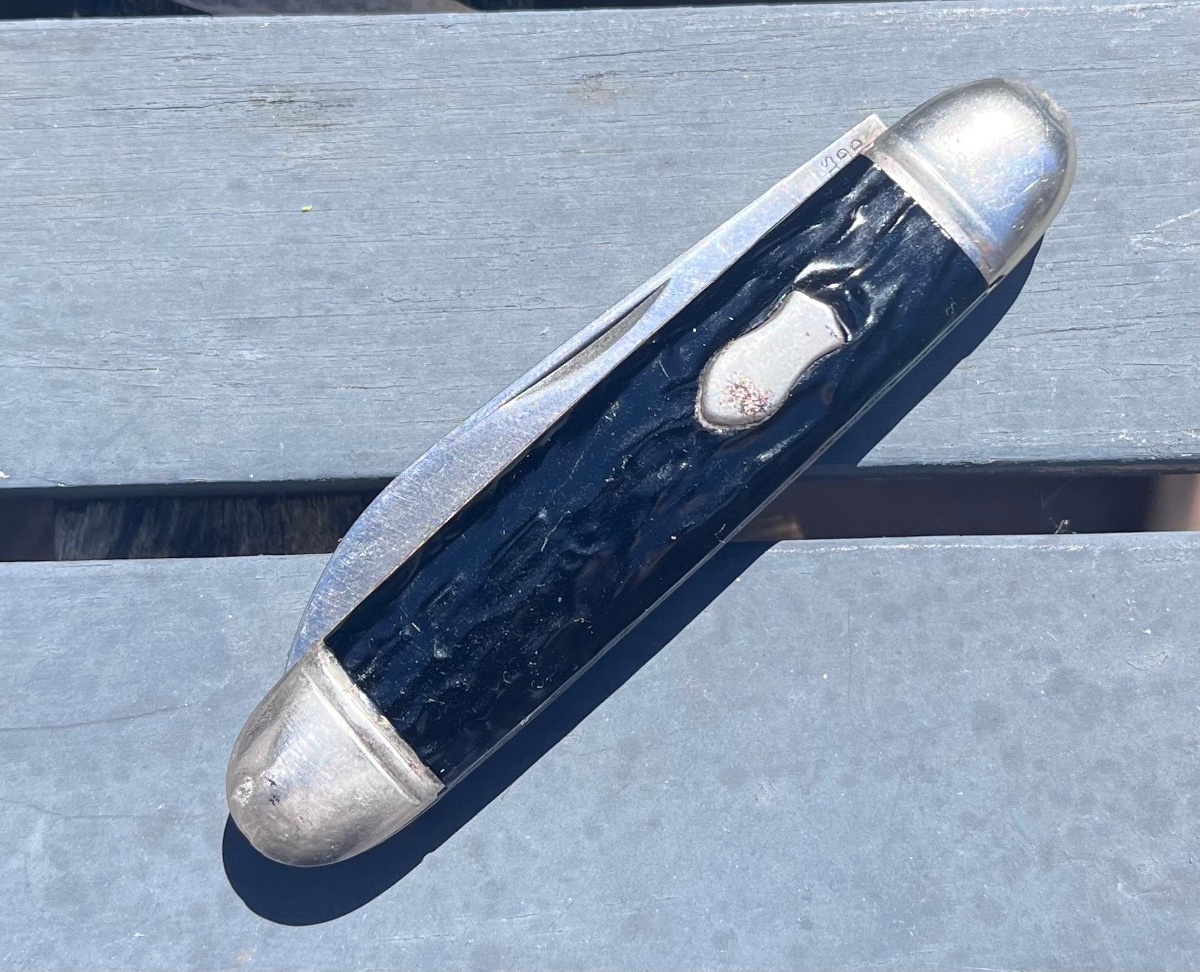

I recently picked up an old Richards pocket knife with the intent of restoring it - my first time doing so.

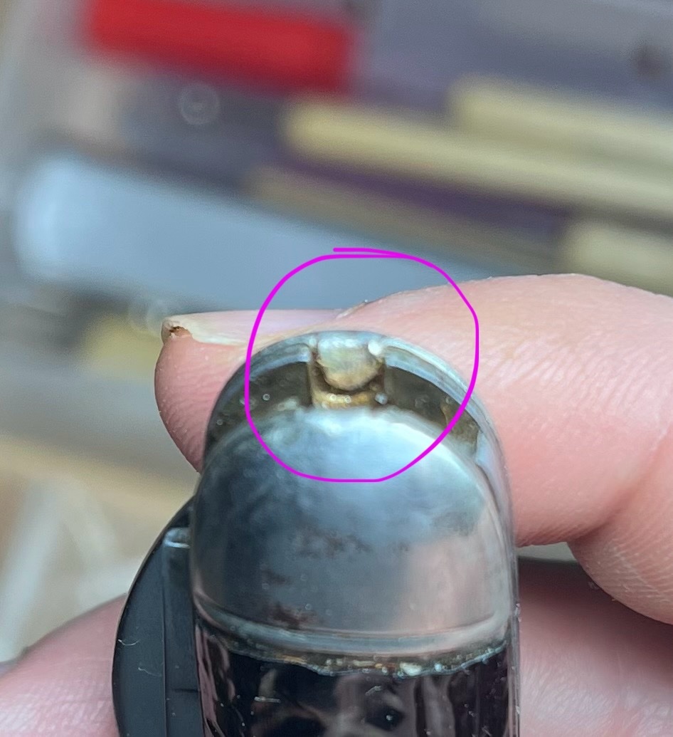

Problem one is disassembling it to give it a good clean. However, removing the grips is tricky as I need to lift up the small tabs. Has anyone else had to do something similar, or know of a method which could work?
Thanks!

Welcome to AAPK. You did not show pictures of the entire knife but it’s probably not necessary to remove the covers to just clean a knife. A whole lot of cleaning can be done without any disassembly!
If you are determined it’s necessary to remove the covers, a search of the forum for the keyword “tabs” is a good way to find the info you’re seeking. That will lead you to several posts/tutorials including this video from one of the resident knife mechanics, Reverand, who are members here.

A small sharp flat screwdriver will lift the tab.
You must realize these tabs were not meant to ever be bent after the handles are installed. If you are lucky, it won't break and you can reinstall it.
More than likely, the tab WILL break-and you can't easily reinstall the handle.
There is no need to remove the handles to clean the knife.

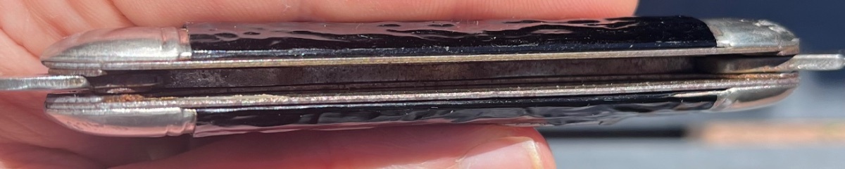

I do have another reason for wishing to disassemble the knife - and that’s to try and fix the wobbly blades, as they often won’t close in the correct position. As I understand it this will mean replacing the pins - I’ve watched a few videos on how to do this already, but would still be happy to hear any advice.

Everyone has steered you correctly so far.
I use a small flat-blade screwdriver to bend the tabs, but ai bend them as little as possible. If you bend them all of the way up they will break. If you just bend them outward a little you can usually work the scales off and back on again with no damage, unless you try to remove them 3 or 4 times.
