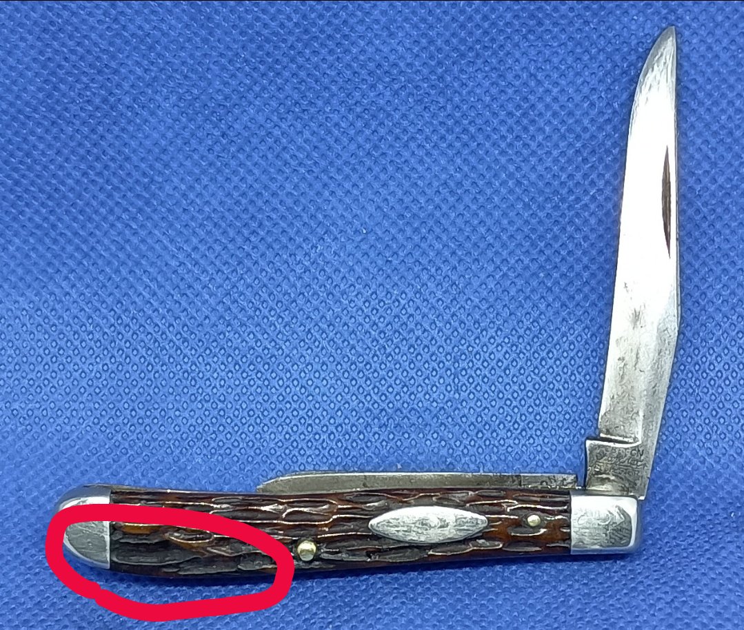

I am in the middle of editing a video showing how to do it, if you can wait until this weekend. I should have it ready to post by then. Here is a picture of this patch:
I prefer powdered pigments over liquid pigments.
I have sanded Walnut wood for dark brown pigment, and used Cinnamon (from my wife's spice rack) for reddish-brown.

My video is set to be released this weekend , but I will give you a sneak-peek...
https://youtu.be/c2wNB6kWWZE?si=Rb3phJK684jaYh7p

Nice video. Thank you for sharing. Great way to put some more life in an old knife.

Re: Patch material
Thank you for saying that Jeepergeo, but this was pretty much that easy. I edited it for time, but little else.Jeepergeo wrote: ↑Sat Aug 31, 2024 8:30 pmYou made it look easy, but I know it's not. Thank you for the video lesson.Reverand wrote: ↑Thu Aug 29, 2024 1:54 pm My video is set to be released this weekend , but I will give you a sneak-peek...
This is only the third patch that I have done, so I consider it to be a good beginner level project.
