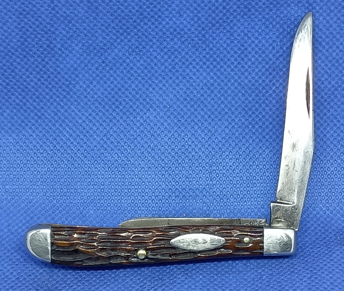

I have used a couple or three different clear epoxies with no problems. Even the Gorilla Glue type that comes in the double syringes - it is inexpensive and locally available.
I prefer powdered pigments over liquid pigments.
I have sanded Walnut wood for dark brown pigment, and used Cinnamon (from my wife's spice rack) for reddish-brown.
I am in the middle of editing a video showing how to do it, if you can wait until this weekend. I should have it ready to post by then. Here is a picture of this patch:

My video is set to be released this weekend , but I will give you a sneak-peek...
https://youtu.be/c2wNB6kWWZE?si=Rb3phJK684jaYh7p

Thank you for saying that Jeepergeo, but this was pretty much that easy. I edited it for time, but little else.
This is only the third patch that I have done, so I consider it to be a good beginner level project.
