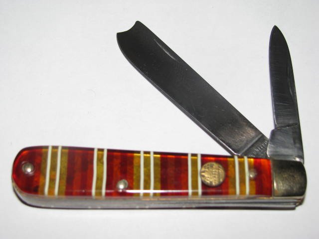

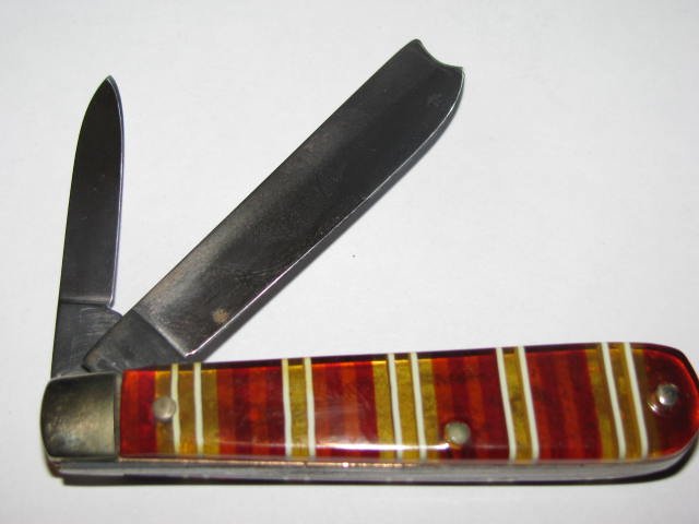

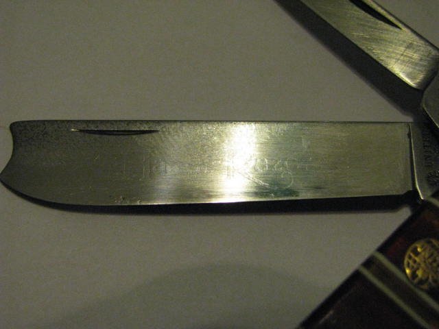

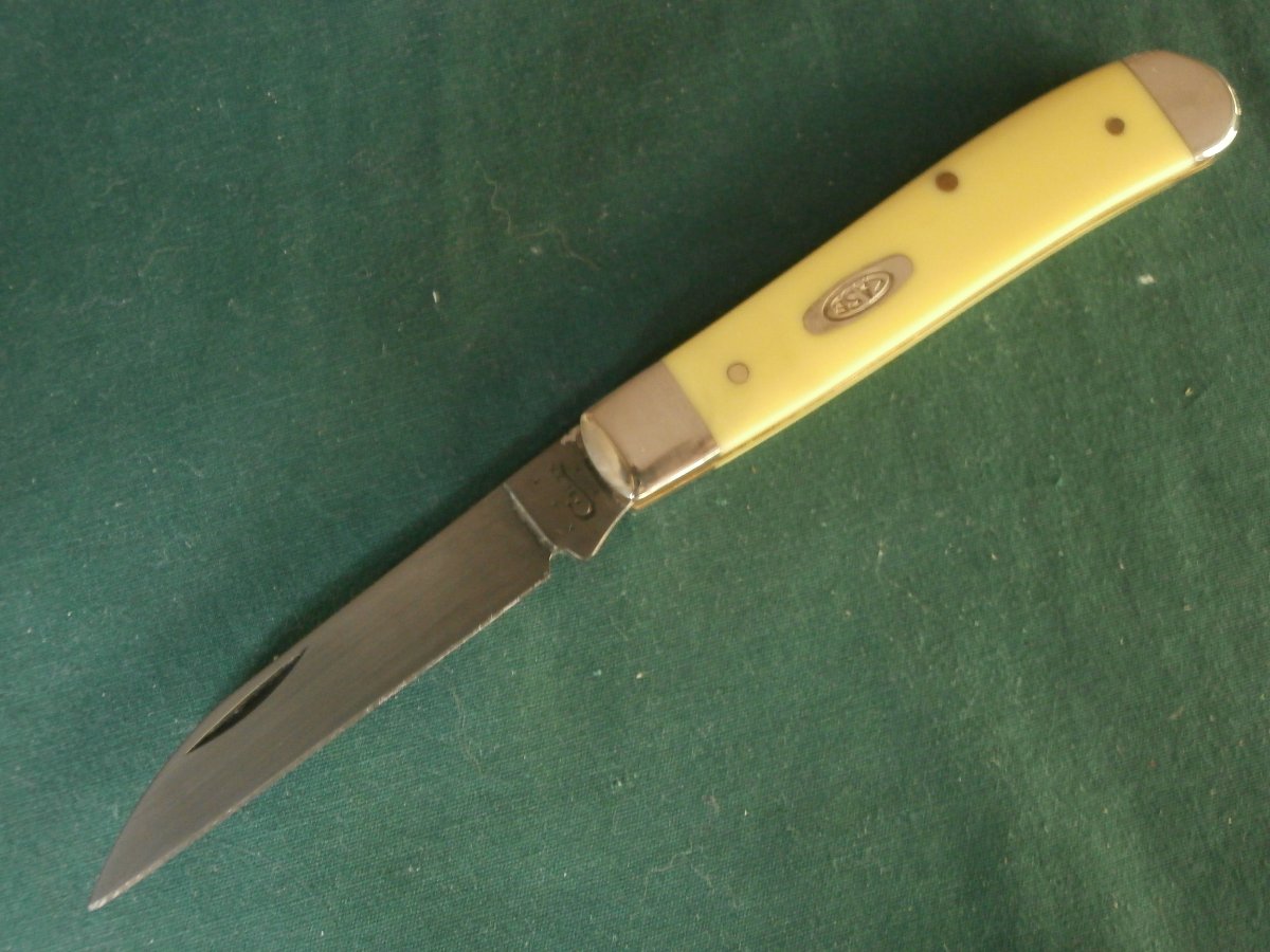

I've only done it a few times because I prefer clean & shiny blades...but, when certain types of steel start spotting, showing signs of corrosion/rust, I use white vinegar because it generally gives a more uniform (i.e., not splotchy or colorful) black patina that looks somewhat similar to TiNi coating. Also, I don't know about other substances used to force a patina, but the white vinegar patina can be easily polished off so the blade can be returned to its original state if so desired.
Here's just one of my knives that I forced a patina on using white vinegar: Case 3107CV I know that Ivoryman has done a lot of experimenting using various substances to force different types/colors of patinas, so hopefully he will chime in and share some of his wisdom.

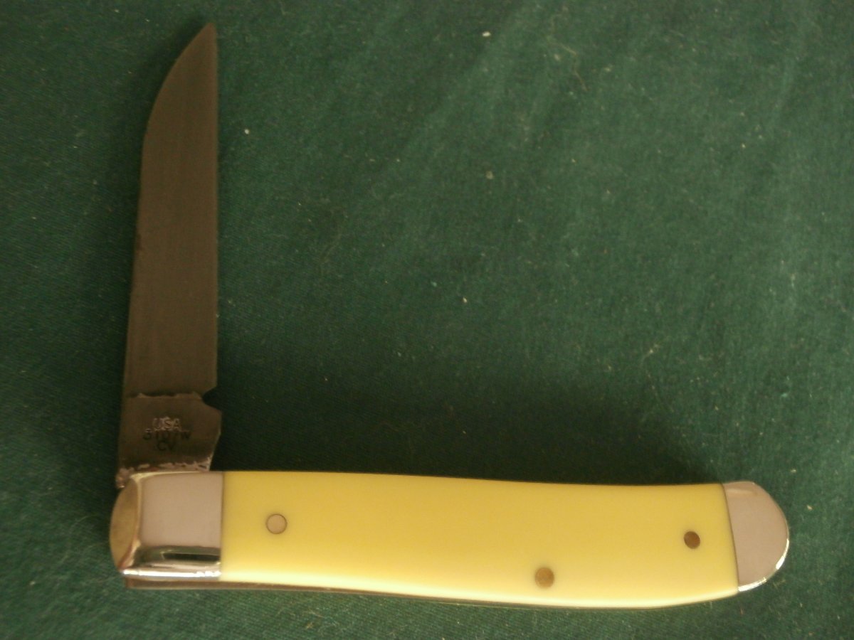

White vinegar soak did a decent job after only about 5 or 6 hours. I recommend putting tape over the bolsters, though, as the vinegar fumes will discolor the nickel silver (although the discoloration did polish out with a little Simichrome).

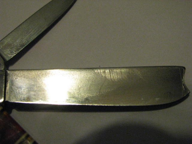

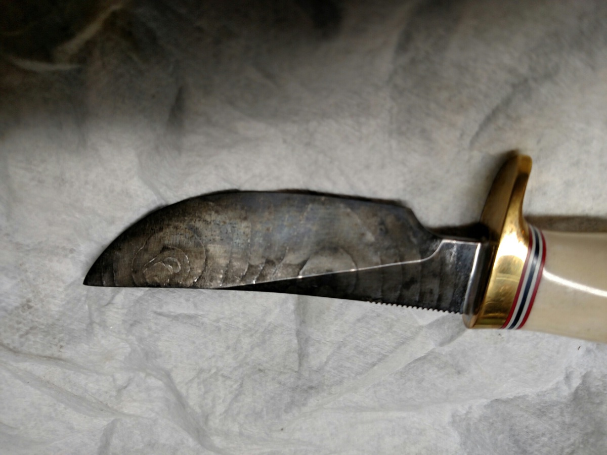

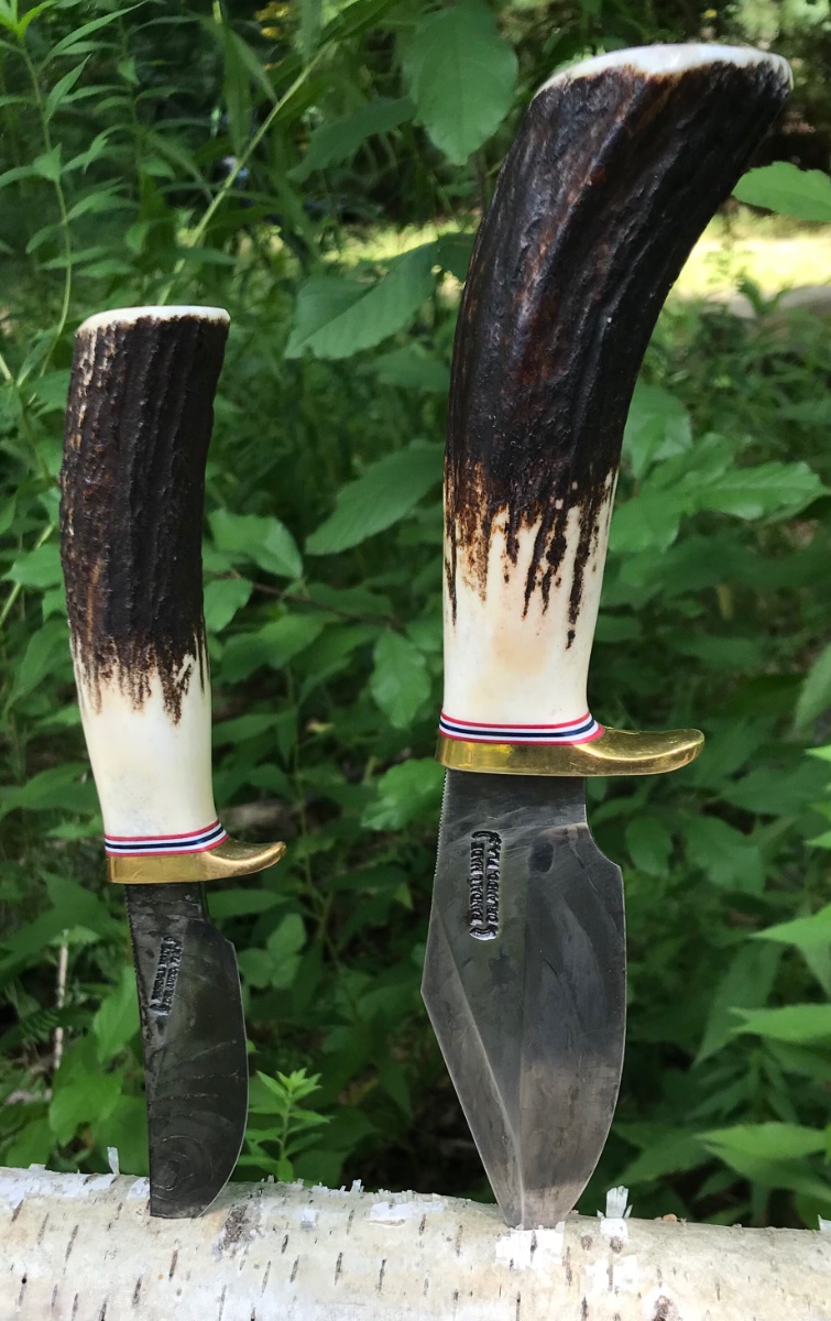

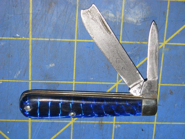

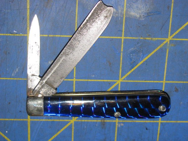

These two I stuck into large onions for a few days.
This one I used to eat corned beef and cabbage with mustard vinegar and horseradish
I like to think I encouraged the patina not really forced.
eveled
- Posts: 2582
- Joined: Sun Oct 29, 2017 9:37 pm
Re: "Forcing" a patina
I used it everyday day for a week it got darker each day.
If you are lucky the onion gives an almost Damascus pattern.

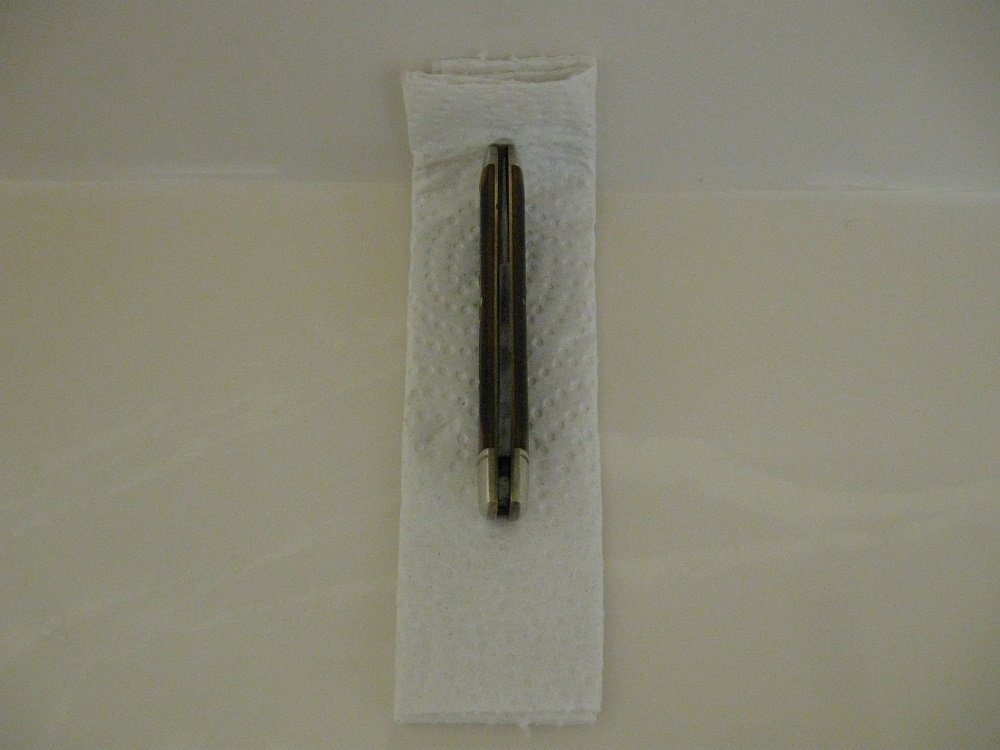

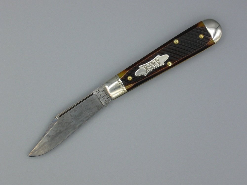

The blade on this one was about a 40 minute soak in a glass of vinegar. I did the back spring too and I think it turned out slightly better than the blade.
Rick T.

The longer you leave it in the vinegar the darker the patina.Railsplitter wrote: ↑Wed Mar 10, 2021 1:05 am The blade on this one was about a 40 minute soak in a glass of vinegar. I did the back spring too and I think it turned out slightly better than the blade.
BTW--How did you do the back spring?
~Q~
- Railsplitter
- Posts: 4212
Yeah, the vinegar kind of played a little trick on me. I wanted the blade slightly lighter in color. I pulled it out of the glass when I thought it looked just right but it looked lighter while submerged than it actually was.
Here's an example of how I did the back spring. The paper towel in the photo is dry but when I actually did this I used a vinegar soaked paper towel. The splash guard on my bathroom sink helped ensure that the curve of the back spring at the butt end got treated too.
Rick T.

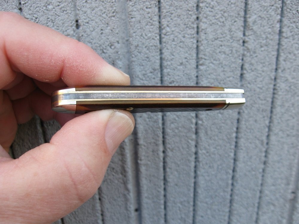

PS--Did the vinegar discolor the liners or edges of the bolsters?

eveled, are those mini-Randalls that you are giving a patina ?
kj
kj
- Railsplitter
- Posts: 4212
I'm looking at the knife right now and the liners look just like they look in my picture. I posted it again below so you don't have to jump back a page to see it.
I honestly don't know if that yellowish tint on the bottom liner was there before I started or not but I didn't do anything special to the liners. Just wiped them off with a damp rag and then a dry rag to remove the vinegar. I did use some simichrome polish on the bolsters but they weren't bad. Had to polish the shield too. I must have had some vinegar on my hands that transferred to the shield.

No a full size Model 19 Bushmaster and a full size Model 21 Little Game. They were presents for getting my two plumbing licenses.kootenay joe wrote: ↑Wed Mar 10, 2021 5:20 am eveled, are those mini-Randalls that you are giving a patina ?
kj
Bought 2 years apart but look like a matched set. They compliment each other well. One could carve a hair the other one could open I coconut.
The big pieces of stag make them look off proportionaly.

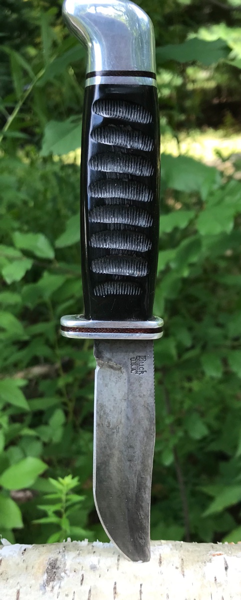

I think everyone has covered this pretty well, but for me slicing tomatoes gives a good, natural patina. I would clean the blades after each use and wipe them with food-grade Mineral Oil. The color becomes more brown and varied, rather than the grey vinegar patina.
Slicing strawberries gave it a darker patina with shades if blue. Very lovely!
I don't know if applying oil every time helped or not, but it appeared to me that it gave the patina a better look.
One meal is enough to establish a good patina. One week of meal prep will make it perfect.
