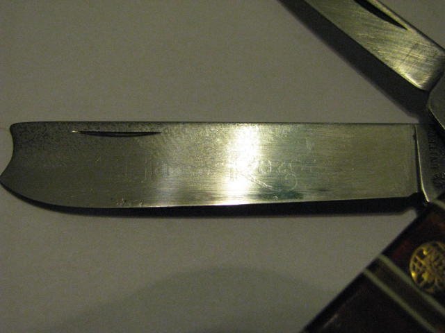

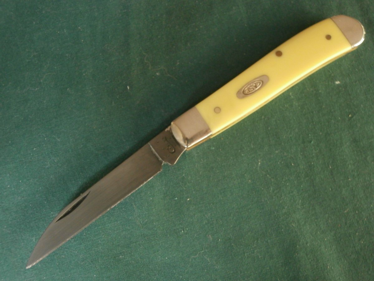

I've only done it a few times because I prefer clean & shiny blades...but, when certain types of steel start spotting, showing signs of corrosion/rust, I use white vinegar because it generally gives a more uniform (i.e., not splotchy or colorful) black patina that looks somewhat similar to TiNi coating. Also, I don't know about other substances used to force a patina, but the white vinegar patina can be easily polished off so the blade can be returned to its original state if so desired.
Here's just one of my knives that I forced a patina on using white vinegar: Case 3107CV
I know that Ivoryman has done a lot of experimenting using various substances to force different types/colors of patinas, so hopefully he will chime in and share some of his wisdom.

White vinegar soak did a decent job after only about 5 or 6 hours. I recommend putting tape over the bolsters, though, as the vinegar fumes will discolor the nickel silver (although the discoloration did polish out with a little Simichrome).

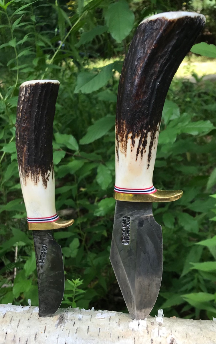

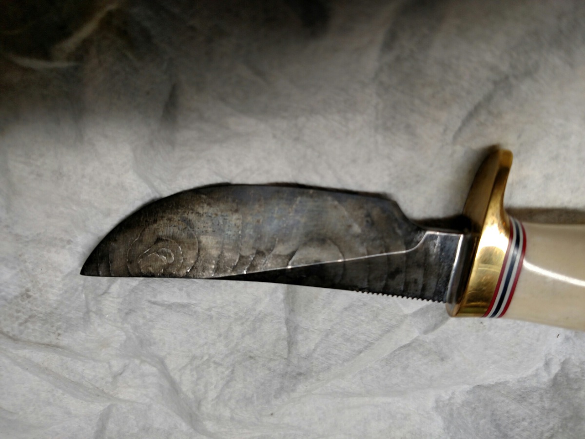

eveled
Posts: 2582
Re: "Forcing" a patina
Post by eveled »
These two I stuck into large onions for a few days.
This one I used to eat corned beef and cabbage with mustard vinegar and horseradish
I like to think I encouraged the patina not really forced.

Posts: 2582
Post by eveled »
I used it everyday day for a week it got darker each day.
If you are lucky the onion gives an almost Damascus pattern.

When using vinegar I heat it in the microwave and only leave the blade in for about 30 minutes.
If left for a week I bet it did eat up the blade.

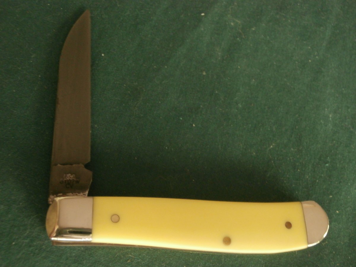

The blade on this one was about a 40 minute soak in a glass of vinegar. I did the back spring too and I think it turned out slightly better than the blade.

Railsplitter wrote: Wed Mar 10, 2021 1:05 am The blade on this one was about a 40 minute soak in a glass of vinegar. I did the back spring too and I think it turned out slightly better than the blade.
The longer you leave it in the vinegar the darker the patina.

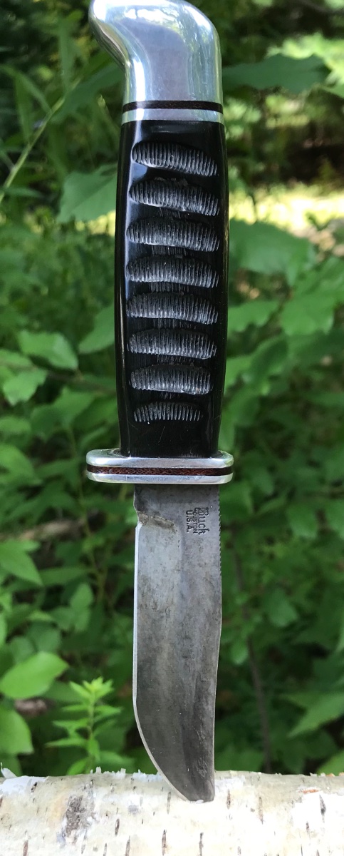

Railsplitter
Posts: 4206
Post by Railsplitter »
QTCut5 wrote: Wed Mar 10, 2021 1:26 am
BTW--How did you do the back spring?

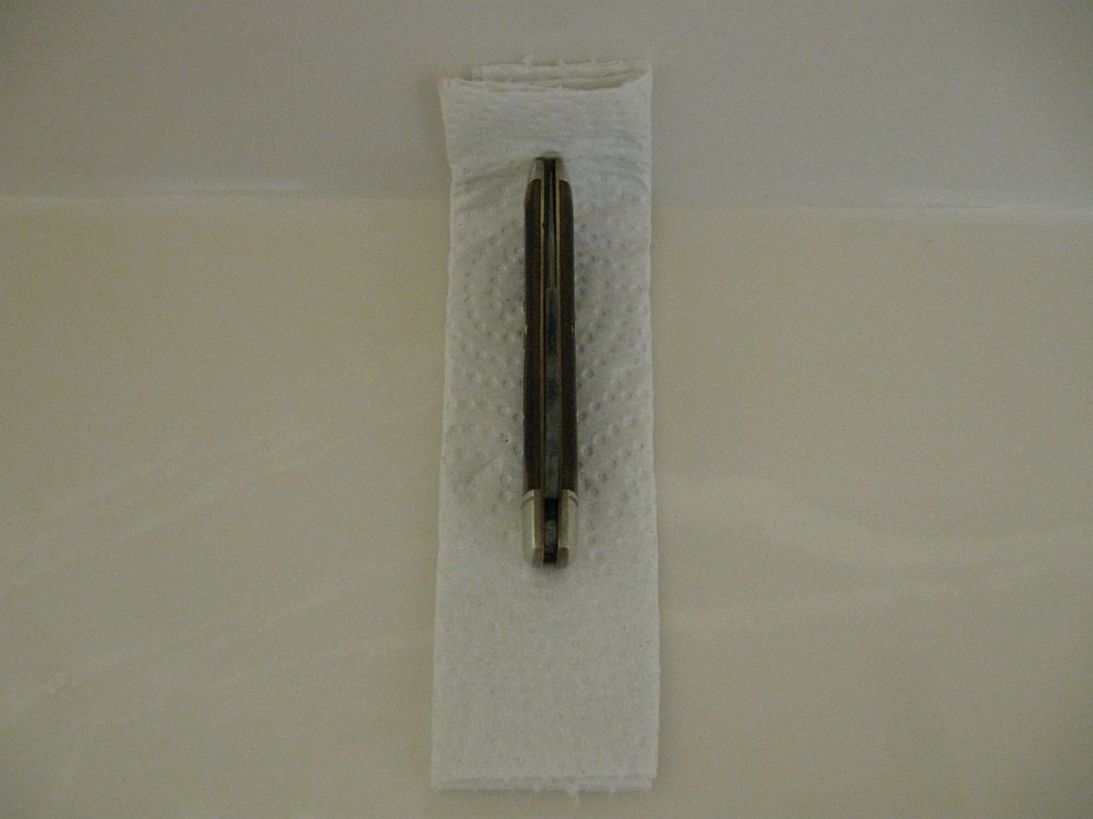

Yeah, the vinegar kind of played a little trick on me. I wanted the blade slightly lighter in color. I pulled it out of the glass when I thought it looked just right but it looked lighter while submerged than it actually was.
Here's an example of how I did the back spring. The paper towel in the photo is dry but when I actually did this I used a vinegar soaked paper towel. The splash guard on my bathroom sink helped ensure that the curve of the back spring at the butt end got treated too.

Railsplitter
Posts: 4206
QTCut5 wrote: Wed Mar 10, 2021 1:57 am That's clever...I'm going to try that.
Thanks, Rick. ::handshake::
PS--Did the vinegar discolor the liners or edges of the bolsters?
I'm looking at the knife right now and the liners look just like they look in my picture. I posted it again below so you don't have to jump back a page to see it.
I honestly don't know if that yellowish tint on the bottom liner was there before I started or not but I didn't do anything special to the liners. Just wiped them off with a damp rag and then a dry rag to remove the vinegar. I did use some simichrome polish on the bolsters but they weren't bad. Had to polish the shield too. I must have had some vinegar on my hands that transferred to the shield.

eveled
Posts: 2582
Post by eveled »
cudgee wrote: Wed Mar 10, 2021 1:23 am
eveled wrote: Wed Mar 10, 2021 12:41 am I used it everyday day for a week it got darker each day. CD7777AD-B00C-4D45-886F-2F304CB791F0.jpeg
Nice slab of corned beef. ::sotb:: ::sotb:: ::sotb:: ::tu::
Thanks, I think about that meal every time I use that knife. Only a week until St Patrick’s day, I cook it outside in a 5 gallon stainless steel pot, at least 4 roasts, (2red 2 grey) sometimes a pork shoulder too. two cabbages a bag of onions a bag of carrots.
Call me crazy but when a knife gets a patina on a meal like that, it imparts a positive energy into a blade that a paper towel and vinegar can’t deliver.
eveled
Posts: 2582
Post by eveled »
kootenay joe wrote: Wed Mar 10, 2021 5:20 am eveled, are those mini-Randalls that you are giving a patina ?
kj
No a full size Model 19 Bushmaster and a full size Model 21 Little Game. They were presents for getting my two plumbing licenses.
Bought 2 years apart but look like a matched set. They compliment each other well. One could carve a hair the other one could open I coconut.
The big pieces of stag make them look off proportionaly.

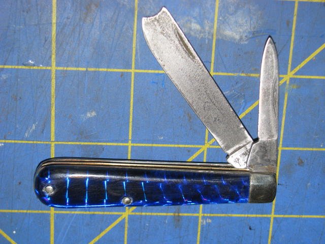

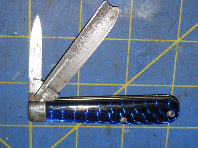

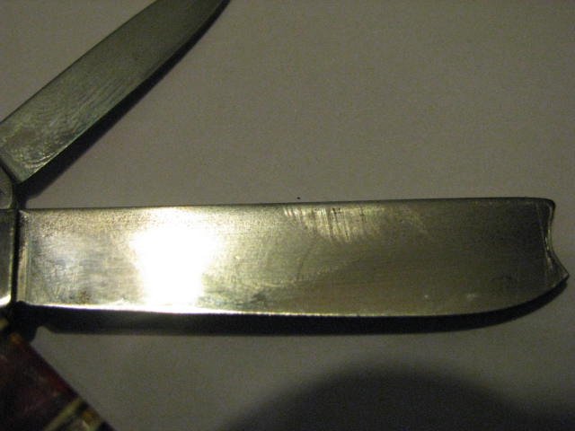

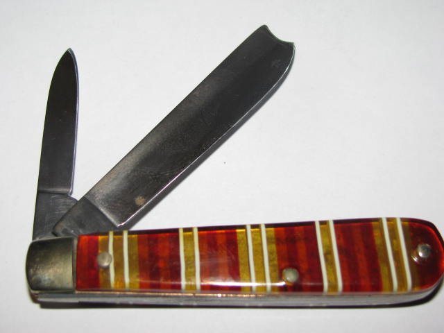

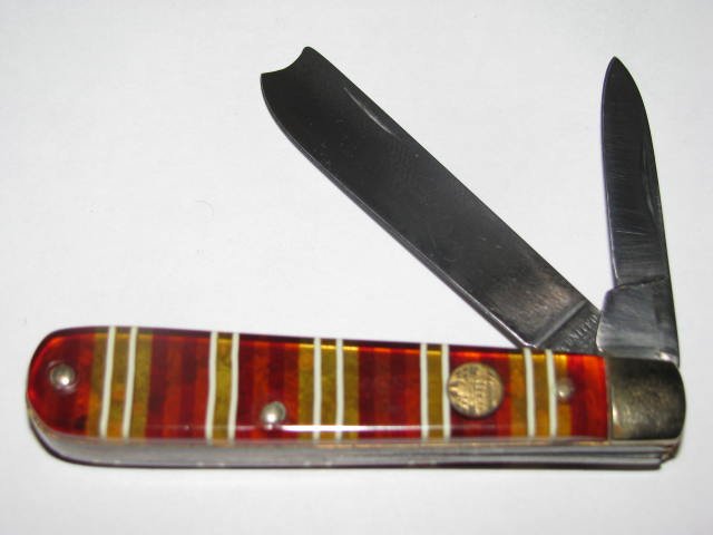

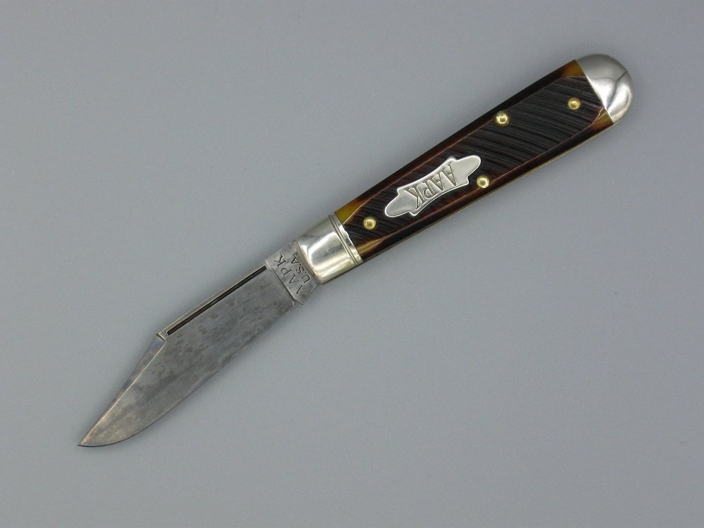

Truth be told I forgot about it! ::dang:: The handles were off(they were the reason I decided to patina it)and when I did take it out it was eaten up pretty bad.Still usable though.Here are a couple pics of it before and after.The original handles deteriorated on the liner side and didn't even show on the top side.
