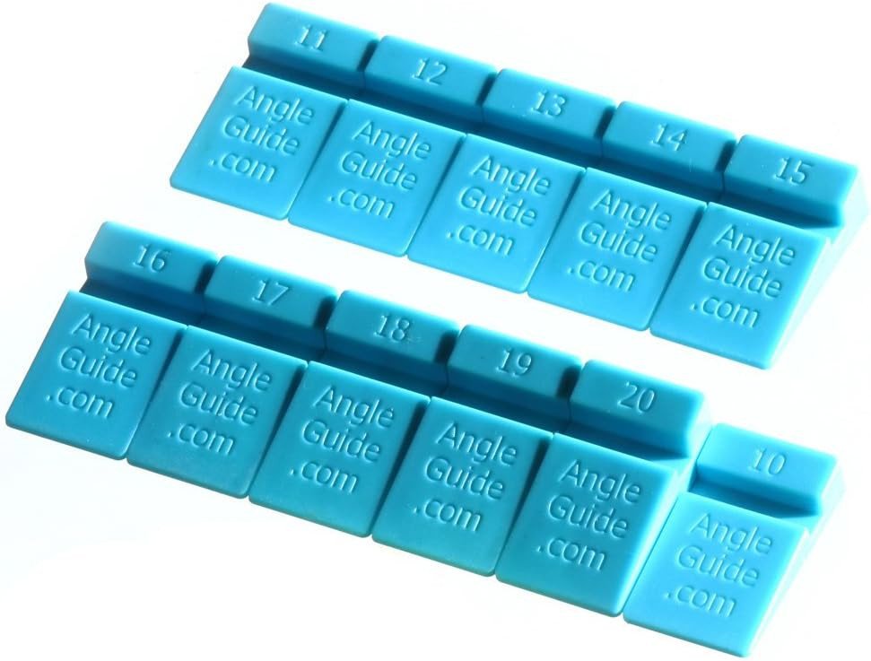

If you are looking at holding a consistent angle on a sharpening stone, I am a huge fan of the Wedgek Angle Wedges. You set the guide on the stone, you can even secure it with a rubber band. Next, you place the knife on the wedge to set your angle and you are good to go….. or are you?

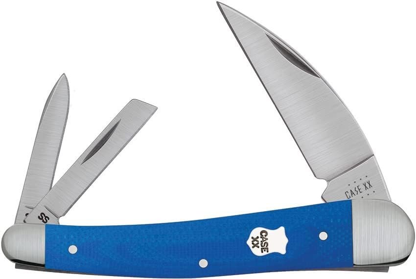

Some knives have a full flat section on which to rest the blade when setting the angle, but many do not; for example, look at the blades on this Case Seahorse Whittler.
I did not measure any angles from the factory, but… The factory blade has a long bevel to the spine around 10° with the secondary bevel near 27°; so about 17° between the primary and secondary.
Without thinking, I placed the blade onto a 13° wedge, which created a secondary bevel near 23°. Again, without thinking, I used my Spyderco Sharpmaker to set a 15° angle but it was not getting sharper because I was removing metal far from the edge.
The only available reference surface is already at 10° so I need a reference angle near 3° to get a 13° final angle.

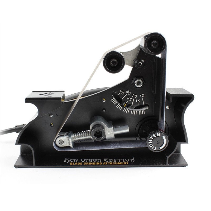

Where else do you need to worry about your reference angle? One of my favorite sharpeners is the Work Sharp sand paper belt sharpeners, I own a couple versions. The Ken Onion version with the Blade Grinding attachment has a flat reference surface. The idea is that you set your blade on the reference surface and then hold that reference to get the angle set on the attachment.
https://www.sharpeningsupplies.com/Work ... 31C68.aspx
This is a potential problem with most systems where you are trying to actually measure your angle. The Wicked Edge Precision sharpener looks like it should not have this problem, especially if you are using an angle measuring guide on the bars, someday I will have one to test perhaps. I also do not see this as a problem with the Tormek system that I use, but I have not tried their machine specific to knife sharpening.

Curious if you (or anyone else) has tried the versions with a stand that sits off the end of the stone and elevates the angle portion so you do not need to have it sitting on the stone.
https://www.amazon.com/Wedgek-Angle-Gui ... B08L5D67GD
https://www.wedgek.com/
And two images taken from Amazon
pitonyak
- Posts: 45
- Joined: Mon Jul 24, 2023 2:11 pm
- Location: Ohio, USA
Re: Sharpening angles with a reference surface
Side note about the set I show above with a tall portion. These only come with four of the primary blue angles. It is expected that you will use the base portion to add or subtract 1 degree as needed by the direction you use the blue base (if you use the blue base). Tricky.

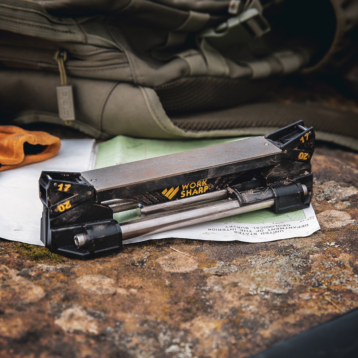

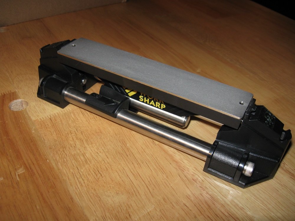

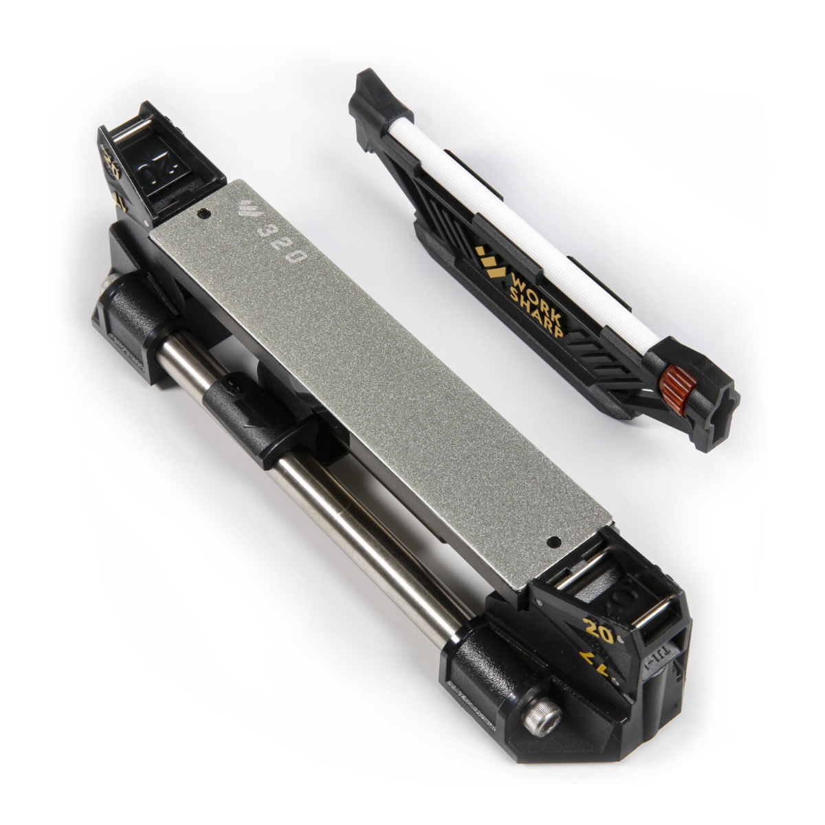

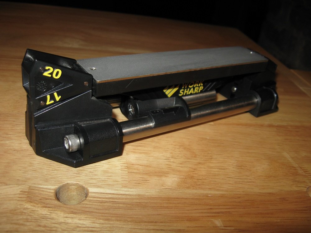

The WorkSharp Guided Sharpening System uses what appears to be the same principle. I have found it to be everything I need. The drawback I see for those who are anal about setting precise angles are that it’s essentially a free-hand system with angle reference “guides”, and the base system comes with only 17° and 20° guides. (There is an optional upgrade kit which includes a 25° guide and other diamond plate grits). The guides help establish the angle but there are no clamps that force maintenance of that angle - it’s on the user to maintain the angle during the “stroke” across the surface of the diamond plate.
Personally I find clamps unnecessary, cumbersome and a PITA, but that’s just my opinion. IMHO the system is a good aid to those needing a little assistance with finding a sharpening angle, but also a great set of diamond plates with a stand for mounting and holding them during use. The plates and the guides are held in place by magnets, making for easy changes. If you’re a free-hand sharpener, or wanting to learn free-hand sharpening, this could be a good tool for you. In fact I’d recommend it for both novice or experienced sharpeners. It’s also not expensive relative to some other “systems”.
- Railsplitter
- Posts: 4191
I use the same model for edge maintenance. I found that I only needed the guides the first 3 or 4 times that I used it. After that, my muscle memory developed and I haven't needed the guides ever since. Great product.Mumbleypeg wrote: ↑Tue Aug 15, 2023 11:25 pm The WorkSharp Guided Sharpening System uses what appears to be the same principle. I have found it to be everything I need. The drawback I see for those who are anal about setting precise angles are that it’s essentially a free-hand system with angle reference “guides”, and the base system comes with only 17° and 20° guides. (There is an optional upgrade kit which includes a 25° guide and other diamond plate grits). The guides help establish the angle but there are no clamps that force maintenance of that angle - it’s on the user to maintain the angle during the “stroke” across the surface of the diamond plate.
Personally I find clamps unnecessary, cumbersome and a PITA, but that’s just my opinion. IMHO the system is a good aid to those needing a little assistance with finding a sharpening angle, but also a great set of diamond plates with a stand for mounting and holding them during use. If you’re a free-hand sharpener, or wanting to learn free-hand sharpening, this could be a good tool for you. It’s also not expensive relative to some other “systems”.
