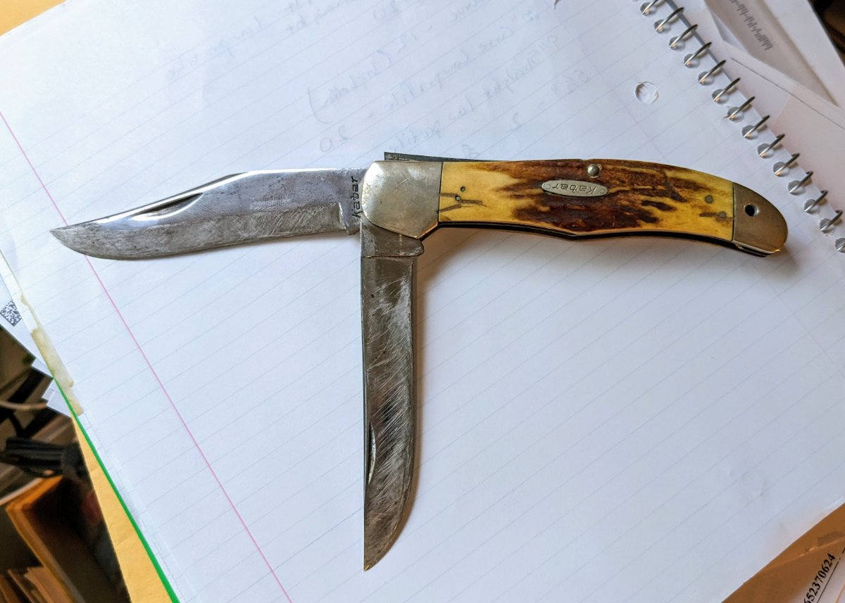

Good morning. New member with first post. Looks like a great group. Look forward to learning from you.
This Ka-Bar hunter is the knife that brought me to the forum. This is my first Ka-Bar knife so I wanted to learn a bit about its history. I found some good info online, but when it came to determining the age I came up a bit short. Based on what I was able to find on tang stamps, this seems to be from the 1950s, but this exact stamp wasn't listed on the charts I found. Just Kabar with no star or other markings. It has a real stag handle.
I also found it interesting how the bolster was "matched" to the antler and the flaws in the handle were filled. I assume this was done by craftsman at the factory??
Thanks, Mike

Hi, first off, welcome to the forum! Your good looking Kabar was made between 1952 and about 1967. There is no way of getting a closer date, nobody back then cared when a knife was made. The mark changed from KA-BAR to Kabar in 1952 but I'm sure the change didn't happen instantaneously on all models. Cole National bought KA-BAR Inc in 1966 and around 1968 they started to have the model numbers of the knives stamped on the blades. I also don't think this happened all at once for all models. Regarding the fitting of the bolsters, I believe what you are seeing is caused by pocket wear and use. Or possibly done by a previous owner, the factory did not have a guy sit there and do it to every stag knife they made.

Hi Gunsil, Thanks for taking the time to respond and share your knowledge.
Regarding the bolster, it must have been a previous owner. Some of the cuts appear machined with angular edges rather than something worn over time. It did seem a bit labor intensive for a mass-produced knife.

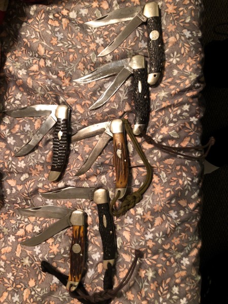

Ha! Thanks for the Compliment! Here are a few Hunters that are always in my rotation besides my other Ka-bars.Madmarco wrote: ↑Tue Apr 25, 2023 8:49 pmto AAPK, Mike!
