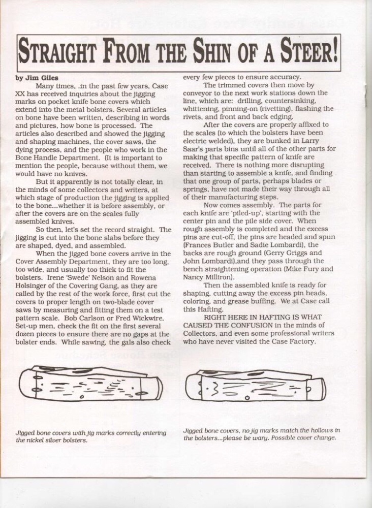

I can’t tell for sure from your pictures but in regards to the handle cover-to-bolster interface: there is a phenomena that occurs during hafting, and typically manifests in places where the stag or bone has areas where natural indentations from stag “bark” grooves (or bone jigging) is adjacent to the bolster. In those places the bolster often has a sunken area. Case’s term for this is “sucking out” of the bolster material. It occurs during hafting, and is caused because the nickel silver in the bolster is softer than stag or bone. In those areas the hafting wheel removes material from the bolster corresponding to any natural indentations in the covers.
Below is an article from an old Case Collector’s Club magazine that explains it better than I can. Click the picture to enlarge for easier reading.
P.S. An unrelated item of note from the article is where the author says “After the covers are properly affixed to the scales (to which the bolsters have been electric welded)”. On most pocket/folding knives the “scales” are the metal liners next to the blade. Too frequently what are actually “covers” (aka handles) are mistakenly referred to as “scales”. Scales are the part closest to the blade, not to be confused with “covers”, which on most pocket knives are affixed by rivets or glue to the scales. The confusion comes about from fixed blade knives where the cover/handle may likely be next to the blade’s extension into the handle. In which case the “cover” is in fact also the “scale”.

I do have a question though. What was meant by the term “whittening”?

Refers to use of something called a "whitening stone" which is a very fine grit finishing stone used by cutlers for sharpening or polishing. The operation is apperently called "whitening" at Case, maybe at other cutleries also. Maybe one of the cutlers here like Eric Albers can explain better. That article is probably 30 or 40 years old, not sure whether Case still does “whitening” the same way today.
I think its misspelled in the article. Should have only one "t" as far as I know.

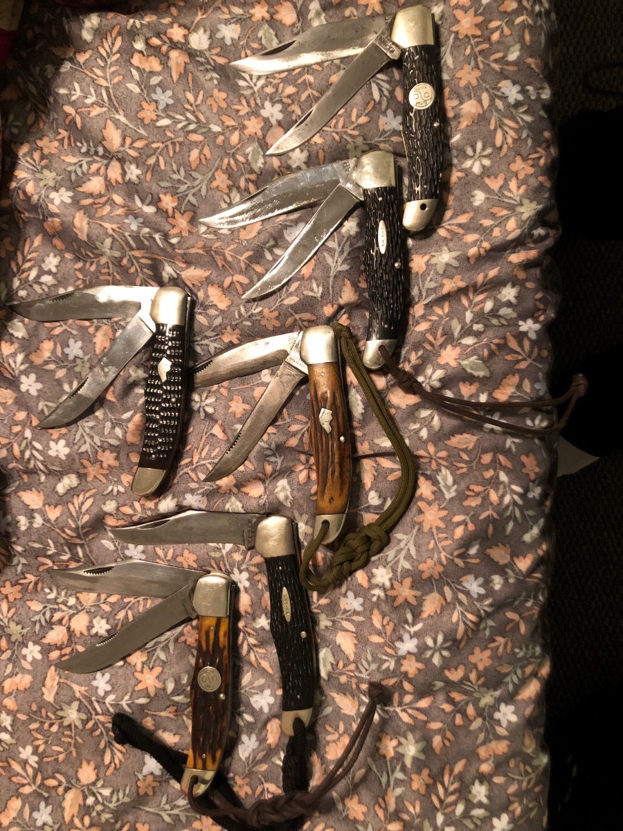

Ha! Thanks for the Compliment! Here are a few Hunters that are always in my rotation besides my other Ka-bars.Madmarco wrote: ↑Tue Apr 25, 2023 8:49 pmto AAPK, Mike!
