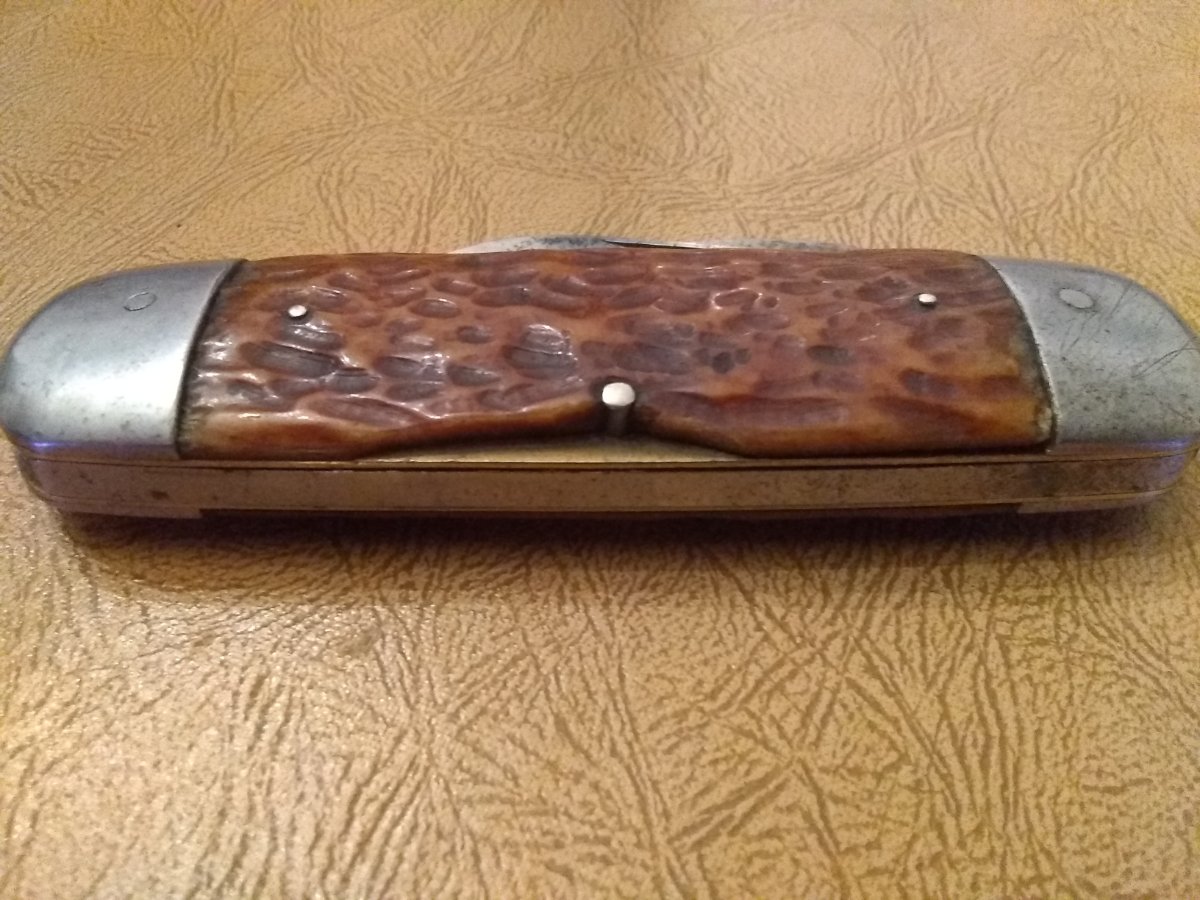

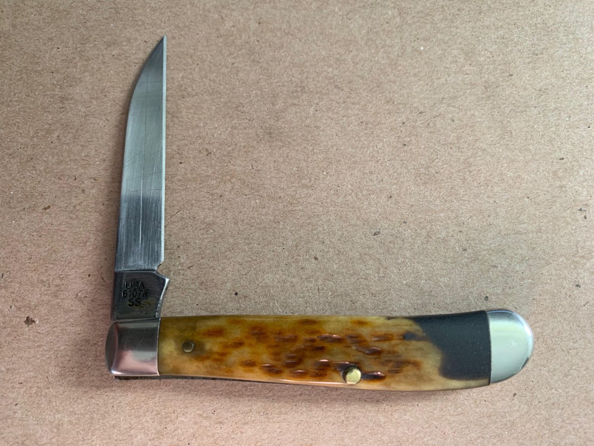

Here is an unusual question! I have an old knife I may buy from a co-worker. There is already a photo of it on another thread I opened that some of you are assisting me with, but attached is a closeup photo of my problem. As you can see, there is a chip by one of the knifes rivets or pins. Is there a way to fix this so the chip will not get larger over time? Replacing the scales would be out of the question since this knife is real old. I was thinking about putting a real small drop of clear gorilla glue in the chipped spot to kind of "fill it in".

i use a 2 part thick epoxy paste called PC7 that can be found at any homecenter. Heres a repair using PC7... it's hard and stable - fine for a working knife - but if you're trying to mask it so the repair isn't visible - thats an entirely different thing that would involve detailed bone patchwork.

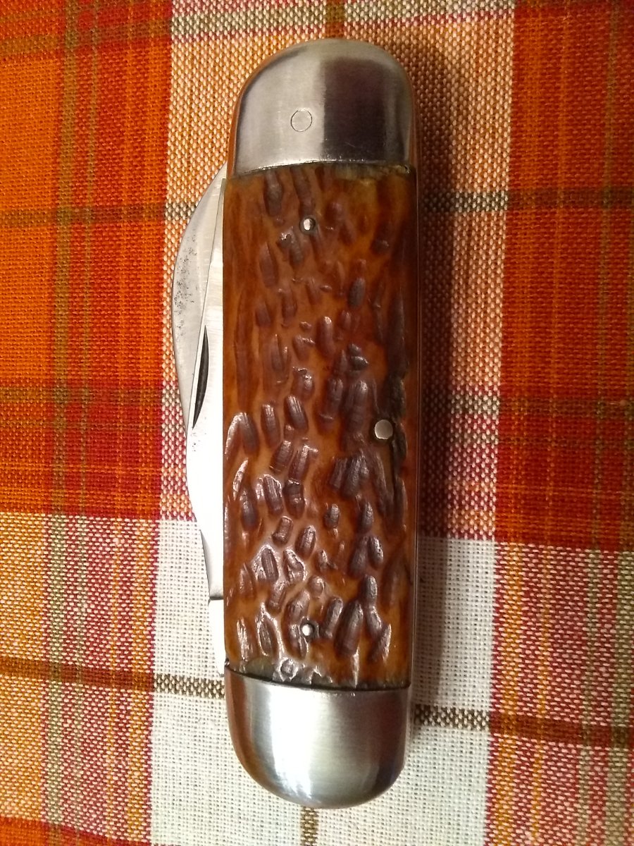

This was done with two part epoxy as described in the thread.

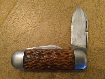

mikekoz
Posts: 156
Joined: Mon Jan 01, 2007 10:04 pm
Re: Can a chipped scale be repaired?
Post by mikekoz »
Reverand wrote: Tue Jan 21, 2020 2:04 am Doc is right, the Acraglas repair is the way to go, unless you can find a replacement scale off of an old parts knife. Finding one that matches can be nearly impossible though.
One favor: Show us some more pictures of the complete knife. We LOVE seeing old knives, and you never know if someone else has a scale that will fit it!
Attached is the whole knife in all of its glory! Great information here. My thoughts are I just want to fill in this small chip to keep it from getting larger to preserve the knife. I do have some two part epoxy. The Agraglas repair looks amazing. I never knew anything like that existed. The examples of the other repairs you all have done on breaks a lot larger than this knife I have, are also outstanding. I really appreciate all of this information!! ::tu:: ::ds::

That is a good knife. I love the glow from old pocket-worn bone! There is nothing else quite like it!
