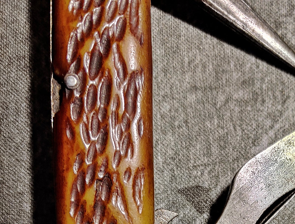

Here is an unusual question! I have an old knife I may buy from a co-worker. There is already a photo of it on another thread I opened that some of you are assisting me with, but attached is a closeup photo of my problem. As you can see, there is a chip by one of the knifes rivets or pins. Is there a way to fix this so the chip will not get larger over time? Replacing the scales would be out of the question since this knife is real old. I was thinking about putting a real small drop of clear gorilla glue in the chipped spot to kind of "fill it in".
What do you experts say?? :D

Yep...here's a good thread... Nice bone on that one, by the way! ::tu:: ::tu:: ::tu::
viewtopic.php?f=37&t=57370&hilit=acraglas+repair

Doc is right, the Acraglas repair is the way to go, unless you can find a replacement scale off of an old parts knife. Finding one that matches can be nearly impossible though.

The link shown is one I started to encourage others to try the procedure. I have fixed quite a few that were even worse than yours and they all turned out good. Color matching is the hardest part, but if it isn't exact, no biggie. And yes, I want to see the finished project too.

Acraglas is pretty expensive. I have used dollar store two-part epoxy. Mix it, let set until it thickens a little, then dab on the broken area. Came out OK, you have to look closely to notice the repair.

I also use 2 part epoxy for patch type repairs. Getting color right and jigging matched can be an involved process. Darker color bone is easier to match in my experience. The knife posted shouldn't be too much problem due to the small size. Larger patches can be more difficult.

i use a 2 part thick epoxy paste called PC7 that can be found at any homecenter. Heres a repair using PC7... it's hard and stable - fine for a working knife - but if you're trying to mask it so the repair isn't visible - thats an entirely different thing that would involve detailed bone patchwork.

I haven't tried this but if you can find another piece of similar bone you can grind up some to mix with the epoxy.

You can use instant coffee as a tint, in epoxy, for the browns...or charcoal, for blacks.

I don't think there would be any advantage to that. Probably would not as strong as unadulterated AcraGlas or epoxy. If used to try to match color, AcraGlas dye pack color or a tiny bit of acrylic craft paint color would be better and easier to control. The Acra Glas kits come with brown and black dye packs to tint the mixture. A tiny amount on the end of a toothpick is all it takes.

WD40 is good for cleaning...but a little heavier oil, on the joints, provides better lubrication. Like 3 in one oil or mineral oil. The patina is protective and most people prefer leaving it on an old knife. Also...The way the chip broke out...I don't think you have to worry much, about it getting bigger. It's relatively common for that piece to break out, with the location of that pin. The "Search" feature is located in the "Quick Links"...there are threads on various ways that people like to "clean" old knives.
