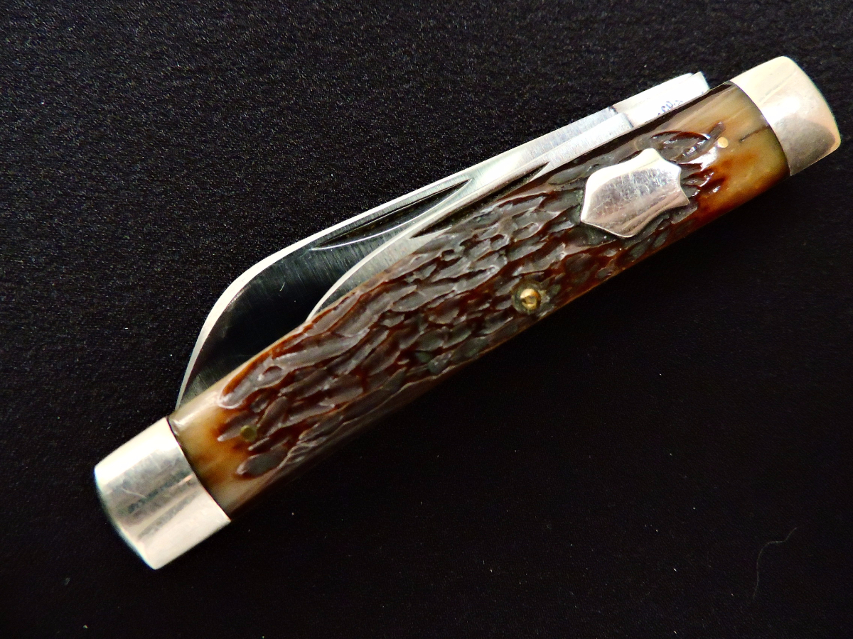

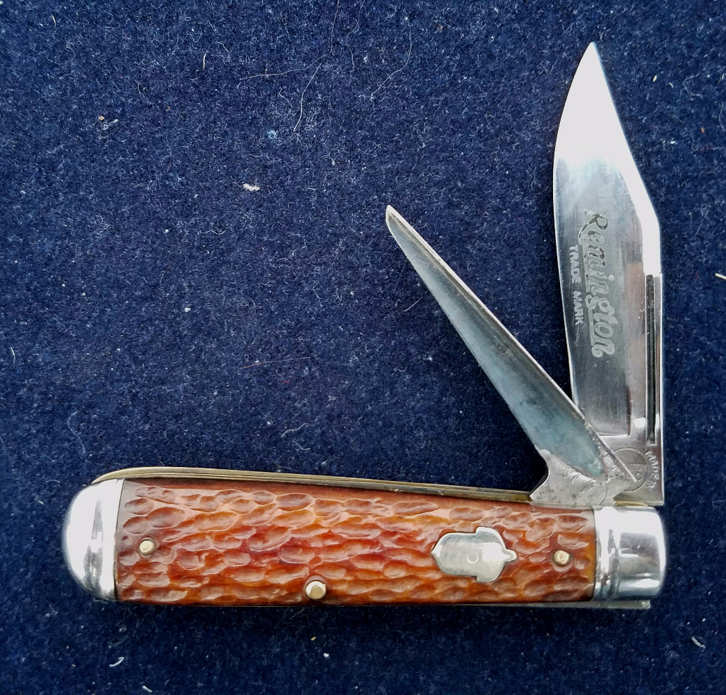

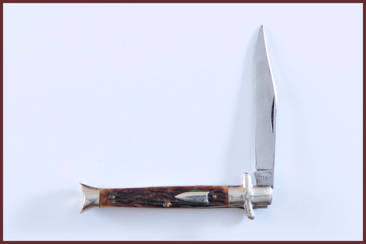

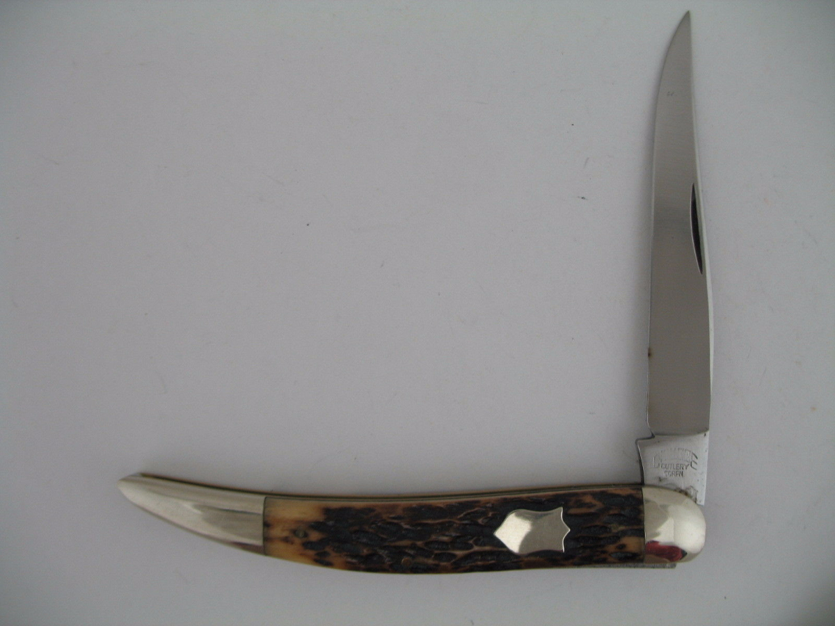

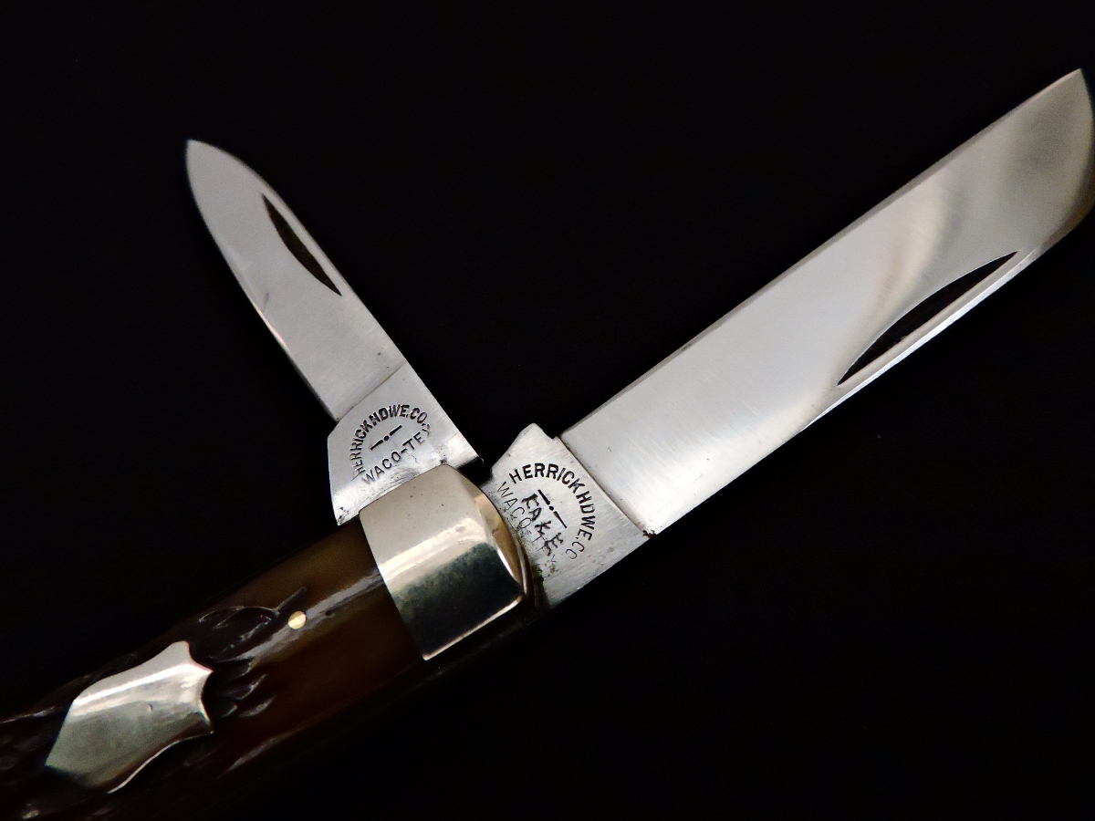

If you were to take the time to go though all the postings in this forum you might come up with a common denominator. That being there are several patterns of pocket knives that are often counterfeited and that in my mind always deserve a closer look to determine authenticity.
These knives are not cobbled reworks but newer factory made knives that have tang stamps of old brands or sometimes obscure and even non-existent companies. In most all cases these knives are in mint or very near mint condition. They look new because they are new.
Many collectors are aware of this but I am making this post hoping that it may save someone the heartache and trouble of purchasing of a counterfeit knife. Please note that these are all legitimate patterns of old collectible knives but they are patterns that all too often come up as fakes.
I have provided a fake example of each of these patterns for reference. In no particular order.
1. Cotton sampler knife.
2. Fishtail jack knife.
3. Eureka jack knife.
4. 4 1/4" single blade toothpick knife.
5. 2 Blade congress jack

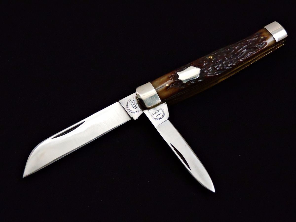

Post by FRJ »
Good informative post, Wayne.
By golly, I didn't let that 2 blade congress jack get past me. ::facepalm::

Joe, I always admire your taste in knives with this one exception.
Herrick would be a true but obscure brand stamp and this is typical of many of these commonly counterfeited patterns. If there are no known examples for comparison the fakers are free to paint on a blank pallet and come up with whatever bone jigging, shields etc. they want.

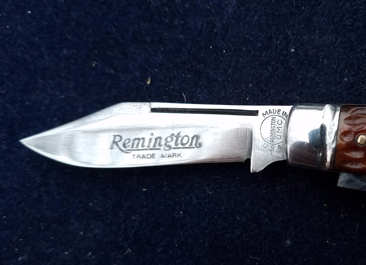

FRJ wrote:Good informative post, Wayne.
Fake or not, that's a good looking knife, Joe. I'm curious if the word "Fake" was etched on the tang stamp before you bought it or did you add it after discovering it was actually a fake?
I would also like to point out that unless you're a stickler for accuracy (as most collectors obviously are), the technology today makes it possible to reproduce/counterfeit knives that in some cases are actually better than the originals they copied or at least as good as the originals in terms of quality of materials, fit & finish, etc., but the fakes are newer and free of the issues that naturally occur as a result of age. I have held both a genuine Lone Wolf Paul and a counterfeit of the same model and, to be perfectly honest, if I hadn't known which was which, I would not have been able to distinguish the real one from the fake one.
~Q~
~Q~

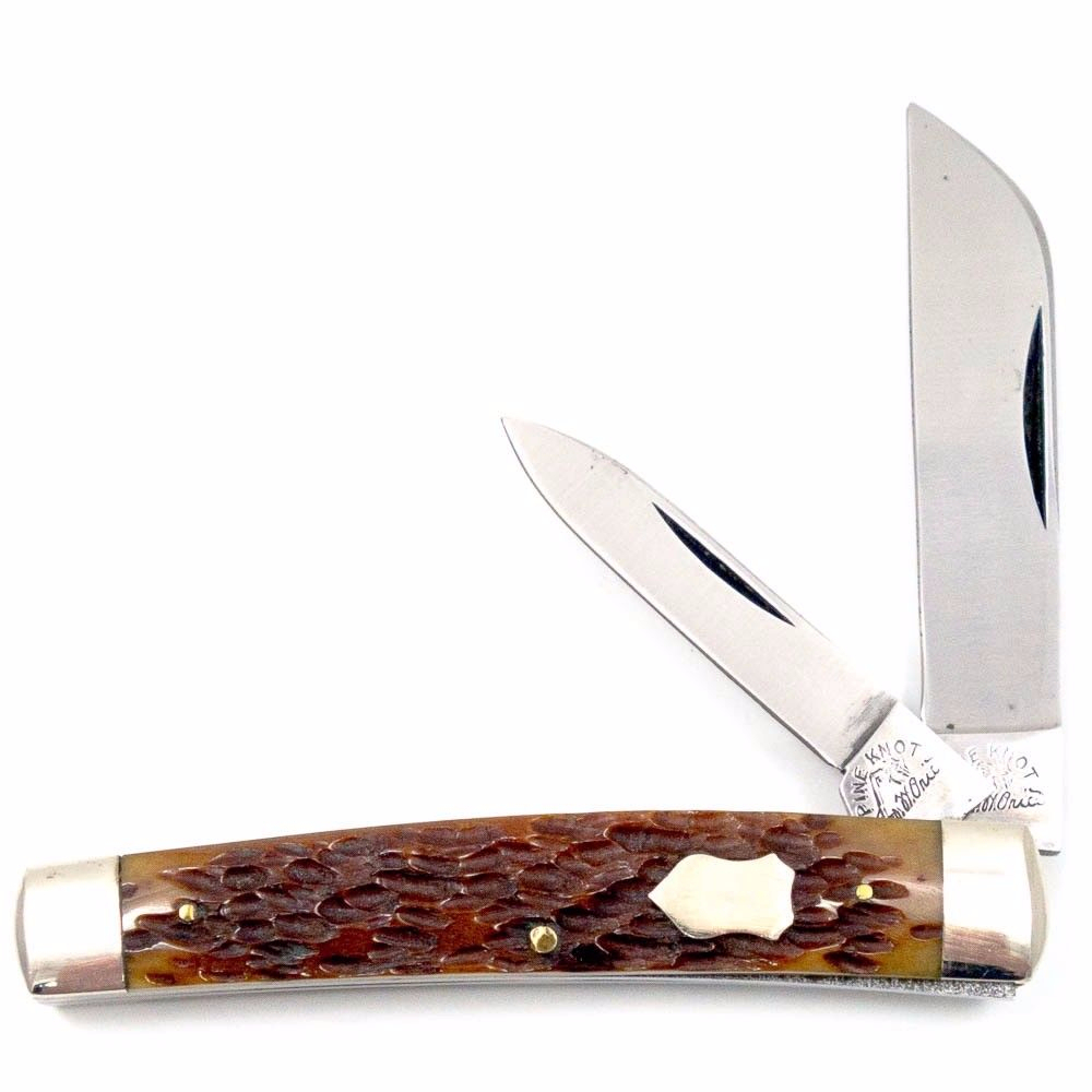

Another observation...I just noticed that the eBay listing for the Pine Knot Congress Jack (last photo in OP) clearly states in the seller's description that the knife is a "parts knife assembled in the 1980s from old parts; 1930s parts, 1980s assembly." So, I'm wondering if that actually qualifies it as a counterfeit or a "fake" since, technically, it is composed of original parts from the 1930s, but it was assembled many years later. Apparently, there are many factors involved in declaring a knife to be counterfeit, one of which is the seller's intent when offering it for sale. I do not feel this seller was attempting to deceive anyone about the nature of this particular knife, in fact he was clearly trying to present it as honestly as he could based on his own personal knowledge. But, suppose he hadn't known the details about the origin of the knife and was simply selling a knife he picked up at an estate sale or flea market or pawn shop...would his ignorance about the provenance constitute deception when he put it up for sale? And, given that the knife is composed of genuine, original parts, does the year it was assembled make such a significant difference that the knife should be considered a counterfeit?
~Q~
Here's the original eBay listing:
https://www.ebay.com/itm/Vintage-BELKNA ... true&rt=nc
~Q~

QTCut5 wrote:Another observation...I just noticed that the eBay listing for the Pine Knot Congress Jack (last photo in OP) clearly states in the seller's description that the knife is a "parts knife assembled in the 1980s from old parts; 1930s parts, 1980s assembly." So, I'm wondering if that actually qualifies it as a counterfeit or a "fake" since, technically, it is composed of original parts from the 1930s, but it was assembled many years later. Apparently, there are many factors involved in declaring a knife to be counterfeit, one of which is the seller's intent when offering it for sale. I do not feel this seller was attempting to deceive anyone about the nature of this particular knife, in fact he was clearly trying to present it as honestly as he could based on his own personal knowledge. But, suppose he hadn't known the details about the origin of the knife and was simply selling a knife he picked up at an estate sale or flea market or pawn shop...would his ignorance about the provenance constitute deception when he put it up for sale? And, given that the knife is composed of genuine, original parts, does the year it was assembled make such a significant difference that the knife should be considered a counterfeit?
~Q~
There is another thread discussing this knife. As peanut740 commented, the blades are not from the 30's, see first comment following the OP in the thread below. The knife is fake (counterfeit) because the blades and tang stamps are not original Pine Knot blades and stamps.
viewtopic.php?f=17&t=54509

Consider this experience I had a couple of years ago (July, 2015):
I had just purchased what I believed to be a major score for my collection. So excited and thrilled was I with my "ultra rare" new acquisition, I wasted no time posting photos of it on AAPK so other knife aficionados could share in my joy. No sooner had I done so, however, than all the happiness was sucked right out of me as one member after another began informing me that my pride and joy was actually a fake. I felt as if a load of bricks had been dropped on my head; I was crestfallen. Now, as you can see, there's absolutely nothing wrong per se with the knife itself, in fact, it's quite a beautiful piece that would have looked great in my black pearl collection. But, once I found out it was counterfeit, for some reason that was sufficient to totally kill the allure; the 'magic' was gone; I couldn't even look at it without feeling sick to my stomach. I felt cheated, tricked, lied to, duped and made a fool of; my trust had been violated. Long story short, I returned the knife and got a full refund (thanks, tommygg101! He may be a dishonest, low-life, pond-scum knife seller, but, for whatever it's worth, at least he does give no-questions-asked refunds, I'll say that much for him). But, here's the funny thing that I learned after all was said and done: Had I never discovered that the knife was a fake, I would still have it in my collection today and I would very likely still feel joy and happiness every time I looked at it; a perfect example of the saying, "Ignorance is bliss" as ever there was. Another thing, I might have kept the knife anyway, even knowing it was a fake had I not paid top dollar for it...I mean, it was an attractive knife, forgery notwithstanding. So what's the lesson in all this? Perhaps not all counterfeit knives are intrinsically "bad", and, in some instances, it's simply the knowledge that a knife is a forgery that ruins it (at least from a collector's viewpoint).
~Q~
~Q~

As to your last post, the same thing happened to me upon buying the congress jack that I posted. A real let down.
I scrawled the word "fake" on the tang. I wouldn't knowingly buy a fake knife.
I kept the knife because it is a lesson learned and I liked the representation of the pattern and also it could be a useful knife.
I have carried it briefly. I don't hold it in high esteem. I always find my self wincing when I see it.

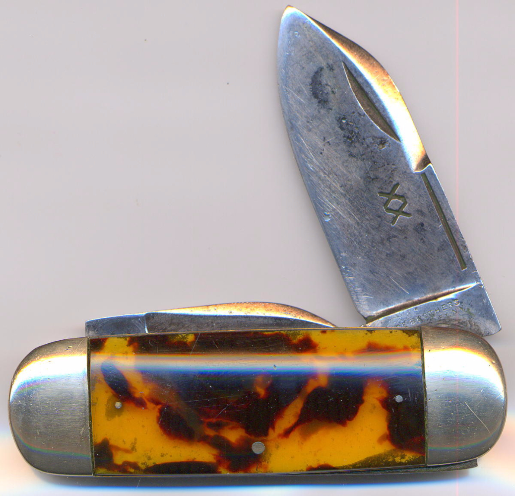

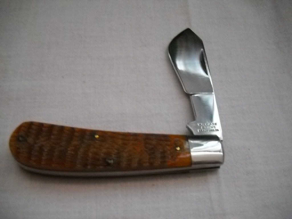

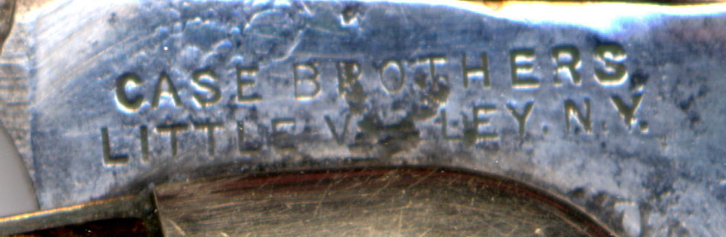

Where is myrtlefaye when you need him ? Guess which one is not a fake, there is only one. I believe that all of the fakes were made by the samew person and the bone work is excellent. getting bine to look old is an art form in itself. pearl, ebony and celluloid are easier.
Russell
Russell
Catt
Catt
Cont
Cont
Crown
Crown
Thanks, DC
espn77
Posts: 3576
Re: Patterns that are Commonly Counterfeited
Post by espn77 »
I'm going to guess the continental or Miller bros, but since I can only pick one. Continental???
peanut740
Posts: 8127
Post by peanut740 »
The Case Brothers toenail is the only non fake stamp.
