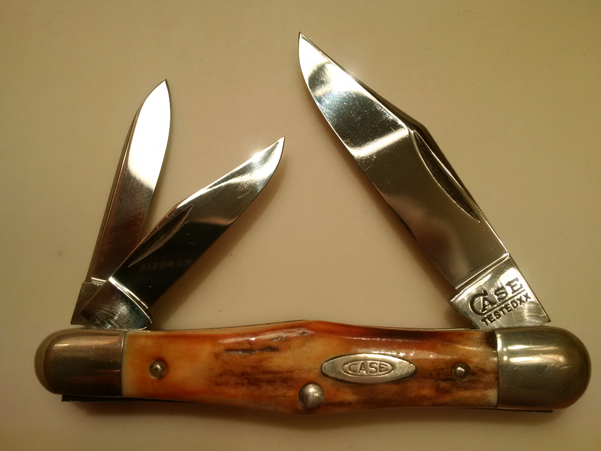

Case 5383 whittlers are also counterfeited often. Maybe I'm just more attuned to them from having been burned myself.
But I see a lot of these on eBay with the same thick sambar stag wrong for Tested era, and wrong shield (from 1970s dotted era). Master blade tang shaved down and re-stamped.

I agree with your assessment Joe. Why anyone would condone fraud escapes me. If one is enamored of dishonest people, go hang out at the local jail. Fraud is theft. Plain and simple.
Q's experience and yours is the same as mine. I purchased the whittler posted above in the early 1970s at a NKCDA show in Arlington, TX from a well known Tennessee knife dealer. I was young and naive, unaware that anyone would counterfeit a knife. I was very proud of it and made it the centerpiece of my growing whittler collection. Until several years later at a Mesquite, TX show when I showed the knife to Jim Sargent and Tony Foster, who gently told me it was a forgery and why. I told them (as if that was a justification for it's authenticity) who sold it to me. Their only comment was "not surprised" as they exchanged knowing looks between them.
Seems I am far from the only collector to be taken by that seller. (He's no longer with us so I see no point to naming him here). Quite a blow and a horrible feeling that put me off of knife collecting for a long while. Which is why I detest counterfeiters so much.
They damage our hobby. They are thieves!
It's a beautiful knife. It's also a forgery. And a reminder to be wary, and not to let my impulse to obtain a treasure outweigh my skepticism and knowledge. I've occassionaly thought about carrying it but I still get that sinking knot in my gut when I see it so can't bring myself to looking at it daily. But I can use it to help educate others. If you don't know for sure what you're buying don't spend big bucks to get it!

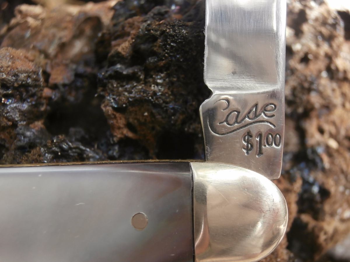

Where is myrtlefaye when you need him ? Guess which one is not a fake, there is only one. I believe that all of the fakes were made by the samew person and the bone work is excellent. getting bine to look old is an art form in itself. pearl, ebony and celluloid are easier.
Thanks, DC
- espn77
- Posts: 3576
- Joined: Sat Mar 05, 2016 4:01 pm
- Location: South west Kansas by way of Texas
Re: Patterns that are Commonly Counterfeited
I'm going to guess the continental or Miller bros, but since I can only pick one. Continental???
- peanut740
- Posts: 8127
The Case Brothers toenail is the only non fake stamp.
