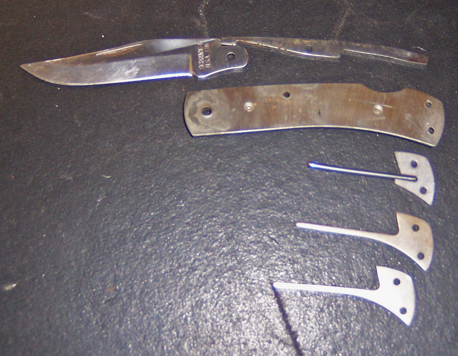

Here is a pic of the 2 types of spring systems that MM was speaking of.
These are from an LB5, & are just smaller than the LB7 parts, but the same system.
The lower 2 springs are the one-piece type, it requires 2 springs side by side.
MM is right… these are a PAIN! They tend to break and are nearly impossible to find.
The upper spring & keeper type can be made.
The keeper from nickel silver, stainless, or whatever, the spring is made of spring steel.
Jantz (and I am sure others) carry spring steel in 3 different sizes that can be cut to the proper length to replace the broken spring.
Really it is a pretty easy fix & much cheaper than buying a new knife.
Hope this helps,
Hope this helps,
