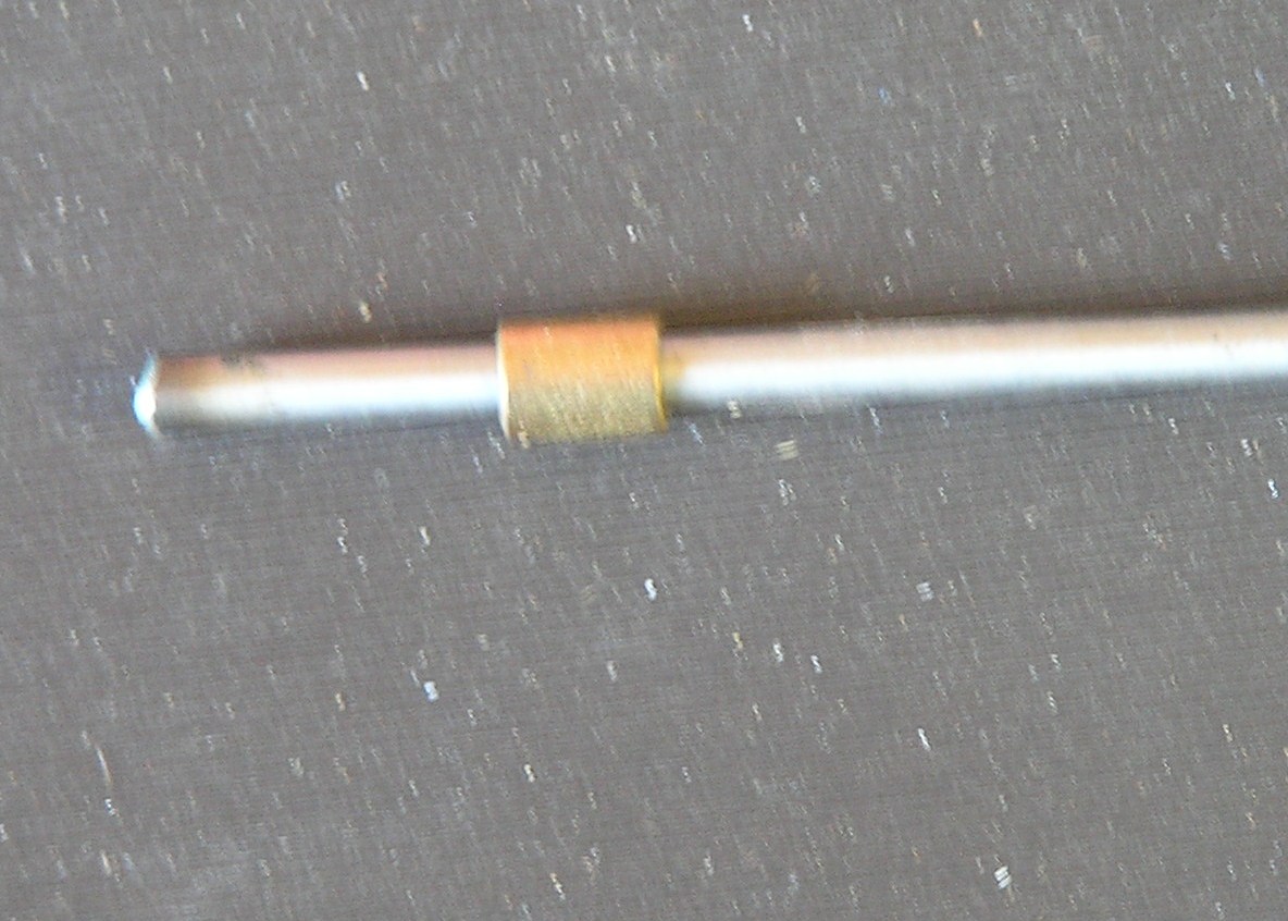

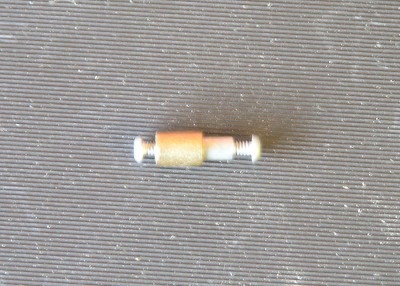

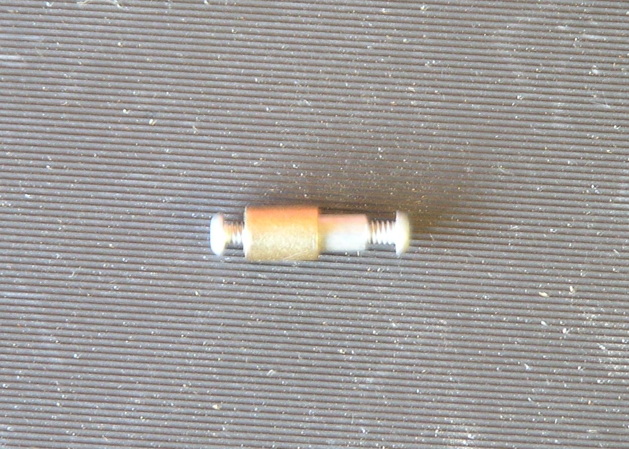

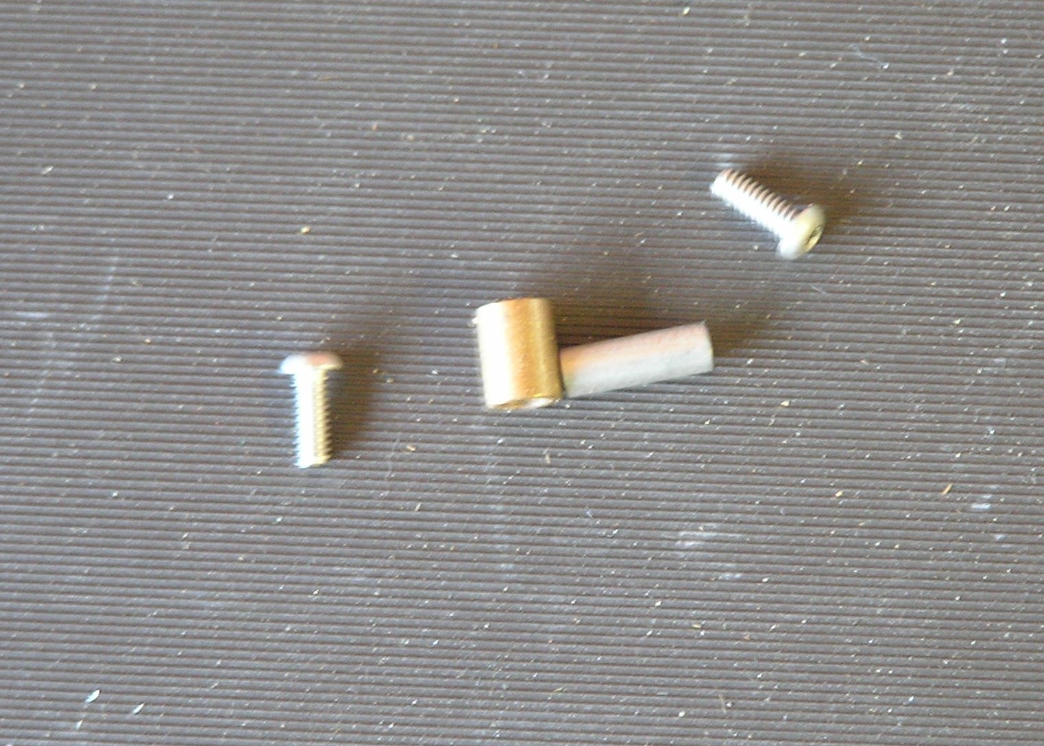

Anything like these pictures, the bronze phosphorous part?
The pivot pin and the bushing will both need to be ground down to size. Bushing will be the thickness of the blade + 2 washers .o15 thick and .188 ID so they can slide over the nushing.
Pivot pin also needs to be ground down. Both must be FLAT 90 degrees the length.
They are precision parts and measure exactly what they say they do. The blade rides on the bushing for a real smooth action.
