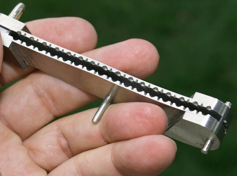

Took your advice and "went to the shed" What a hell of a job. I worked my wrinkled old buns off and only got halfway there. I earlier said I thought it would be a tough job and not as easy as it looked. Boy, was that an understatement!! I got to take some time off to think about this project before I ruin what I've got so far. Thanks again for the inspiration, I'm enjoying every minute of this )(*&^)*&^(&^%(&^ project.
mike

pmike5869
Posts: 219
Joined: Mon Dec 17, 2007 2:44 pm
Location: Indianapolis, In
Re: A couple more
Post by pmike5869 »
Here's what I've got so far
love to learn, live to learn

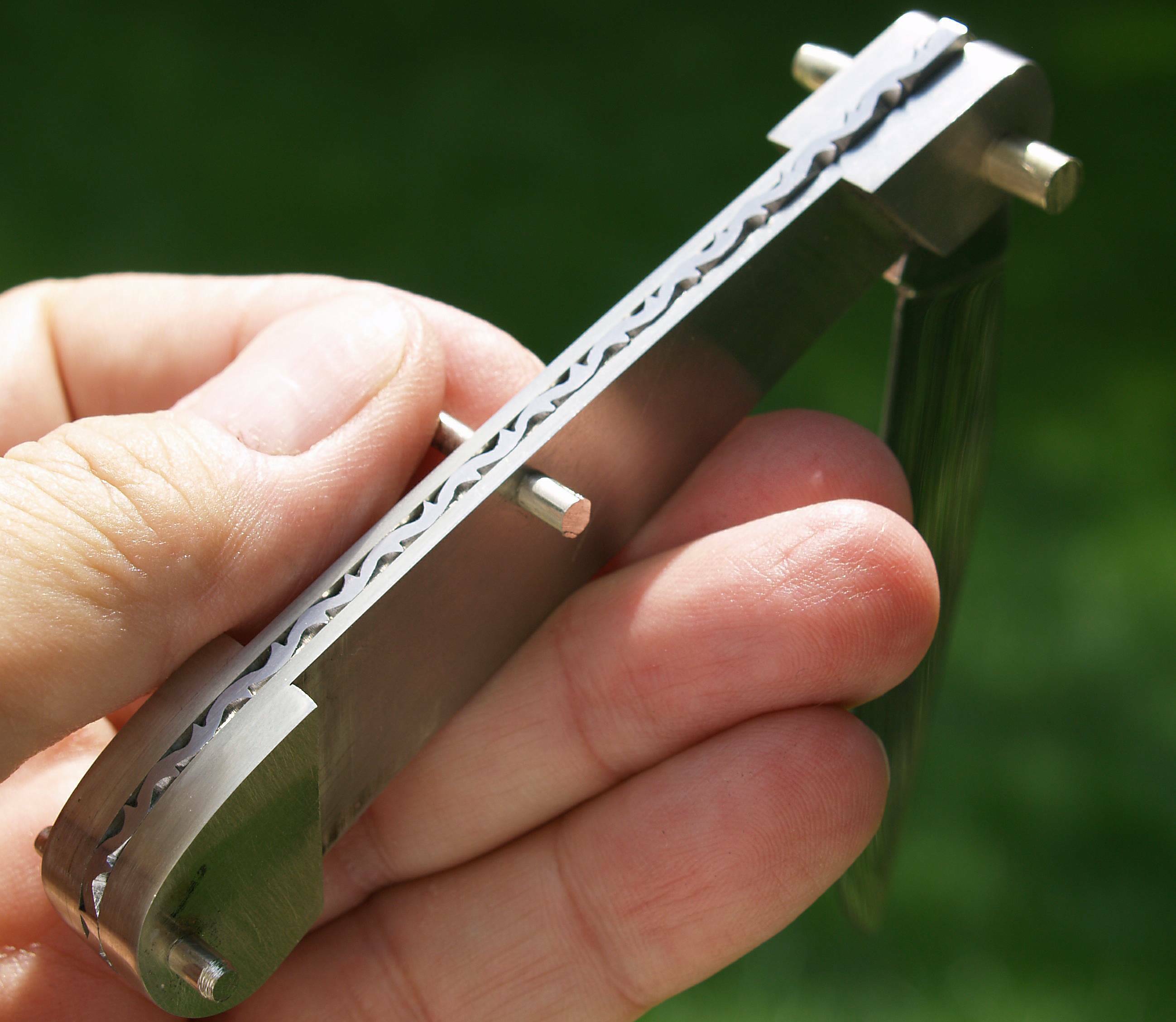

Your file work look good Mike, the spacing looks very good and that will make or break file work. My only suggestion to you would be (and it's more of an opinion) to space your vine out so it flows better and wont look so cramped. Like I said though, it's more of an opinion than anything, and we all know what opinions are like... They're like... Well, their like noses, everyone has one and they all smell :wink:
Here is a pic of some vine work I did.

Thx for the advice. The difference between an amateur and a pro. Yours looks 10 times better and I see your point. Your's is so delicate and artistic! Wish I paid more attention to the things that count. Never thought such a small thing could make such a big diifference. This is only my 5th try at file work and I feel like I've already learned so much but the more I learn and try the more I find ways to improve. Timed my attempt at this filework and I did it in 50 mins. I will take more time and no doubt improve with your suggestion. Thx 1k times

pmike5869 wrote: The difference between an amateur and a pro.
Hold on Brother, I'm a wanna be, but I do look at things a little different I guess, because I like to see things flow on a knife, to me it has to look like it belongs there thats all. I spend more time planning file work and finding good start and stop points and laying it out than I actually do filing the work.

Flow is important and the bottom of my knife as it is, is the ugliest filework (really bad flow) I've ever seen. But, I live and I learn. I'll never do that style again and I have adequate proof of why. I like to experiment and sometimes "the bear gets you". The good thing is I don't have a market or a customer and my boss (me) lets me screw up whenever I want to, which I do regularly. Maybe I learn more from recovery from these disasters than if everything goes right. This whole project, making the liners and bolsters, was a stretch for me and I've learned a heck of a lot. Now I wish my grandson had some interest so I could pass the knowledge on but he has no interest in this stuff. Thx again, your work is sincerely admired and your advice is greatly appreciated
