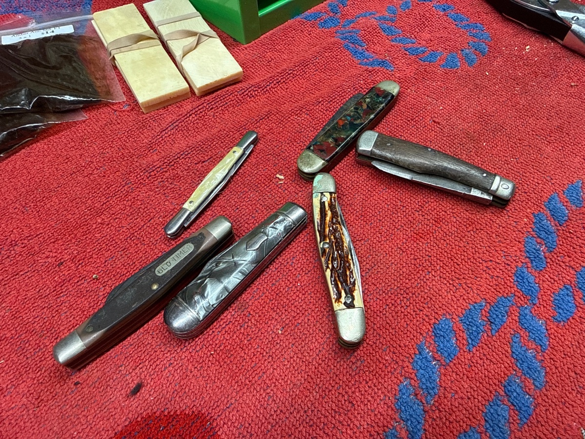

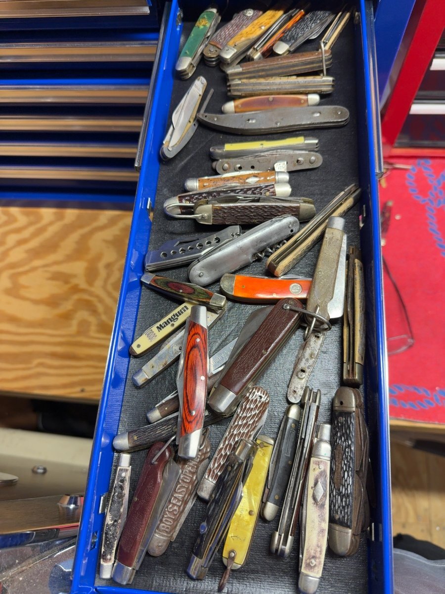

I've gotten fairly good at knife and blade cleanup and polishing. I'm ready to try my hand at this pile of junk knives and try to do some handle replacements before even trying swapping or replacing blades (I'm calling that level 3). Been watching YT vids, reading, and chatting with folks on YT that make it look stupid easy. My shop is pretty well stocked with most of what I think I'll need, pretty handy with my hands to boot.

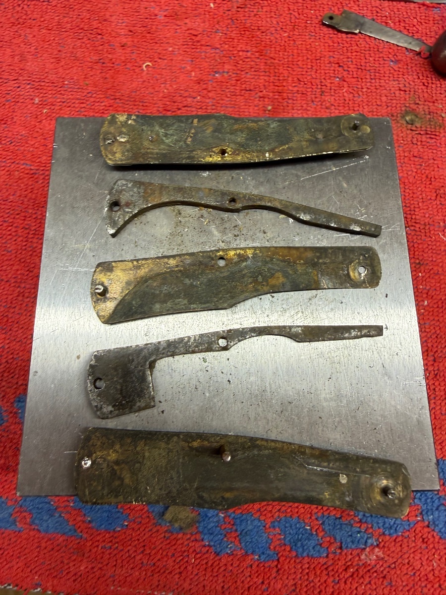

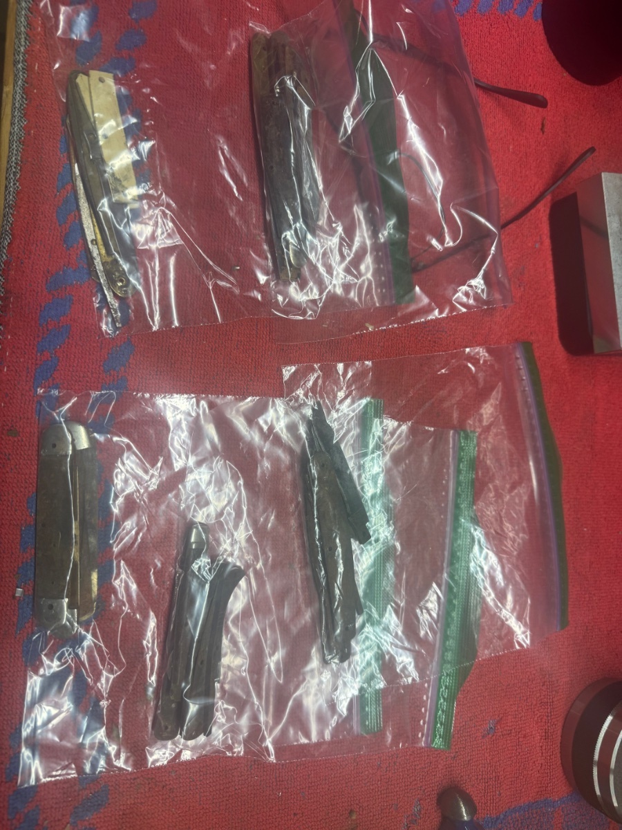

I did some practice today on some thrift store finds, using the utility blade method I was able to disassemble 5 knives and get them bagged up for eventual reassembly. Only ended up with one hiccup, 2 pinned boosted also popped out so I’ll have to tackle that at some point. I think I’m going to start with some wood handles before trying the bone that I have, just waiting on some pin stock to arrive.
Paul
