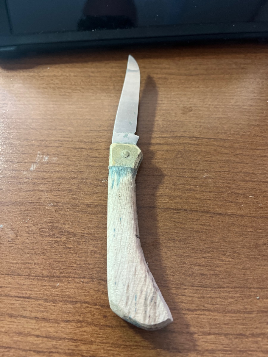

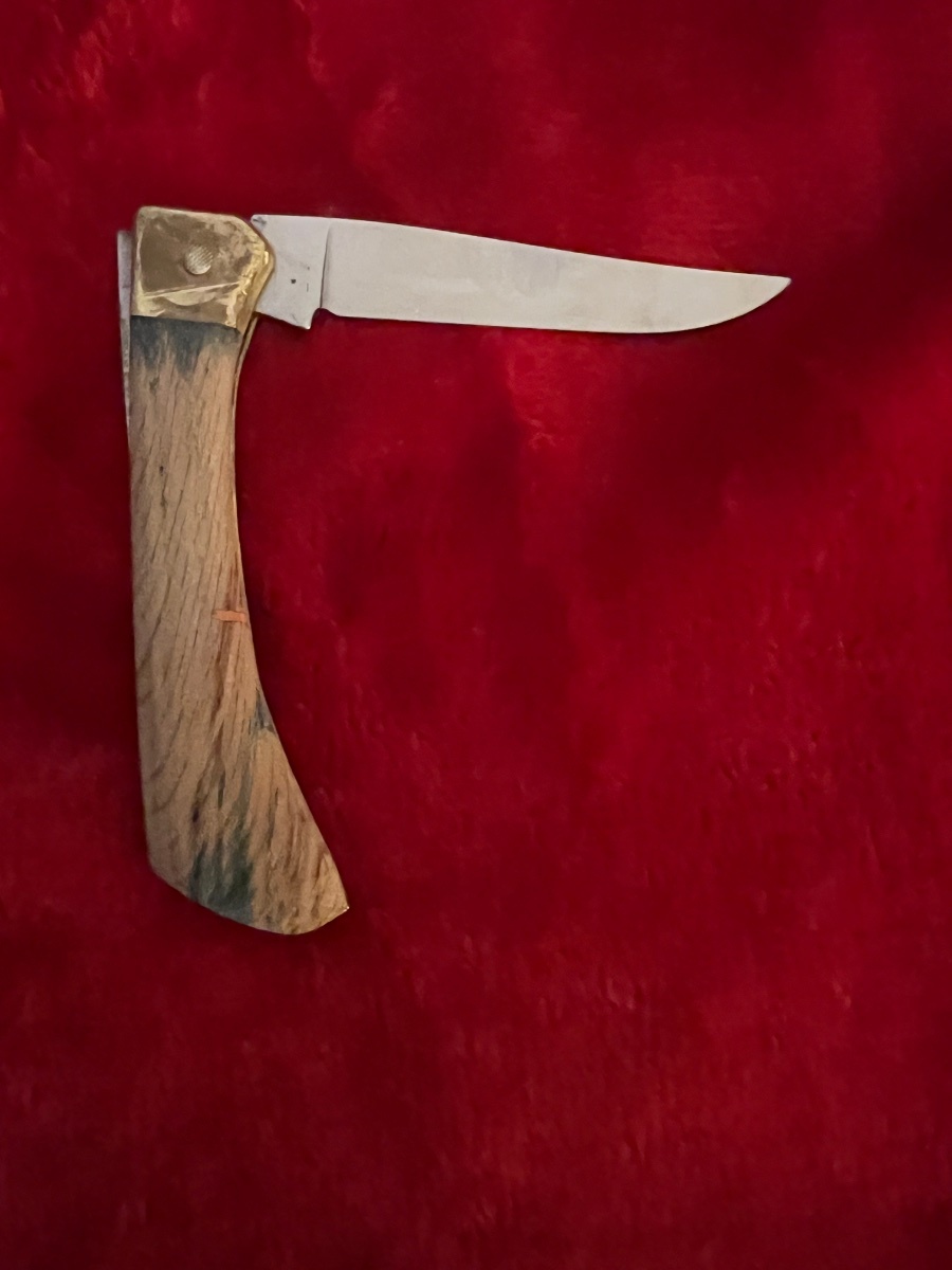

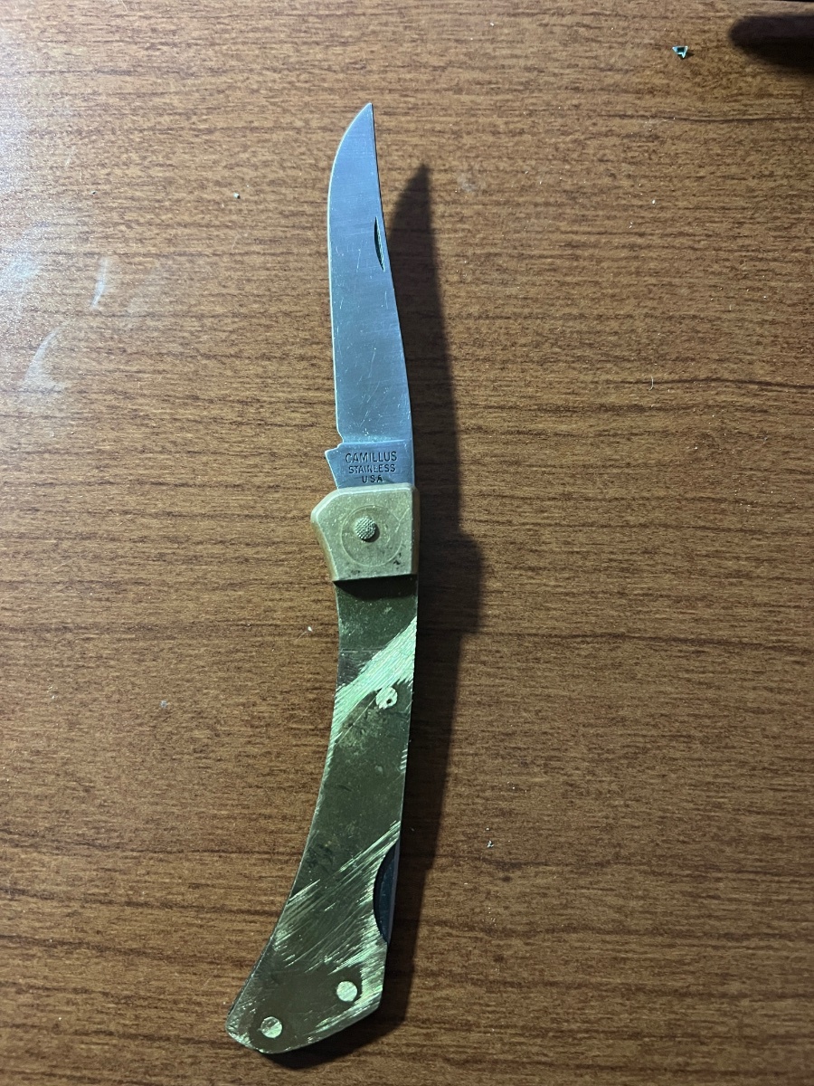

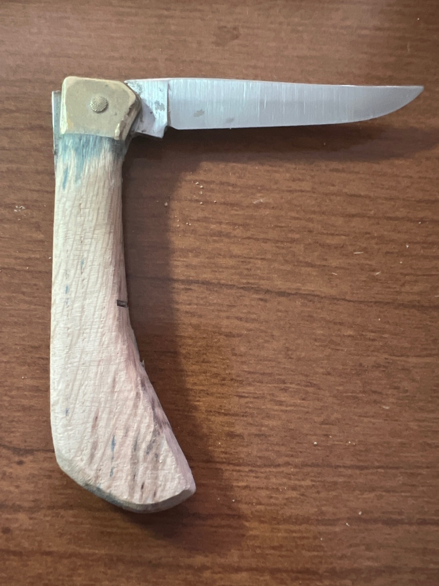

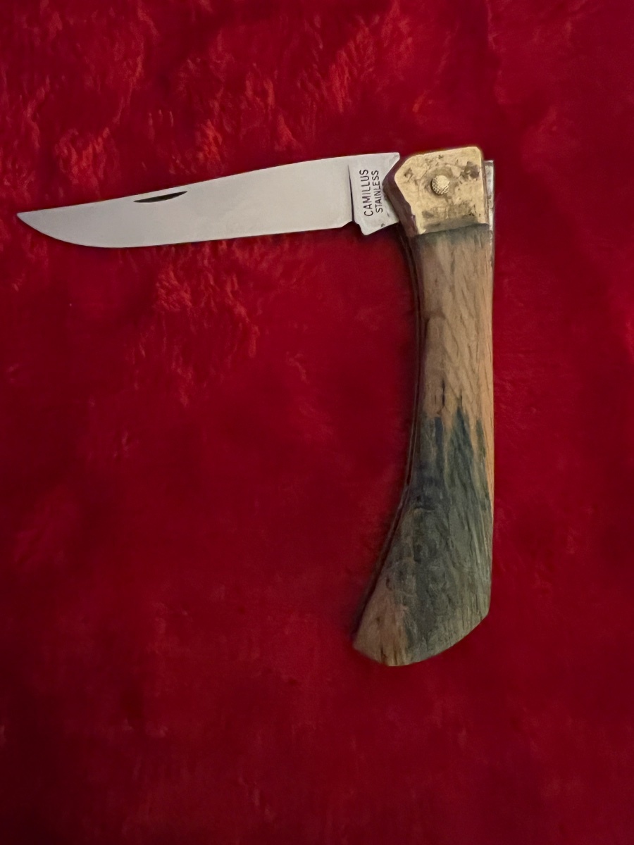

The knife looks like it was unfinished from the factory, possibly purchased during the bankruptcy sale.

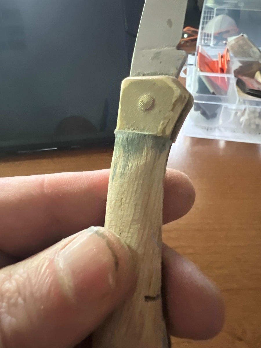

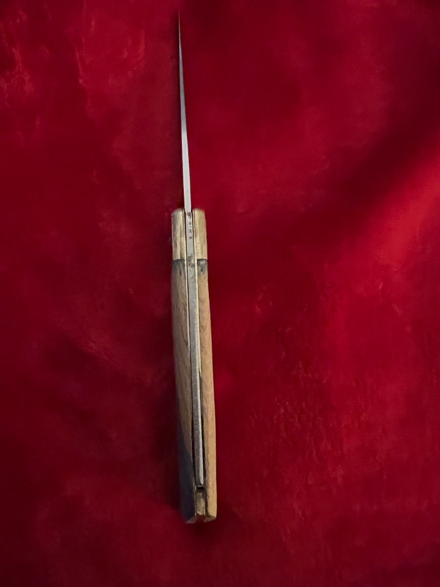

Those handles look good on it! I would sand the bolster smooth, and file down the kick until the blade sits all of the way into the blade well. I have had several other unfinished factory knives (other brands), and those steps seem to be commonly needed.
What is the closed length of the knife? That will help in identifying the model number.
The closed length of the knife is 4 1/8”.

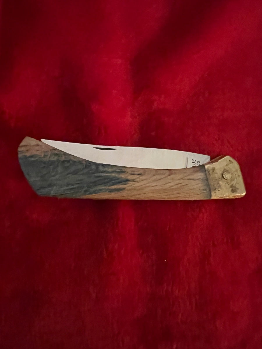

Yes, I believe it was a bankruptcy knife, I bought a dozen Colonial, Barlow branded small lockbacks the same way off eBay a few weeks ago. Yes, going to file down the exposed pins and mirror the brass, file the kick to lay down the blade in the well, not sure if anyone noticed, but I still have to shave down the wood at the lock well, final sand and I’m thinking Birchwood-Casey Tru-oil will those scales come to life and beautiful. Depending on how the wood absorbs the coating, maybe 6-8 coats with 0000 steel wool rubs in between each coat, then a 10,000 grit wet sand after final coat, buffing wheel treatment and Birchwood-Casey stock wax after that.
