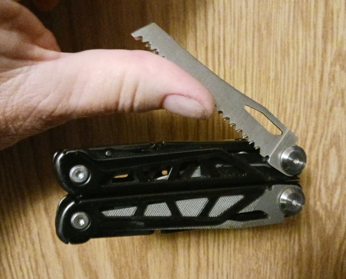

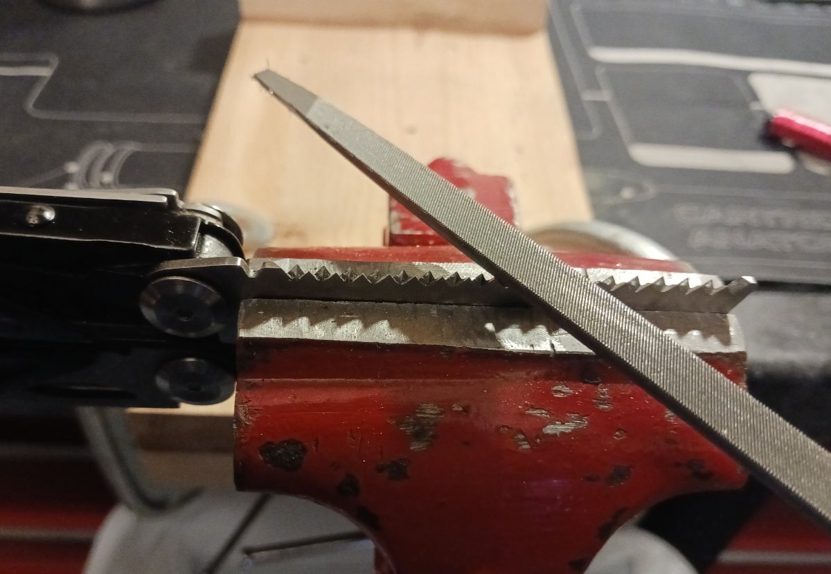

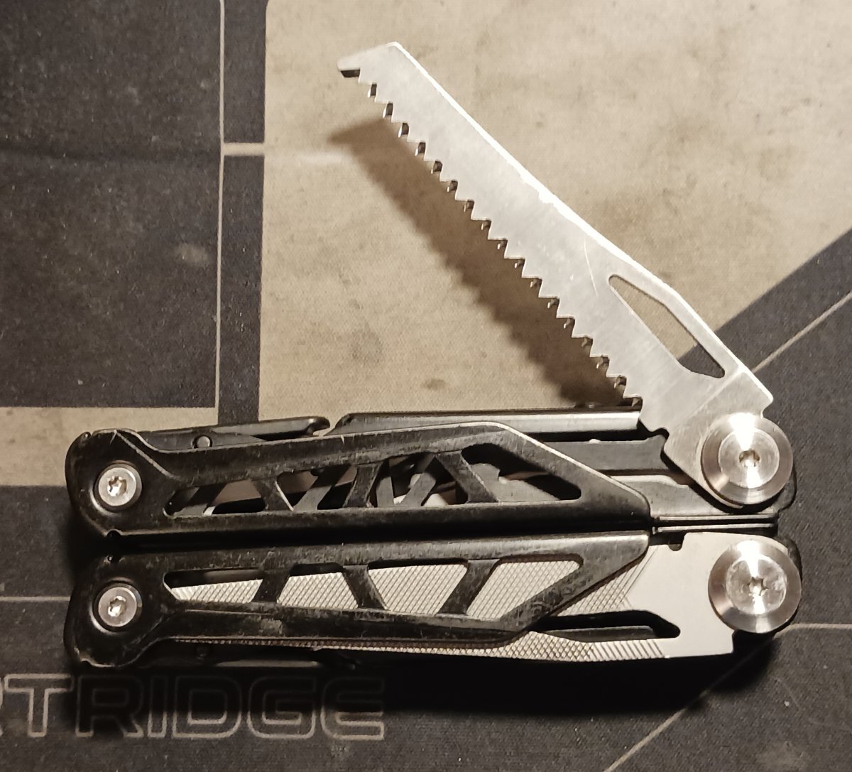

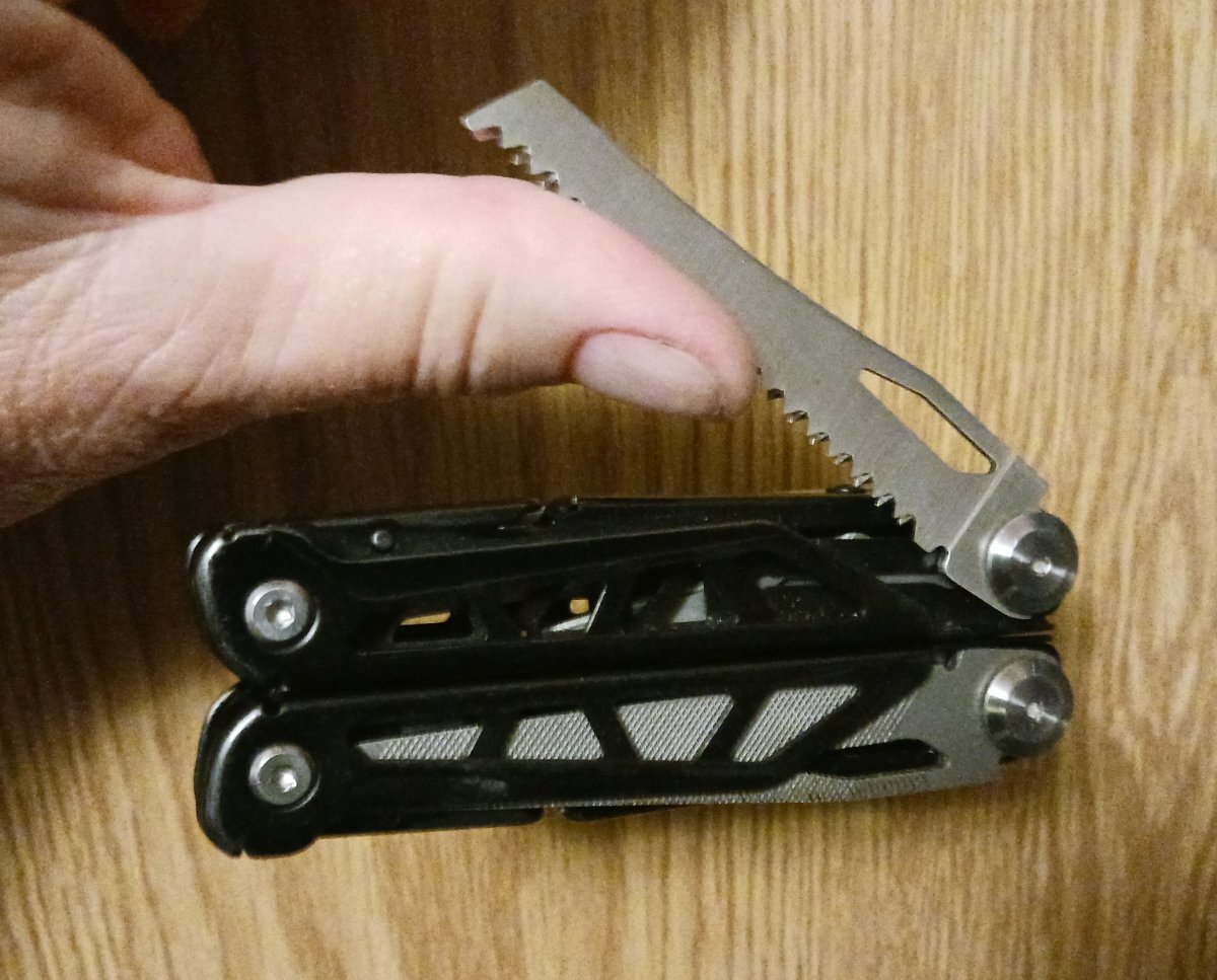

Multi tool saw blades can dull to the point of being useless. I have this A-TECH multi tool that I got from Cody in the last POS exchange. The points were somewhat blunt, so I decided to give it a try with the triangular files that I use for sharpening handsaws. Clamping it into a vise and duplicating the angle resulted in a big improvement to the saw tips with 4 strokes of the file each. I always test saw blade sharpness on multi tools by doing the vertical hang test as shown. Before the multi tool would slide off my thumb and fall to the floor. Now with the saw tips sharpened, it stays right on the thumb. I used a Nicholson ultra slim taper file.
