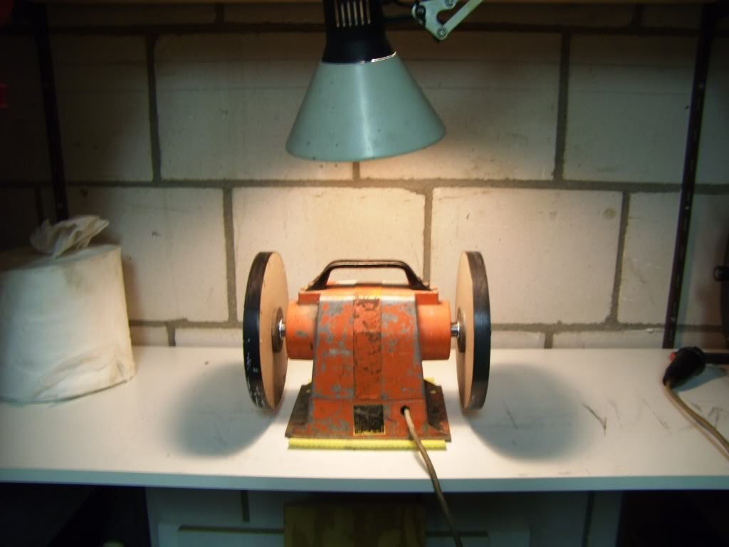

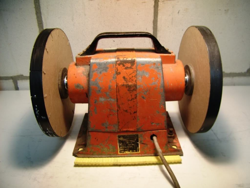

In 2009 i started sharpening knives with a set of US made Paper Wheels, bought from a German dealer, the only European source at the time.
This was my first set-up, with the Paper Wheels mounted on my old high-speed 3000 rpm Creusen bench grinder.
The sharpening Wheel is on the right in each picture, and the deburring Wheel on the left.
No guards on the machine, which is used turned around so the Wheels spin away from me.

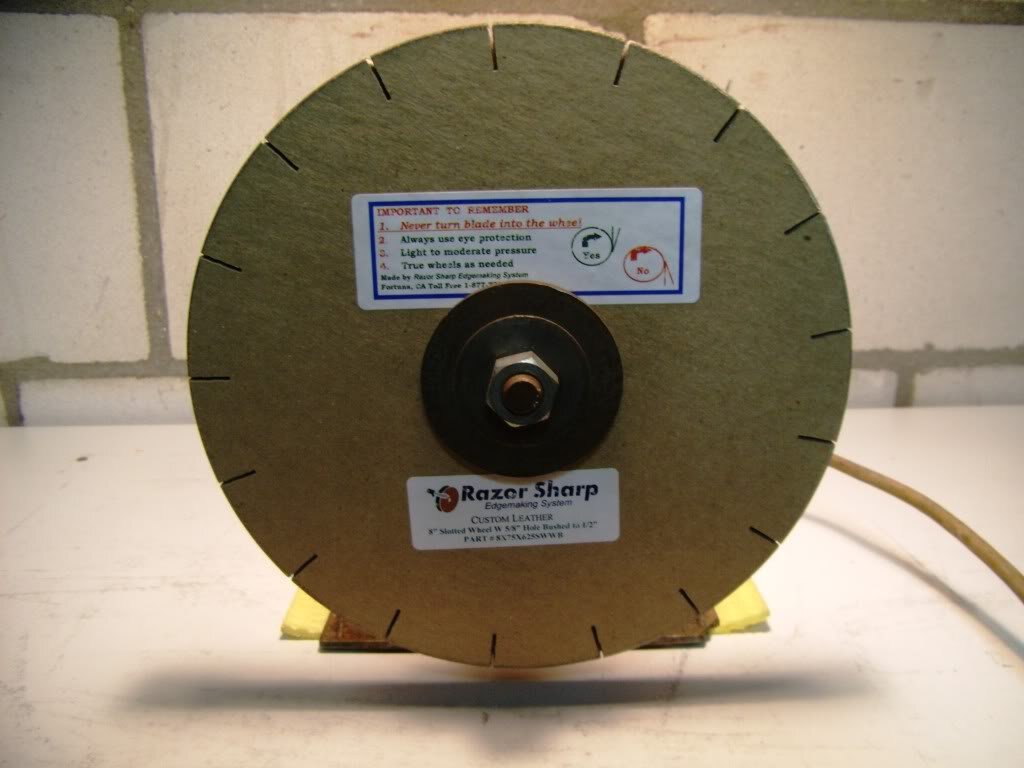

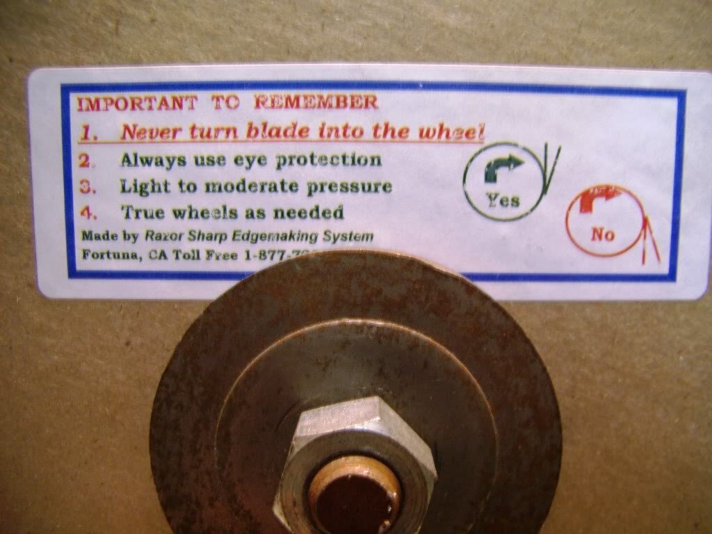

Side view of the slotted Wheel with it's warning label:

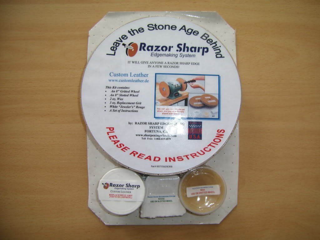

The Wheels are made from industrially compressed cardboard, and are used on an ordinary bench grinder.
A standard set consists of 2 Wheels: a sharpening Wheel with a glued-on coating of silicon carbide grit (which does the actual sharpening) plus a coating of wax on top of the grit (which protects your edges from overheating during sharpening)
The second Wheel removes the burr and/or does the polishing of the edge, for which you need to charge the Wheel surface for each knife by holding a small block of fine white aluminium oxide for one or two seconds against the spinning surface.
Instead of cooling wax this Wheel uses several slots cut in it's surface, which work like a strong fan and thus protect your edge from overheating during burr removal and/or polishing.
A few years later i also bought several "naked" Wheels from another dealer in England and charged these with various diamond compounds & powders, first to be able to sharpen ceramic knives and later various high carbide steel knives.
The combination of speed together with built-in overheating protection and overall good results is why i still use my Paper Wheels to this very day.

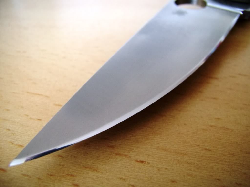

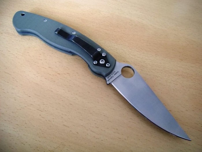

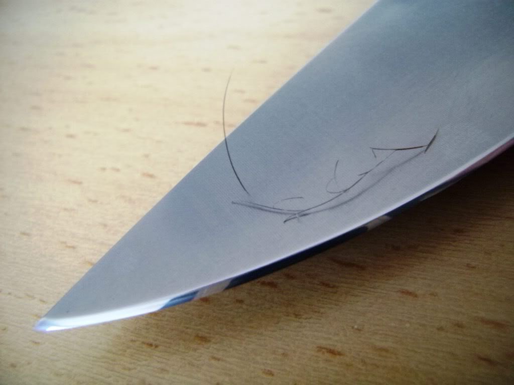

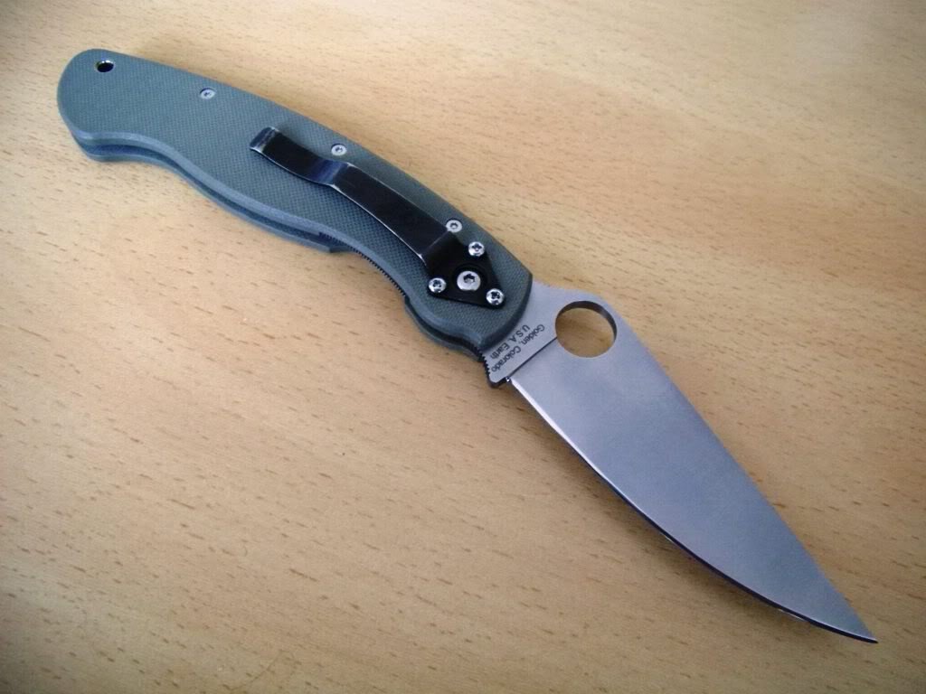

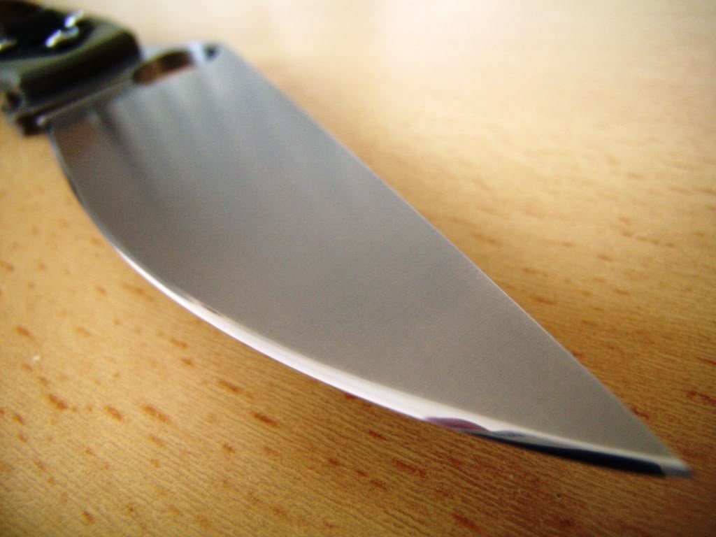

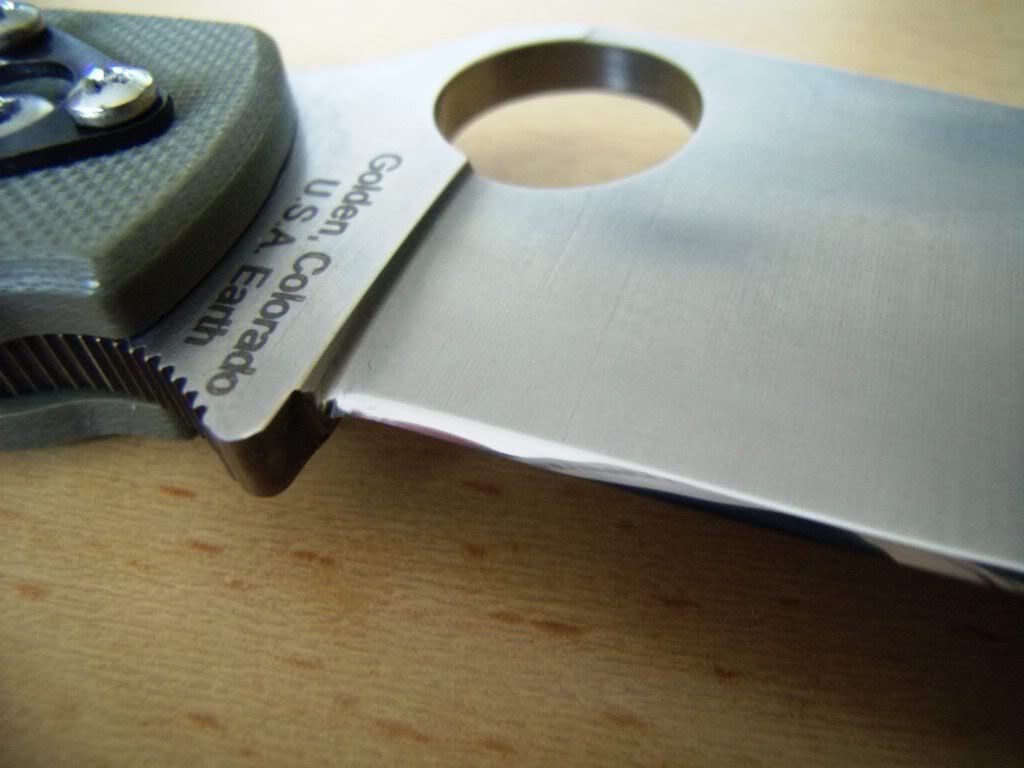

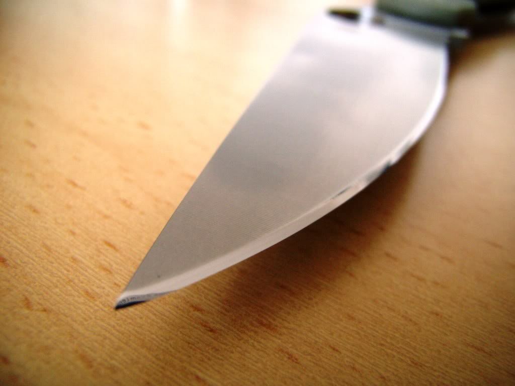

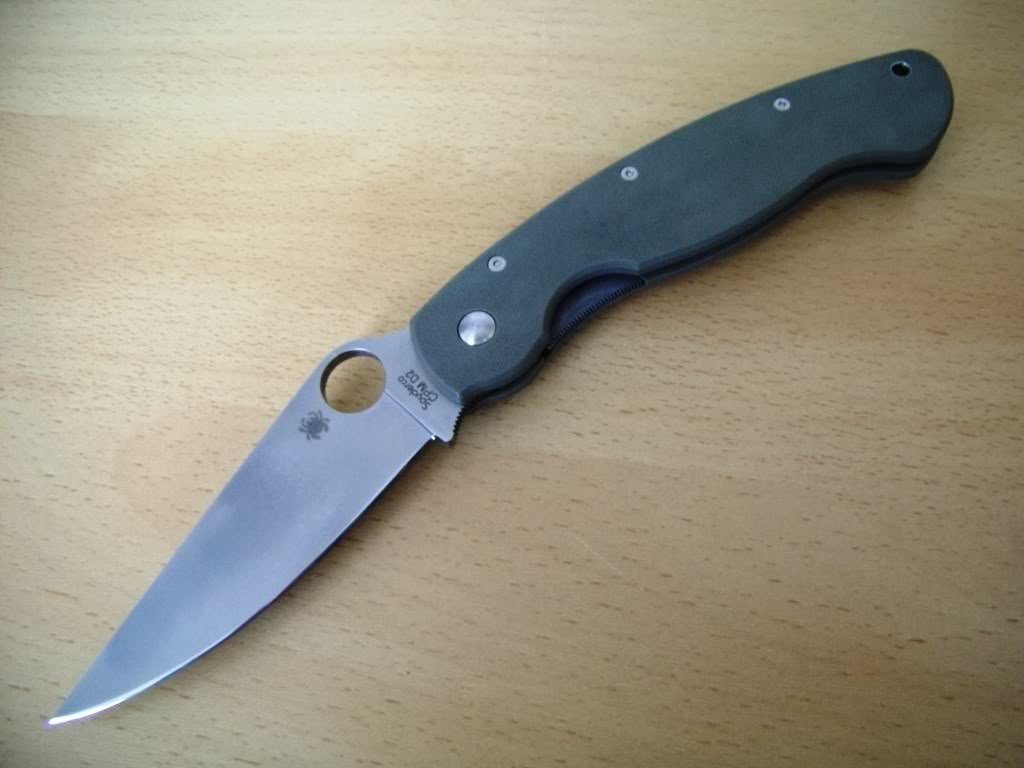

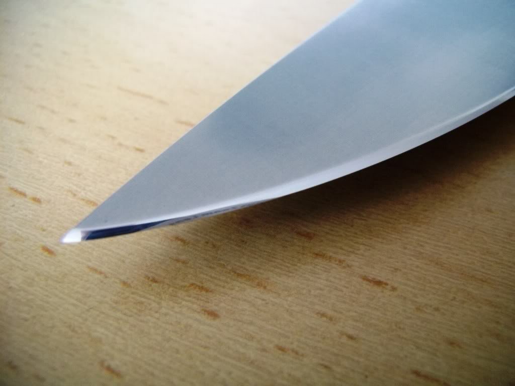

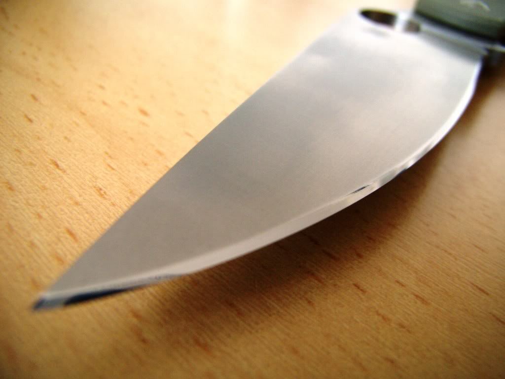

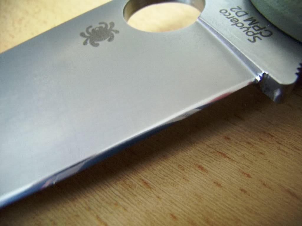

After a short learning curve practising on several cheap knives i did this second hand Spyderco Military in CPM-D2 steel, and it became one of many quality knives i sharpened on my Wheels over the years.
It had some blade play (fixed it), some discoloration on the blade (left that) and it wasn't quite sharp (fixed that with my Wheels)
The knife was part of my edc for several years.
