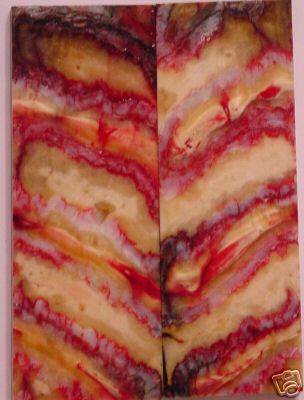

This may be a dumb question; but I'll ask anyway. I bought some mammoth tooth; that was supposed to be (stabilized).
When looking at it; I must have bent it a little, and it cracked on the bottom.
It didn't break all the way into; is there any way to save it? I want touch the red one. Thanks.

bummer. maybe if you could inject some epoxy into the crack without stressing anymore. it may have already been cracked.

I would just use some Cyanoacrylate aka ethyl-2-cyanoacrylate (CA as we should call it) or super glue of which there are many types. Some are super fast drying (don't ask how I know it dries in 5 seconds
). For this the regular old Walmart brand will work just fine. Actually you may want to flatten it between sheets of wax paper or foil and a heavy book. After flattening it -DO NOT move it and you do not need to leave the book on it usually. Once it's flat it will usually stay that way. Leave it on the wax paper or foil and slather the piece with super glue so that it gets down into all the cracks and fills them on one side. Then do the other side. Any excess can be ground off. You should be able to pick it up and you can super glue the other side also. Likely there will be foil or wax paper stuck to the tooth when you are finished. It will grind off fairly easy. I've done this a few times and it works great!
NOTE: On a break where you can see the ends, you can glue them end to end first, before coating it with CA. MAKE SURE YOU'RE DOING ALL THIS ON AS FLAT A SURFACE AS POSSIBLE IF YOU HEAR AN UGLY CRACK NOISE, DON'T WORRY, YOU'RE HERE TO FIX THAT AND IT WILL GIVE YOU AN END TO END BREAK TO GLUE TOGETHER ON A FLAT SURFACE!
This material has been stabilized and is a fossil really, so wear your respirator while sanding, grinding or buffing.
TIP: I did this with my son last summer and I don't think he cared very much until he saw that he cut one side of the tooth badly. What I did was to have him collect all the sawn off pieces and sort by color. He then crushed it to a very fine powder. It came in handy because he needed to fill some gaps. You can use CA if you are fast, but I had him use a 5 minute epoxy and mix the epoxy with the correct color of pulverized tooth dust. When he was done, you would never have known it had a big gap between bolster and tooth. he used 3 colors and I could not tell where he did the repair work.

I was ready to toss it. I didn't realize; that ivory or tooth (stabilization) was gluing and filling in. Hukk I think that I can glue it end to end, and send it to MM, for a re-handle.
