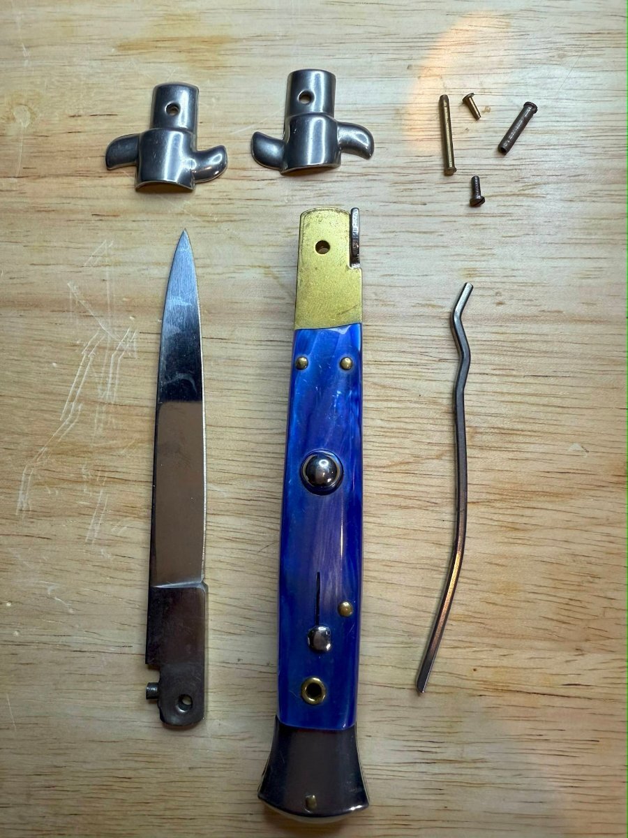

I have a 1980s vintage (I think) Model 120 switchblade kit with blue scales that I cannot assemble. Try as I may, I can't get the spring to slide into position as per the instruction sheet. I don't know if the spring is malformed, or my brain is, but I am stumped. I have no idea of the value of this kit. If anyone is interested in taking a crack at such a project, message me with an offer. I can put it in my AAPK store.

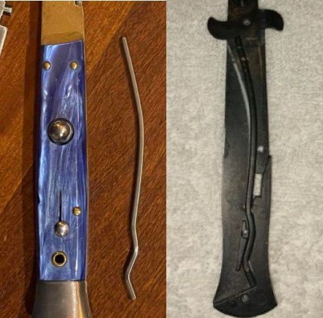

I've seen other people have difficulty installing the spring. Sometimes the spring needs a little bending or filing to get the pin through. So if someone is a little crafty, and doesn't mind a little work, they shouldn't have a problem putting it all together.
Also, I noticed awhile ago that the old EDGECO stiletto spring, and the springs from the Frank Beltrame "Switch" line, are very similar, and might be the exact same. Since both knives were sold by Frank Beltrame, that wouldn't be a surprise.
So if a person ever needed a replacement spring for their EDGECO stiletto, and couldn't find someone to sell them a loose one, they might find someone with a broken "Switch" stiletto to sell and try cannibalizing the spring. I don't doubt that there are many people with broken "Switch" knives, because they are pretty cheap and the cast zinc liners are prone to breakage.
EDGECO spring on the left, Switch spring on the right.
