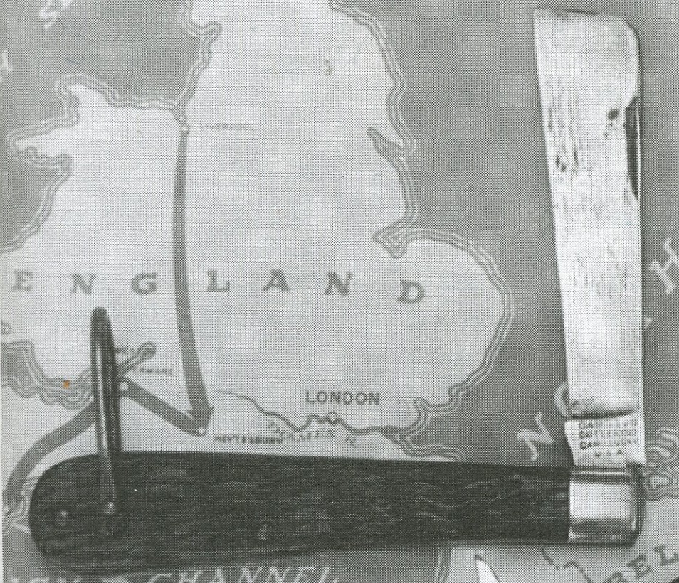

Middle war dated knives seem to bring in excellent condition, excellent prices, they will not pay for your kids or grandkids college but they are desirable to a collector. I have pasted a couple of photos from Military Knives a reference book. Camco will probably be along eventually to give the true story which ever way it falls as to whether they were manf. by camillus. Photos will be needed though.

This is a #425 pattern Sailor's knife with a sheepfoot blade and wood handles. These were made during WWII and have the 4 line Camillus stamping. Some were stamped "USCG Approved" and "1944 Q5" on the blade on the opposite side of the Camillus 4 line stamping. This knife was also made earlier in the war without the USCG stamping.
Beginning in 1949 this knife (Model #S-702) was offered but with a can-opener added. These knives have the post WWII 3 line stamping. I believe that they were also changed to stainless steel. The can-opener is the same one that was used in the MIL-K 4 blade S.S. knife that was introduced in 1949.
