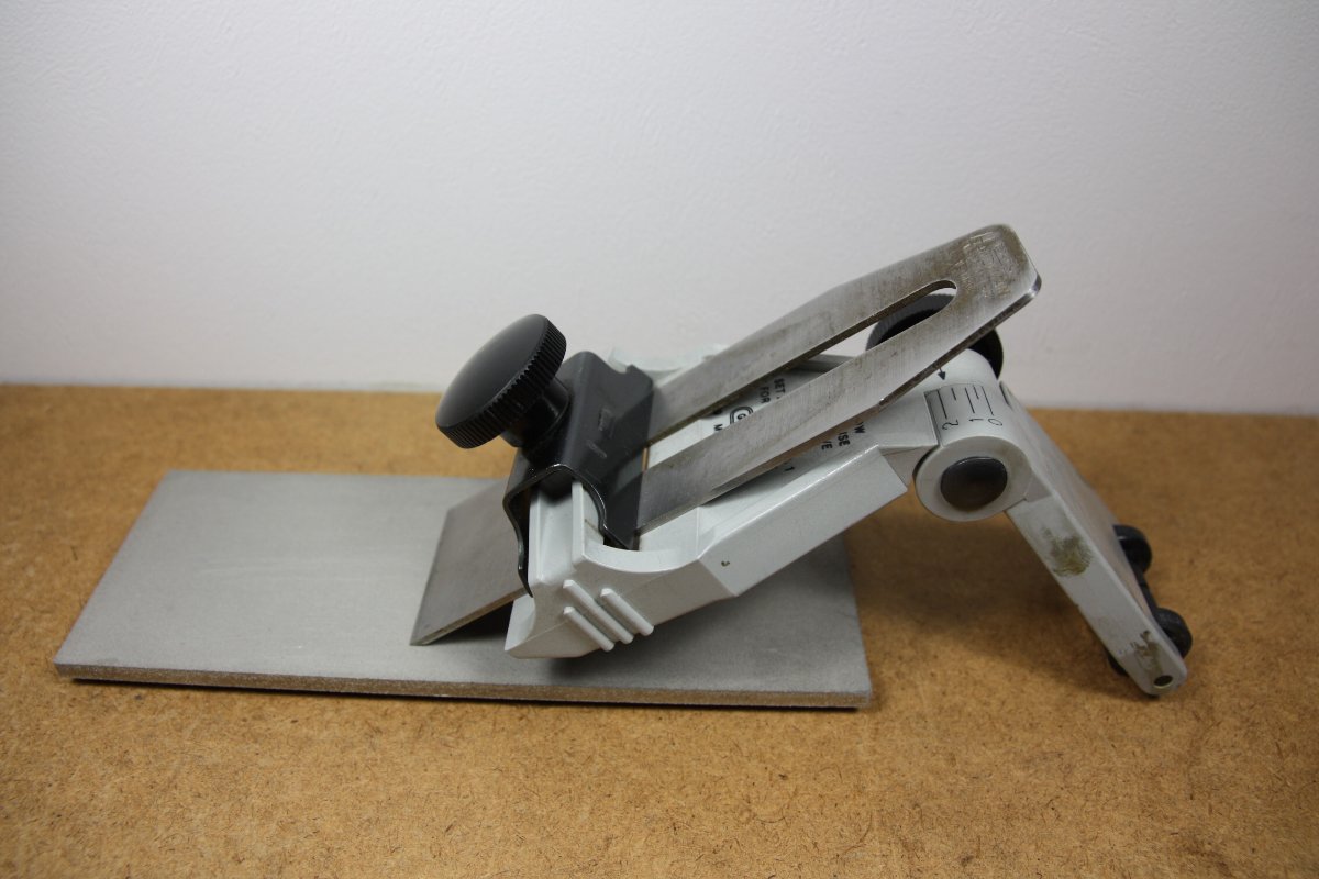

cody6268 wrote: Thu Jan 23, 2025 3:27 pm Been working on getting a few beat up planes back in working order, and all but one (a '50s Wardmastr/Montgomery Ward--which I hesitate to do much with as it's in good shape other than honing) have some pretty messed up blades. Good thing they were cheap.
In addition, I've got a bunch of wood chisels needing work, and I'm buying a few old framing chisels for upcoming projects.
So, what all do I need?
Here is what I use. A diamond plate and the General # 809 angle guide which is adjustable and will take plane irons up to 2 and 1/2 inches wide, which is what is used in my Stanley Bailey #7 corrugated jointer plane. It can be used with most types of stones as well as sandpaper lying a glass plate.
